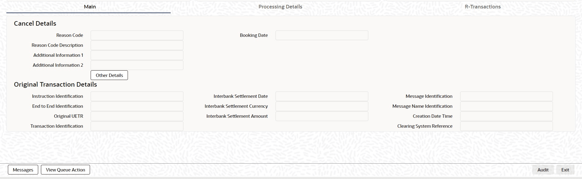

  1. From the main screen, select Main tab.
    The Main tab is displayed.
    Figure 10-10 Generic Wires ISO Inbound FI to FI Payment Cancellation Request View - Main Tab
    Description of Figure 10-10 follows
    Description of "Figure 10-10 Generic Wires ISO Inbound FI to FI Payment Cancellation Request View - Main Tab"
    For more information on fields, refer to the field description table below:

  2. To view other details of the transaction, click Other Details in the Cancel Details section. For more information, refer Other Details.
From Main tab, navigate to Processing Details or R-Transactions tab.
