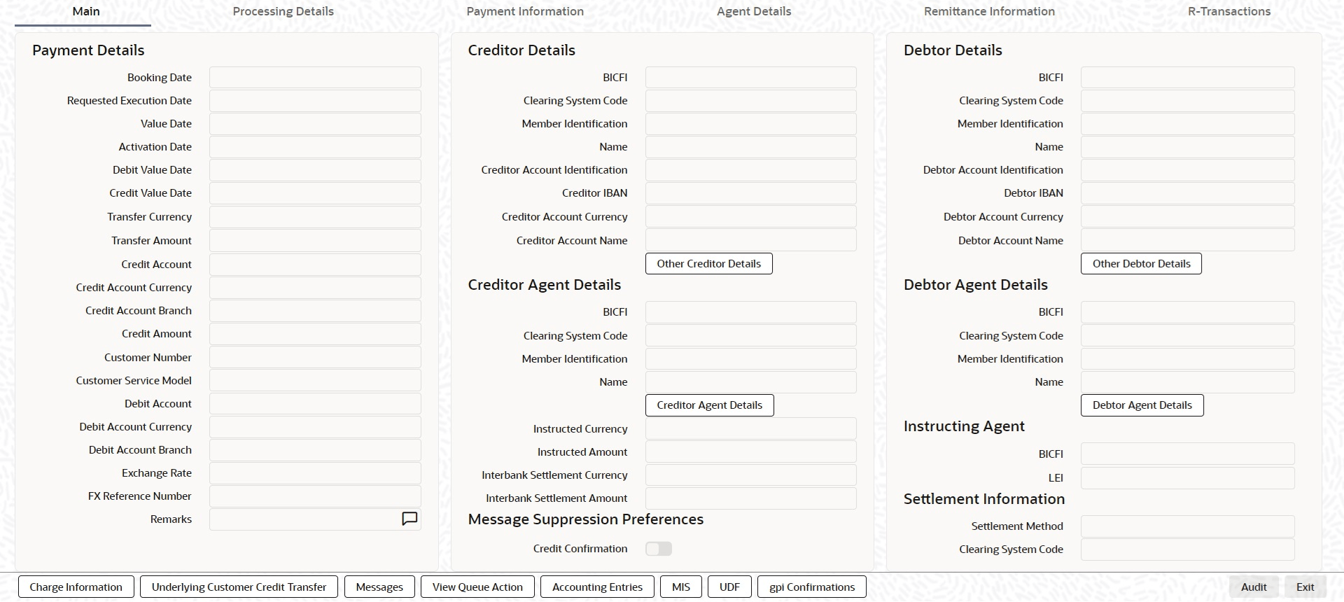

This topic explains the Main tab of the RTGS ISO FI Credit Transfer View screen.
Navigate to the main screen Process RTGS ISO FI Credit Transfer View.
  1. From the main screen, select Main tab.
    The Main details are displayed.
    Figure 5-61 RTGS ISO FI Credit Transfer View_Main tab
  2. On Main Tab, view the details. For more information on fields, refer to the field description table below:
    Table 5-73 RTGS ISO FI Credit Transfer View_Main tab - Field Description
