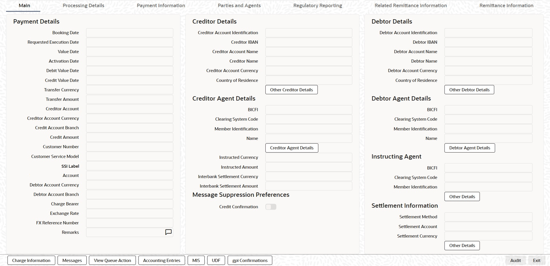

  1. From the main screen, select Main tab.
    The Main details are displayed.
    Figure 5-41 RTGS ISO FI to FI Customer Credit Transfer View - Main tab
  2. On Main Tab, view the fields. For more information on fields, refer to the field description table below:
