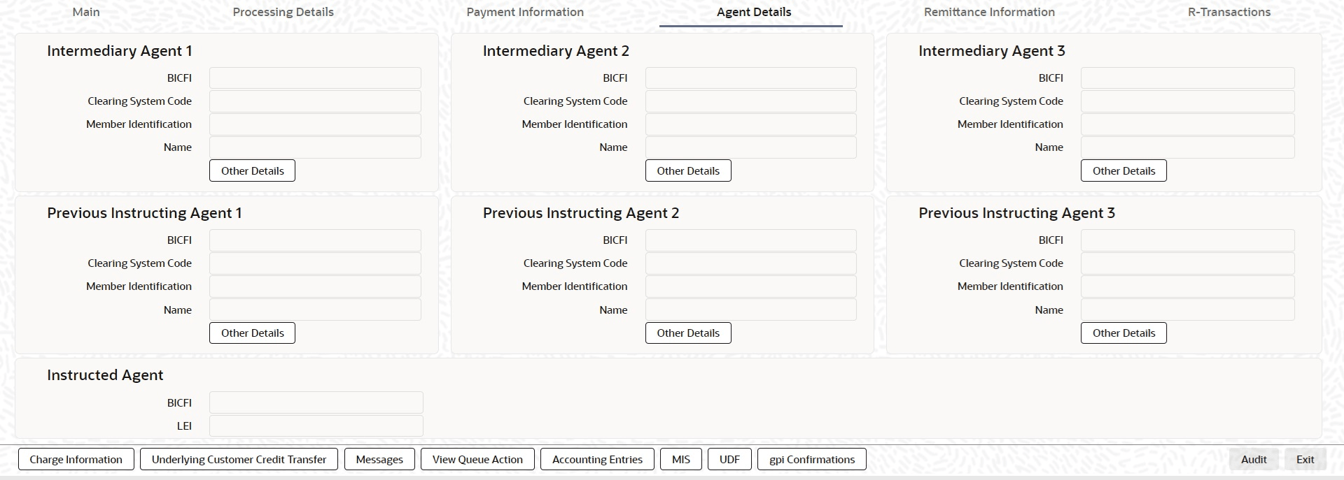

  1. From the main screen, select the Agent Details tab.
    The Agent Details tab is displayed.
    Figure 5-64 RTGS ISO FI Credit Transfer View - Agent Details Tab
    Description of Figure 5-64 follows
    Description of "Figure 5-64 RTGS ISO FI Credit Transfer View - Agent Details Tab"
  2. In the Agent Details tab, view the details. For more information on fields, refer to the field description table below:
    Table 5-76 RTGS ISO FI Credit Transfer View - Agent Details Tab - Field Description
    Field Description
    Intermediary Agent 1, Intermediary Agent 2, and Intermediary Agent 3 This section displays the following fields.
    BICFI Displays the BICFI code.
    Clearing System Code Displays the Clearing System Code.
    Member Identification Displays the member identification.
    Name Displays the name of the intermediary agent.
    Other Details Button Click Other Details from the section to display the Intermediary Agent 1, Intermediary Agent 2, and Intermediary Agent 3 details.
    Previous Instructing Agent 1, Previous Instructing Agent 2, and Previous Instructing Agent 3 This section displays the following fields.
    Other Details Button Click Other Details from the section to display the Previous Instructing Agent 1, Previous Instructing Agent 2, and Previous Instructing Agent 3 details.
    Instructing Agent This section displays the following fields.
    LEI Displays the LEI for the instructing agent.
