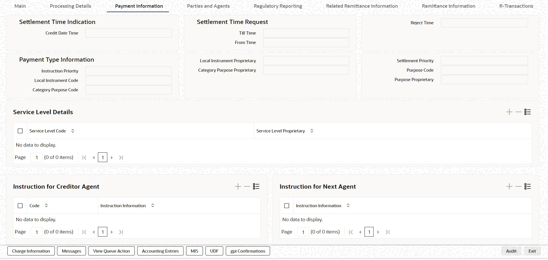

  1. From the main screen, select the Payment Information tab.
    The Payment Information tab is displayed.
    Figure 5-43 RTGS ISO FI to FI Customer Credit Transfer View - Payment Information Tab
    Description of Figure 5-43 follows
    Description of "Figure 5-43 RTGS ISO FI to FI Customer Credit Transfer View - Payment Information Tab"
  2. In the Payment Information tab, view the details. For more information on fields, refer to the field description table below:
