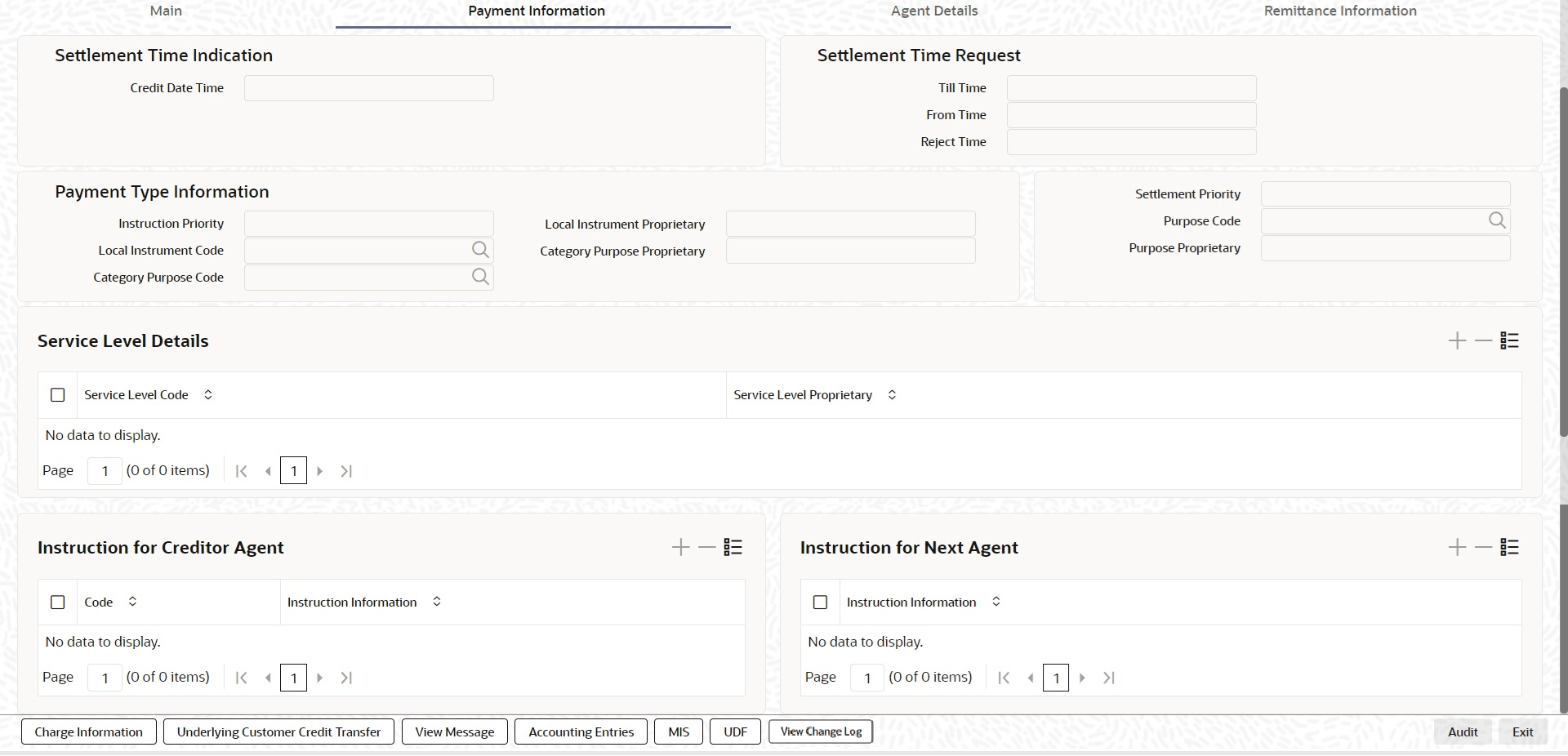

  1. From the main screen, select the Payment Information tab.
    The Payment Information details are displayed.
    Figure 4-146 RTGS ISO Inbound FI Credit Transfer Input Detailed - Payment Information Tab
    Description of Figure 4-146 follows
    Description of "Figure 4-146 RTGS ISO Inbound FI Credit Transfer Input Detailed - Payment Information Tab"
  2. On the Payment Information tab, specify the fields.
