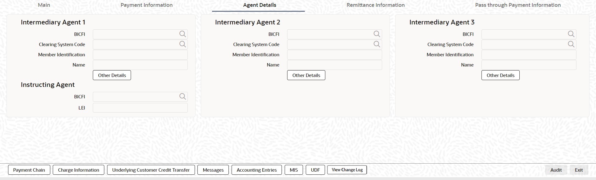

  1. From the main screen, select the Agents Details tab.
    The Agents Details details are displayed.
    Figure 3-180 RTGS ISO Outbound FI Credit Transfer Input Detailed - Agents Details Tab
    Description of Figure 3-180 follows
    Description of "Figure 3-180 RTGS ISO Outbound FI Credit Transfer Input Detailed - Agents Details Tab"
  2. On the Agents Details tab, specify the fields.

    Intermediary Agent 1 This section displays the following fields.
    BICFI Select the BICFI from the list of values.
    Clearing System Code Select the Clearing System Code from the list of values.
    Member Identification Specify the Member Identification.
    Name Specify the name of the intermediary agent.
    Other Details Button
    Click the Other Details button on Agent Details tab under Intermediary Agent 1 header to open the sub-screen. This screen displays the Intermediary Agent 1 Details.
    Refer to the topic Process Agent Details Tab - Other Details Button for details of fields and sub-screen of the Other Details button.
    Intermediary Agent 2 This section displays the following fields.
    Member Identification Specify the member identification.
    Click the Other Details button on Agent Details tab under Intermediary Agent 2 header to open the sub-screen. This screen displays the Intermediary Agent 2 Details.
    Intermediary Agent 3 This section displays the following fields.
    Click the Other Details button on Agent Details tab under Intermediary Agent 3 header to open the sub-screen. This screen displays the Intermediary Agent 3 Details.
    Refer to the Section Process Agent Details Tab - Other Details Button for details of fields and sub-screen of the Other Details button.
    Instructing Agent This section displays the following fields.
    LEI Specify the LEI of the agent.
