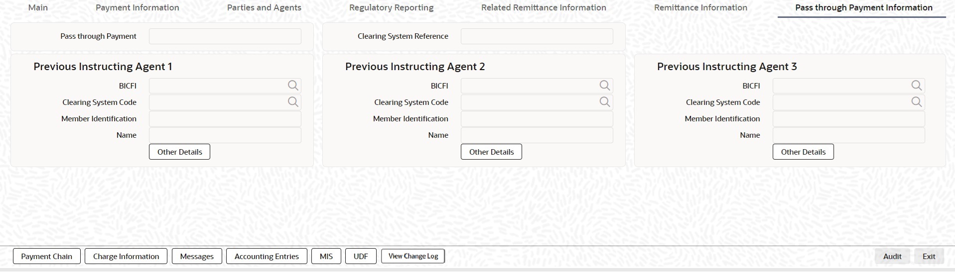

  1. From the main screen, select the Pass through Payment Information tab.
    The Pass through Payment Information details are displayed.
    Figure 3-157 RTGS ISO Outbound FI to FI Customer Credit Transfer Input - Pass through Payment Information Tab
    Description of Figure 3-157 follows
    Description of "Figure 3-157 RTGS ISO Outbound FI to FI Customer Credit Transfer Input - Pass through Payment Information Tab"
  2. On the Pass through Payment Information tab, specify the fields.
