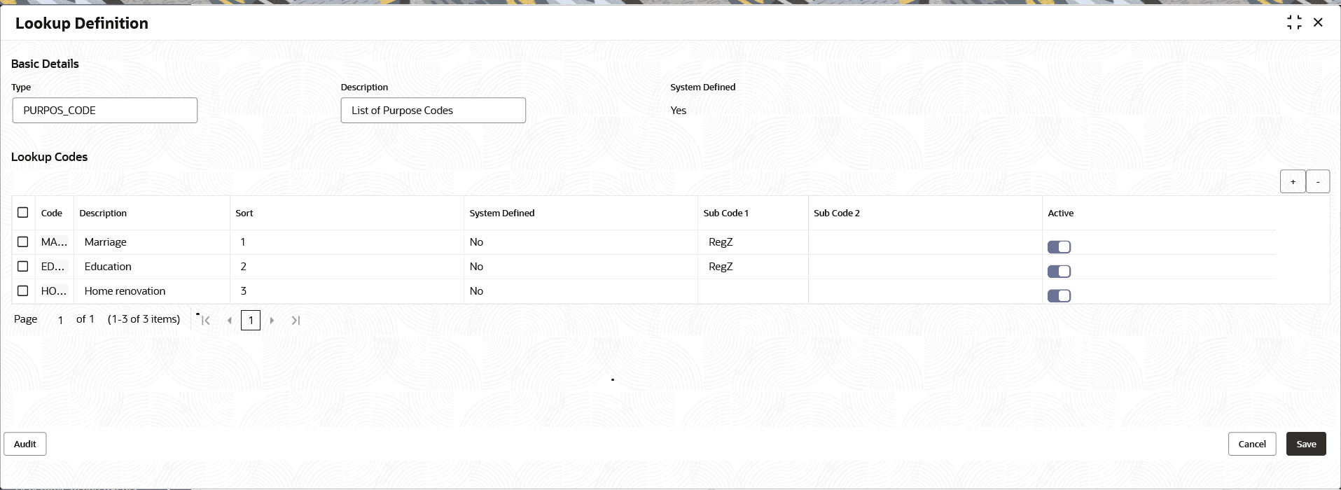

2.3.1 Create Lookup
This topic describes the steps used to create lookup definitions.
  1. From Home screen, click Retail Lending. Under Retail Lending, click Maintenance.
  2. Under Maintenance, click Lookups, then click Create Lookup.
    The Create Lookup screen is displayed.
  3. Specify the fields on Create Lookup screen.
    The fields marked as Required are mandatory.
    Table 2-5 Create Lookup - Field Description
    Field Description
    Type Specify the unique name for look up type that is to be used while attaching the same to a field.
    Description Specify the short description for lookup type.
    System Defined Displays the value is system defined or not for the lookup type.
    • The value of this field will be Yes for the majority of the product shipped lookup codes, which cannot be changed or removed.
    • The value of this field will be No for a user-defined code.
    By default, the value is No.
    Lookup Codes Specify the details under this section.
    Code Specify the unique lookup code for the defined lookup type.
    Description Specify the short description for lookup code.
    Sort Specify the unique sort order for the lookup code. Look up codes are sorted and displayed as per this order while showing up the list of values.
    Sub Code 1 Specify the sub code 1 used for processing logic. This is used to handle small use case or filter to show value or do some action; to avoid hard coding or explicit parameter.
    For example, look up type is defined as VILLAGEC_ODES and codes refer to the village codes, Sub Type 1 can be defined as District of the village and Sub Type 2 can be defined as Taluk of the village.
    Note: By assigning Reg Z as a lookup attribute within the Allowed Purpose Code table, the system can automatically identify and flag RegZ applicable loan purpose codes such as such as Education, Marriage, Medical, or Vacation. These purpose codes will not be pre-shipped and it is the responsibility of the user to configure the Reg Z allowed purpose codes as applicable.
    Sub Code 2 Specify the sub code 2 used for processing logic. This is used to handle small use case or filter to show value or do some action; to avoid hard coding or explicit parameter.
    Active
    Switch ON to enable lookup codes for the type.
    Switch OFF to disable lookup codes for the type.
  4. Click Save to save the details.
    The Lookups is successfully created and can be viewed using the View Lookup screen.
