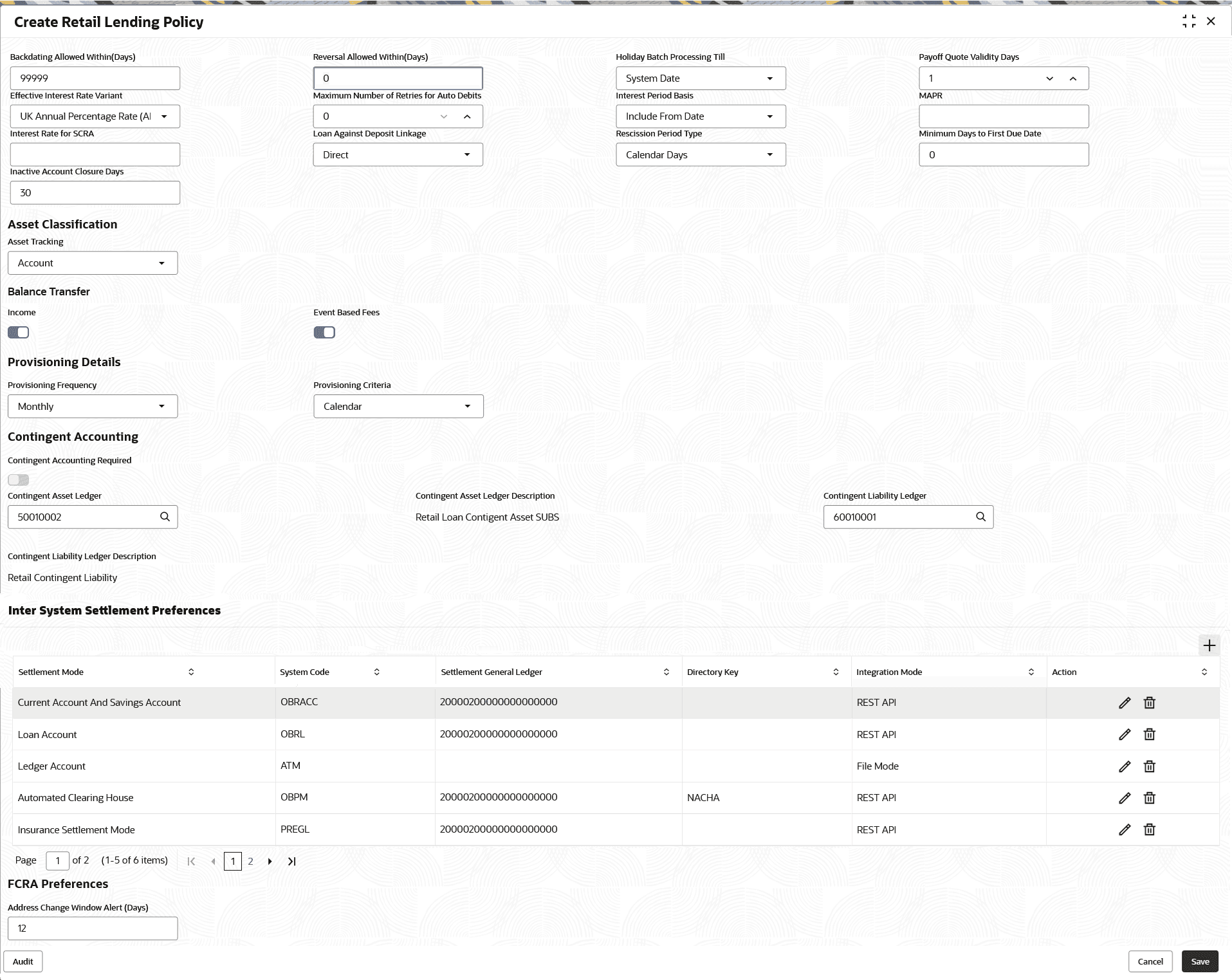

2.1.1 Create Retail Lending Policy
This topic describes the systematic instructions to create bank level Lending policy parameters.
  1. From Home screen, click Retail Lending. Under Retail Lending, click Maintenance.
  2. Under Maintenance, click Retail Lending Policy, then click Create Retail Lending Policy.
    The Create Retail Lending Policy screen is displayed.
    Figure 2-1 Create Retail Lending Policy
  3. Specify the fields on Create Retail Lending Policy screen.
    The fields marked as Required are mandatory.

  4. Click Save to save the details.
    The Retail Lending Policy is successfully created and can be viewed using the View Retail Lending Policy screen.
