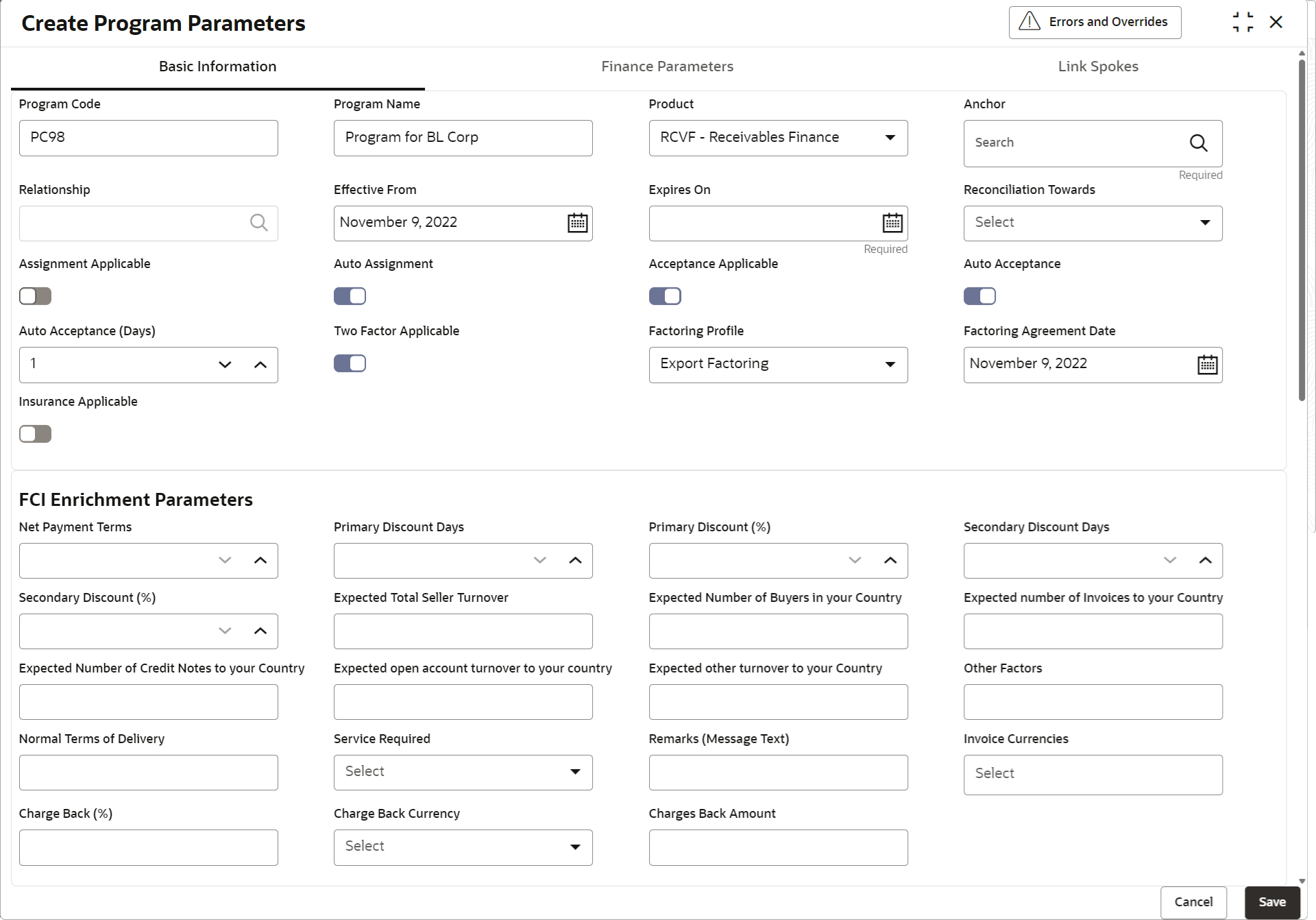

                    Click Create Program Parameters.The Create Program Parameters - Basic Information screen displays.
Figure 2-16 Create Program Parameters - Basic Information
 - On Basic Information tab, specify the fields to
                    configure the basic information for the program being created.For more information on fields, refer to the field description table.
The fields marked as Required are mandatory.Table 2-14 Basic Information - Field Description

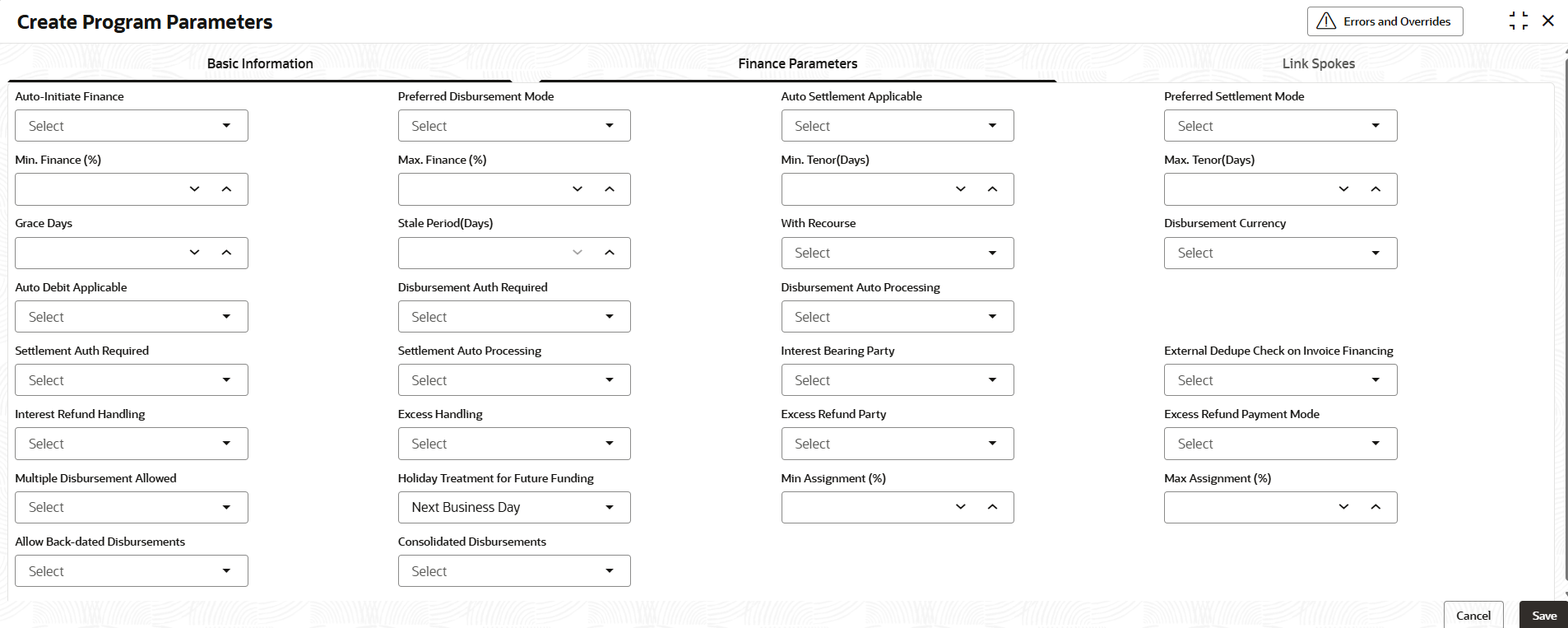

Figure 2-17 Create Program Parameters - Finance Parameters
 - On Finance Parameters tab, specify the fields to
                    configure the finance parameters for the program being created.For more information on fields, refer to the field description table.
The fields marked as Required are mandatory.Table 2-15 Finance Parameters - Field Description

 - Accepted or Financed Instruments - The account is auto-debited when the invoice/debit note is either accepted or financed, and Reconciliation Towards is set to Invoice.
 - All Instruments - The account is auto-debited when Reconciliation Towards is set to Invoice, irrespective of whether the invoice/debit note is accepted or financed.
This field appears only if Auto Debit Applicable is set to Yes.
Disbursement Auth Required Select Yes to enable authorization for the disbursement transactions for this spoke. Else select No. Disbursement Auto Processing Select Yes to enable automatic processing of disbursement transactions for this spoke. Else select No. Amendment Auth Required Select Yes to enable authorization for the amendment transactions for this spoke. Else select No.
This field appears only if the Product selected has Amendment Applicable enabled.
Amendment Auto Processing Select Yes to enable automatic processing of amendment transactions for this spoke. Else select No.
Settlement Auth Required Select Yes to enable authorization for the settlement transactions for this spoke. Else select No. Settlement Auto Processing Select Yes enable automatic processing of settlement transactions for this spoke. Else select No. External Dedupe Check on Invoice Financing Select Yes to enable the system checks for duplicate financing entries with our invoice registry partner and alerts the user if any are found. Else select No. Conditions for Marking Invoice Paid Select whether the financed invoice should be marked as Paid during Disbursement or during Settlement.
This field appears only when the Buyer is the borrower, for which the Product should have one of the following configurations:- Product Type = Buyer Centric; Product Category = Invoice; Borrower = Anchor
 - Product Type = Supplier Centric; Product Category = Invoice; Borrower = Spoke
The options available in this field are:- Disbursement:
- If the invoice is financed to the maximum finance percentage, then during disbursement it is marked as Paid. The outstanding invoice amount, if any, is handled as per margin handling settings.
 - If the invoice is not financed to the maximum finance percentage, then during disbursement, the invoice is marked as Partially Paid. Once the outstanding invoice amount is settled based on margin handling settings, then the invoice is marked as Paid.
 - Settlement:
- If an invoice is financed to the maximum finance percentage, and if all underlying finances are fully paid off during settlement, then the invoice is marked as Paid.
 - If the invoice is not financed to the maximum finance percentage, then during settlement the invoice is marked as Partially Paid. It is then marked as Paid, once the outstanding payment is made.
Margin Handling Select how the margin should be handled.
The available options are:- Auto-Settle and Refund to Supplier
 - Manually Settle O/s Finances
 - Refund to the Supplier
 - Settle with Outstanding Finances
This field is displayed only if the Product selected in this program has Product Category selected as Invoice.
Margin Payment Mode Select the mode of payment for the margin amount.
The available options are:- Account Transfer
 - CBT – Cross Border Transfer
 - Cheque
 - EFT
This field is displayed only if Margin Handling is selected as Refund to the Supplier or Auto-Settle and Refund to Supplier.
Interest Refund Handling Select how the interest refund should be handled.
The available options are:- Auto-Settle and Refund to IBP
 - Refund to the Interest Bearing Party
Interest Refund Payment Mode Select the mode of payment for the interest refunds.
 - Cheque
 - EFT
This field is displayed only if Interest Refund Handling is selected as Refund to the Interest Bearing Party or Auto-Settle and Refund to IBP.
Excess Handling Select how excess payment made towards settling of outstanding invoice/finance, should be handled.
The available options are:- Auto-Reconcile
 - Auto-Reconcile and Refund
 - Manually-Reconcile
 - Refund to beneficiary or payment party
Excess Refund Party Select the party to refund the excess amount to.
The available options are:- Beneficiary/Counter Party
 - Payment Party
Excess Refund Payment Mode Select the mode of payment for the excess payment refund.
 - Cheque
 - EFT
Multiple Disbursement Allowed Select Yes to enable multiple finance disbursements for an invoice. Else select No. Min Assignment (%) Specify the minimum percentage of the assignment amount allowed for financing a transaction of this spoke. Max Assignment (%) Specify the maximum percentage of the assignment amount allowed for financing a transaction of this spoke. Credit Cover (%) Specify the credit cover percentage allowed for the transaction for this spoke.
This field is displayed only if Assignment event in the Credit limit Mapping tab of Product Parameters is same as the limit type maintained in the Limit Type for Invoice Approval in System Parameters.
Credit Cover Start Date Specify the credit cover start date for the transaction for this spoke.
Credit Cover End Date Specify the credit cover end date for the transaction for this spoke.
Liquidate Pre-Shipment Finances † † Switch the toggle ON to enable linking of Pre-Shipment and Post-Shipment programs. Pre-Shipment Program Displays the applicable pre-shipment programs auto populated for the selected supplier-buyer combination.
This field is enabled only if Liquidate Pre-Shipment Finances is enabled.
Pre-Shipment Finances Liquidation Preference † Select the liquidation preference for the settlement of pre-shipment finance.
The available options are:- Invoice Linked with PO
 - FIFO
 - Invoice Linked with PO and FIFO
Allow Back-Dated Disbursements Select Yes to enable back-dated disbursements for the transaction of this spoke. Else select No. FCI Enrichment Parameters This section is displayed only if Two Factor Applicable toggle is switched ON.
An FCI Message 1 - Seller’s Information is generated upon the onboarding of a new Seller in the application (Program Parameters) for a Factoring Program with Factoring Profile designated as Export Factoring. This message is subsequently transmitted to the Import Factor via an FCI message batch job.Note:
An FCI message is generated whenever a Spoke is newly added to the program.Net Payment Terms Specify the number of days after which the invoices can be due for payment. Primary Discount Days Specify the number of days applicable for the primary discount. Primary Discount % Specify the primary discount percentage. Secondary Discount Days Specify the number of days applicable for the secondary discount. Secondary Discount % Specify the secondary discount percentage. Expected Total Seller Turnover Specify the total turnover expected from the seller. Expected Number of Buyers in your Country Specify the number of buyers expected in the import factor's country for this seller. Expected Number of Invoices to your Country Specify the expected number of invoices which will be raised on the import factor's country for this seller. Expected Number of Credit Notes to your Country Specify the expected number of credit notes which will be raised on the import factor's country for this seller. Expected open account turnover to your country Specify the open account turnover to on the import factor's country for this seller. Expected other turnover to your Country Specify any other turnover to on the import factor's country for this seller. Other Factors Specify the import factors involved in the factoring i.e., if more one than factor is involved for the same seller in the same country. Normal Terms of Delivery Specify the delivery terms, if any. Services Required Specify the services required from the import factor. The available options are:- Full Service, non recourse
 - Recourse
 - Collection only
 - Special service (RESCUE, POM, IV)
 - Non-notification
 - Buyer to pay directly to EF/Seller
 - Agency Agreement
Remarks (Message Text) Specify the comments regarding the factoring, if any. Invoice Currencies Select the currency for invoice. You can select multiple currencies in this field. Charge Back % Specify the charge back percentage in cases of dispute. Charge Back Currency Specify the currency of the charge back amount. Charge Back Amount Specify the charge back amount in cases of dispute. Consolidated Disbursements This field determines whether financing is processed in batches or per instrument. When set to Yes, instruments will be grouped together under a single financing, provided they meet the necessary criteria. If set to No, each instrument will be financed individually, with consolidation occurring only if the request count exceeds the specified threshold. Note:
† Pre-Shipment settlement gets initiated only if Auto Settlement Applicable is enabled.Note:
†† For existing implementations of SCF, Liquidate Pre-Shipment Finances and Pre-Shipment Finances Liquidation Preference will be captured in Program Parameters basis their value in System parameters. System Parameters will be defaulted to ‘No’ but can be changed to ‘Yes’ at the discretion of the bank or Financial Institution during upgrade to current release version. In such cases the application will establish Pre-Post shipment finance linkage if a valid pre-shipment linkage is foundNote:
For existing implementations, Conditions for Marking Invoice Paid will be defaulted to blank implying that the invoice will be marked as Paid, only if an invoice payment is directly received. Banks or Financial Institutions should modify the field too. - Click External Code link to specify the external spoke

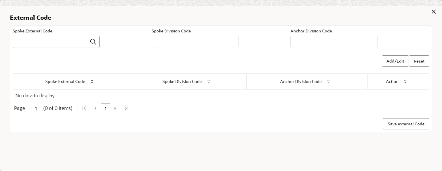

                    codes.The External Code pop-up screen displays.
- In the Spoke External Code field, click the search icon to select the external spoke code. The corresponding Spoke Division Code and Anchor Division Code gets displayed in the adjacent columns.
 - Click Add/Edit to add the details in the grid.
 - Repeat these steps to add more external codes.
 - If required, click Options icon under the Action column in the grid and then click Delete to remove the record.
 - Click Save external Code to save the external code details.
 - Click Add/Edit to add the record to the grid.
 - Click Reset to clear the selected values, if required.
