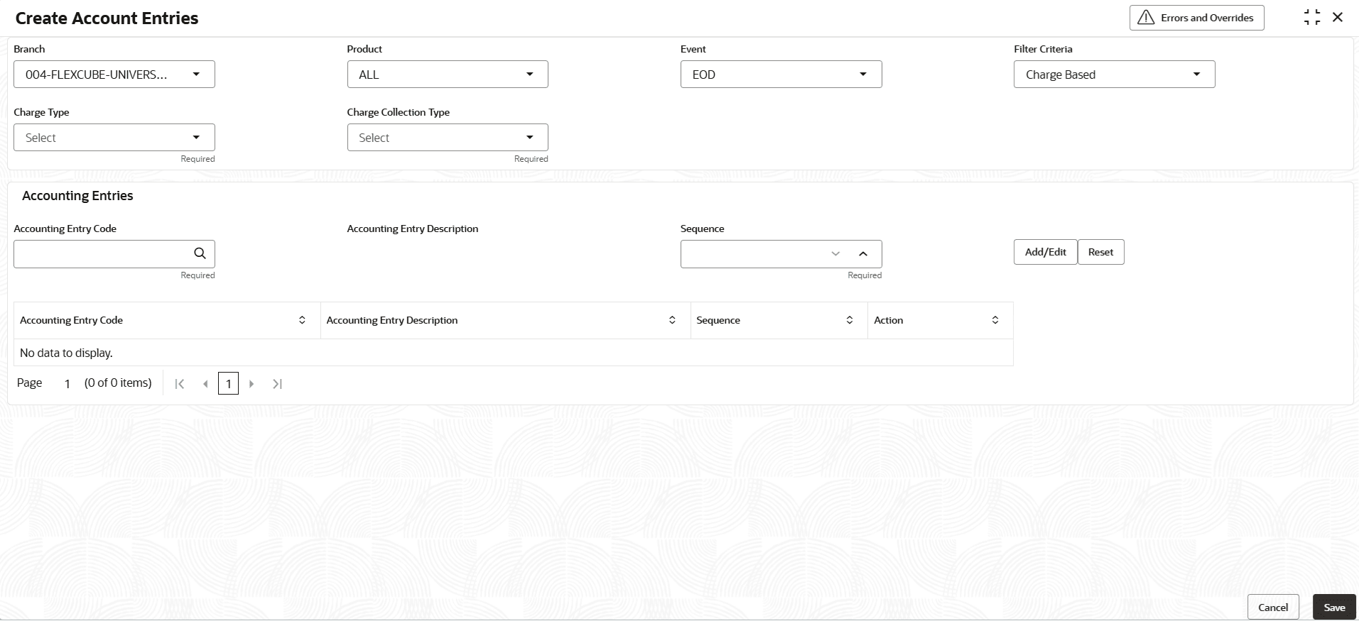

    The Create Account Entries screen displays.
    Figure 3-5 Create Account Entries
  4. Specify the fields on Create Account Entries screen.
    The fields marked as Required are mandatory.

  5. Click Add/Edit to add the details to the grid.
  6. Click the hyperlink to view the details of the selected Accounting Entry Code.
    The Accounting Entry Code Details screen displays.
    Figure 3-6 Accounting Entry Code Details
  7. Perform the following steps to take action on the records in the grid.
    1. Click More Options icon in the Action column to edit or delete the row.
  8. Click Reset to clear the selected values, if required.
  9. Click Save to save the record and send it for authorization (if applicable).
