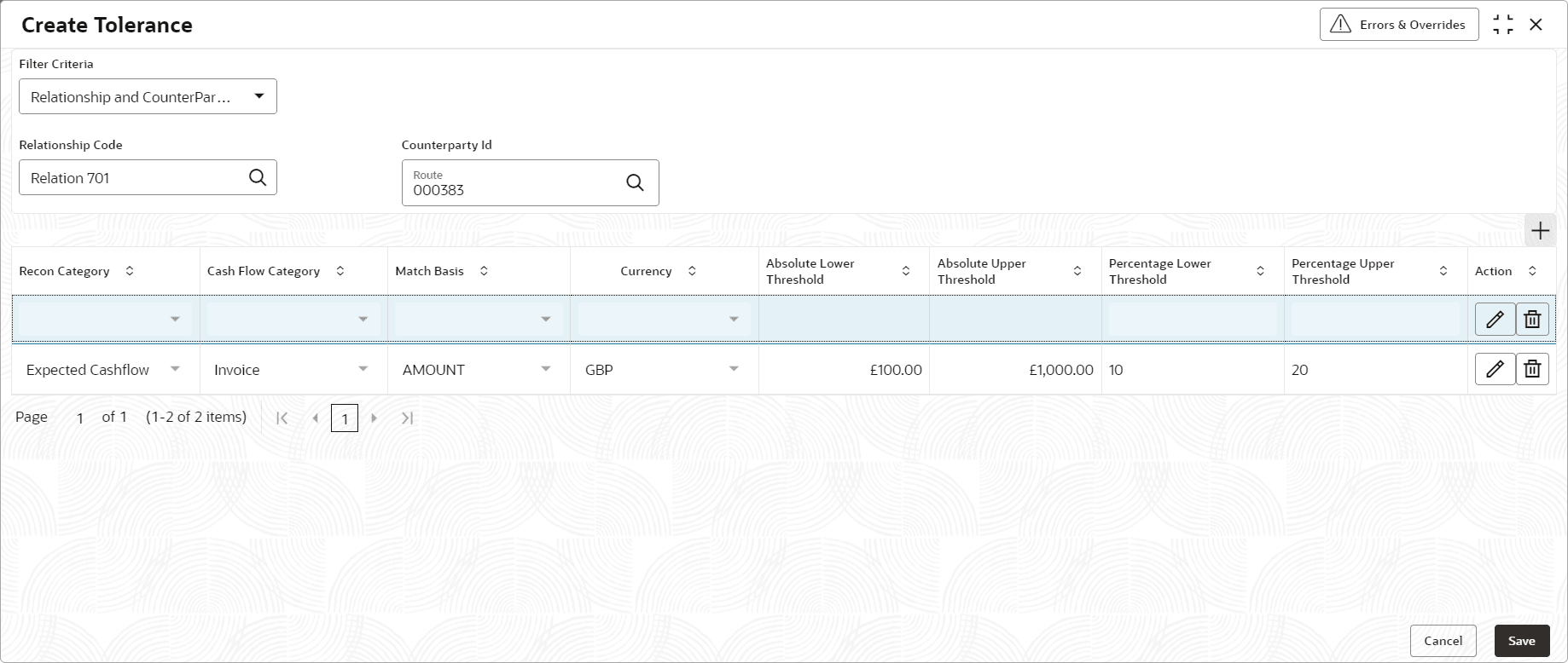

3.11.1 Create Tolerance
This topic describes the systematic instruction to create a tolerance.
Newly created tolerance takes effect once authorized and cannot be modified thereafter.

    The Create Tolerance screen displays.
  3. Specify the fields on Create Tolerance screen.
    The fields marked as Required are mandatory.
    Table 3-33 Create Tolerance - Field Description
    Field Description
    Filter Criteria Select the appropriate filter criteria for specific application of tolerance. Available options are:
    • Relationship and CounterParty Based
    • Relationship based
    • Party Based
    • Default
    Relationship Code Click the Search icon and select the relationship code.
    This field is displayed only if the Filter Criteria is selected as Relationship and Counterparty Based or Relationship Based.
    Counterparty Id Click the Search icon and select the counterparty id.
    This field is displayed only if the Filter Criteria is selected as Relationship and Counterparty Based.
    Party Click the Search icon and select the party.
    This field is displayed only if the Filter Criteria is selected as Party Based.
  4. Click Add icon to add rows in the grid and specify the following details in the grid.

    Recon Category Select the recon category to add the tolerance for.
    Cash Flow Category Displays the cashflow category based on selected recon category.
    Match Basis Select the value to be matched from the reconciliation record.
    For example: AMOUNT
    Currency Select the currency to be considered for threshold amount/percentage.
    Absolute Lower Threshold Specify the lower absolute variance of either amount.
    Absolute Upper Threshold Specify the upper absolute variance of either amount.
    Percentage Lower Threshold Specify the lower percentage variance of either amount.
    Percentage Upper Threshold Specify the upper percentage variance of either amount.
