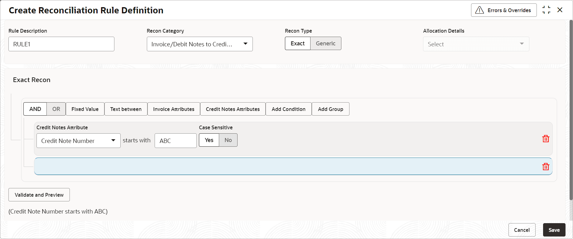

  5. In the Exact Recon section, perform the following steps to create conditions or group of conditions:
    1. Click Add Condition to add a single line of condition. Or, click Add Group to add a group of conditions.
    2. Click inside the added container to view buttons for adding condition details.
      The Exact Recon - Condition/Group Details screen displays with the Fixed Value, Text between, Invoice/Payment Attributes, Cashflow/Payment Attributes, or Payment Attributes (depending on the selected recon category).
      Figure 3-52 Exact Recon - Condition/Group Details

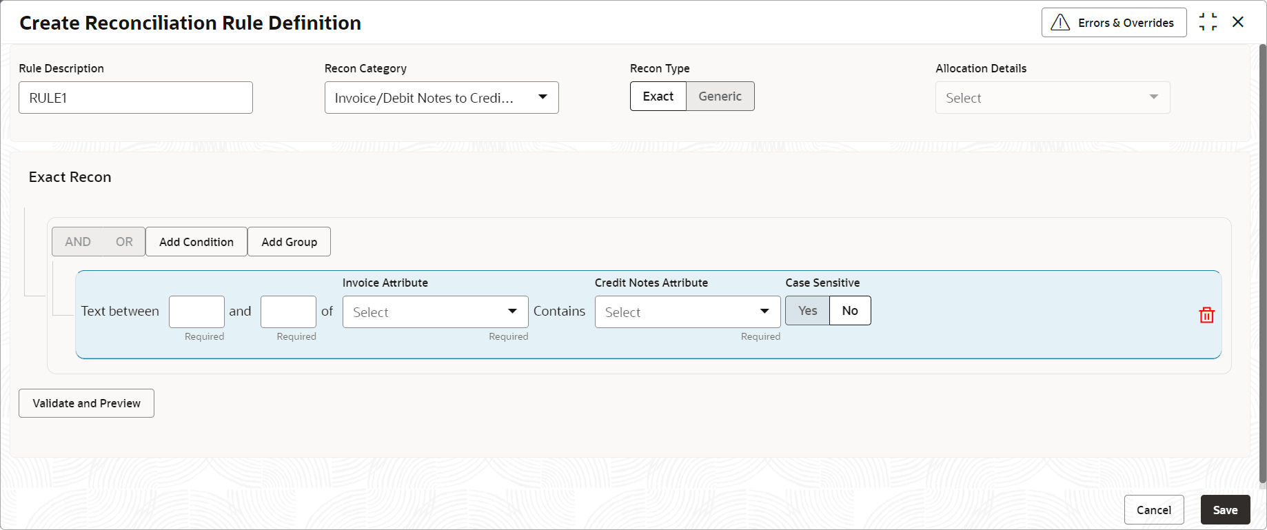

    3. Click Fixed Values to define the value to be validated.
    4. Click Text between to define the range of text to be validated.
      The Exact Recon - Text Between screen displays.
      Figure 3-53 Exact Recon - Text Between
    5. Select the Case Sensitive as Yes or No to check the case sensitivity of the field value while recon execution.

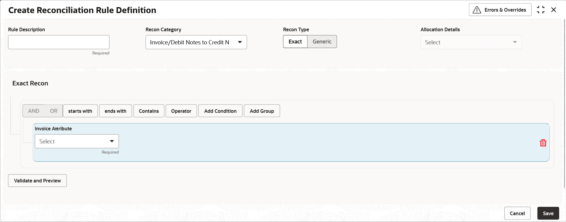

    6. Click Invoice/Expected Cashflow Attributes_Invoice/Finance Attributes to define condition for invoice/cashflow/finance details. Or click Payment Attributes to define condition for payment details.
      The Exact Recon - Attributes screen displays.
      Figure 3-54 Exact Recon - Attributes
      For more information on the attributes, refer the following attributes table.

    7. Click starts with, ends with and contains to define the text to be validated based on each selection.
    8. Click Operator to specify how to compare defined values.
    9. Repeat the above steps to add more conditions and/or group of conditions.
    10. Click Delete icon to delete the condition located at the right-bottom of the condition container.
    11. Click AND / OR to define how many conditions or combination of conditions should be matched to execute the recon rule.
    12. Click Validate and Preview to check if the added conditions are valid or not.

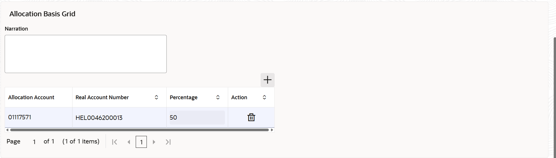

      The Allocation Basis Grid displays.
      Figure 3-55 Allocation Basis Grid
      Table 3-31 Allocation Basis Grid - Field Description
      Field Description
      Narration Specify the narration.
      The narration entered in the Reconciliation Rule Definition will be sent to VAM during the auto-allocation of the payment to the Virtual Account, so it can be recorded in the statement.
      Allocation Account Click Search icon to search and select the Allocation Account from the LOV.
      Real Account Number Displays the Real Account Number based on the selected Allocation Account.
      Percentage Specify the percentage of allocation.
  6. In the Allocation Basis Grid section, perform the following steps to define percentage of account/attribute allocation:
    1. Click Add to add a new row.
    2. Double click the row to add/edit attribute and percentage.
    3. Repeat the above steps to add more attributes.
    4. Click Delete under Action column to remove the allocation row.
  7. Click Save to save the record and send it for authorization.
