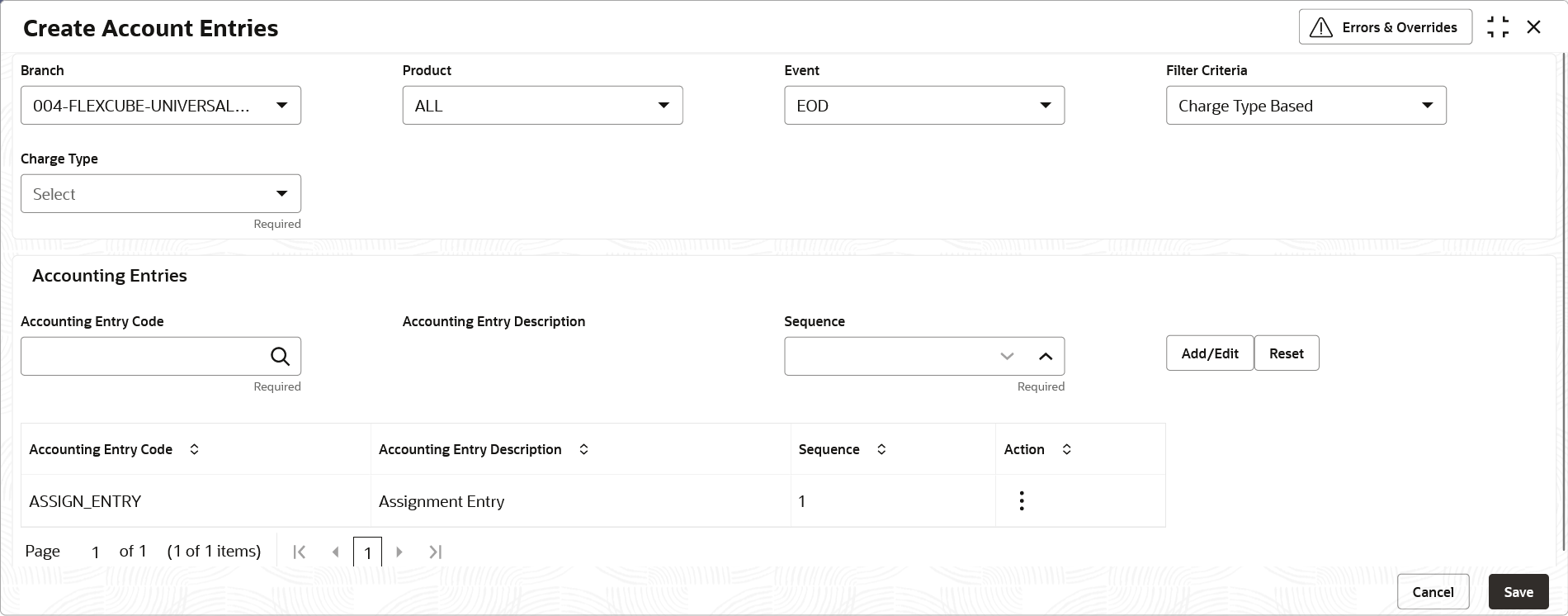

- Under Accounting Entries, click Create Account Entries.The Create Account Entries screen displays.
- Specify the fields on Create Account Entries screen.For more information on fields, refer to the field description table.
The fields marked as Required are mandatory.Table 3-3 Create Account Entries - Field Description
Field Description Branch Select the branch to add accounting entries for. Values in this field are listed based on your access rights. Product Select the product to add accounting entries for. User can select ‘ALL’ to create the entry code for all the products. Event Select the event to add accounting entries for. Filter Criteria Select the filter criteria for specific application of accounting entries. Charge Type Select the charge type as credit or debit. This field is displayed only if Filter Criteria is selected as Charge Type.

Accounting Entry Code Click the search icon to select the required accounting entry code. Accounting Entry Description Displays the description of the selected entry code. Sequence Select the sequence to be set for the accounting entry code. - Click Add/Edit to add the details to the grid.

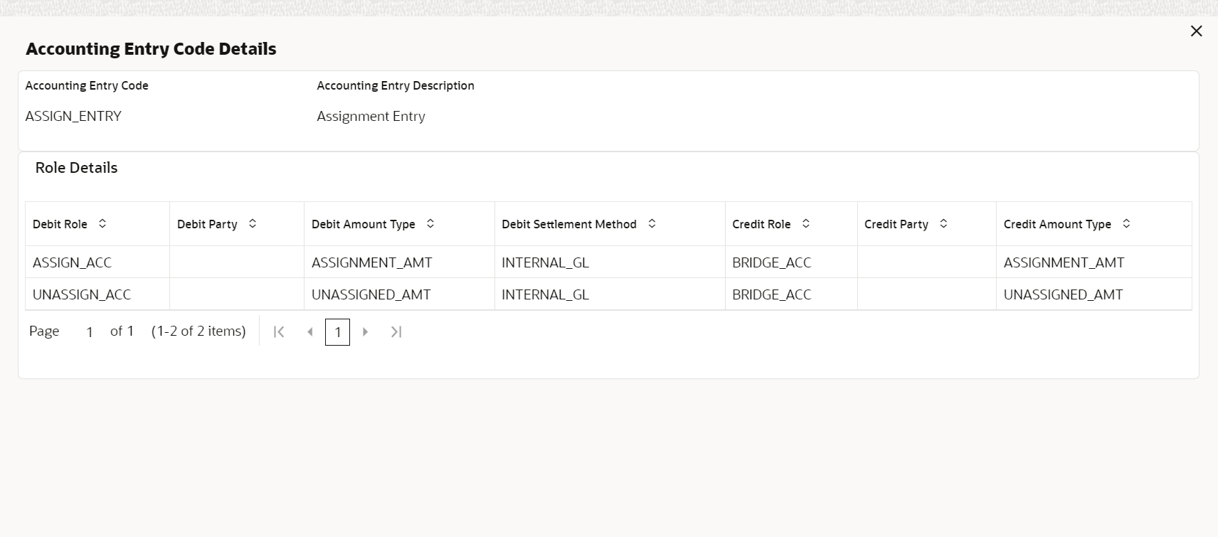

- Click the hyperlink to view the details of the selected Accounting Entry Code.The Accounting Entry Code Details screen displays.
