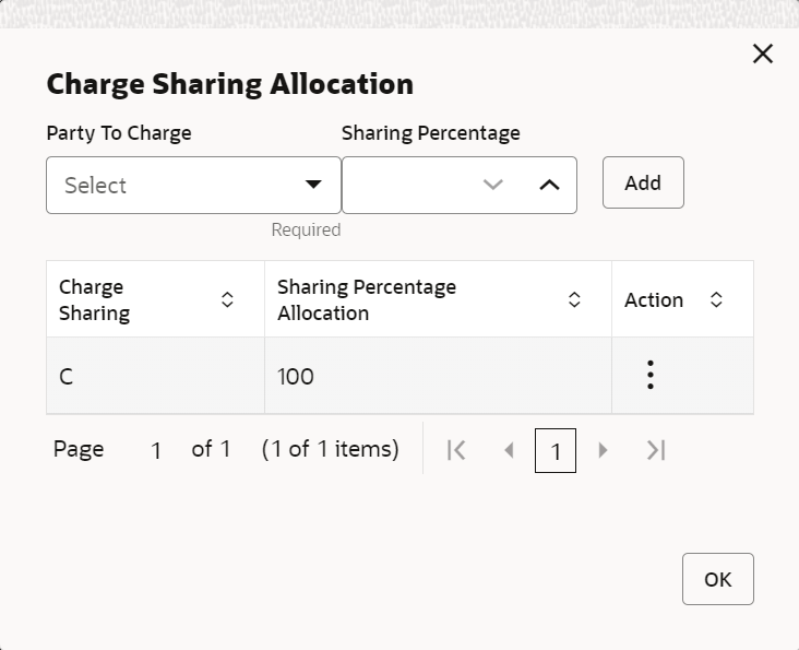

Charge Code Select the charge code for which the decisioning is to be configured. Charge Sharing Switch the toggle ON if charge sharing is applicable. Sharing Percentage Allocation Click the link to specify the sharing percentage for each party. This link is displayed only if the Charge Sharing toggle is enabled.

This field appears only if the Charge Sharing toggle is disabled.

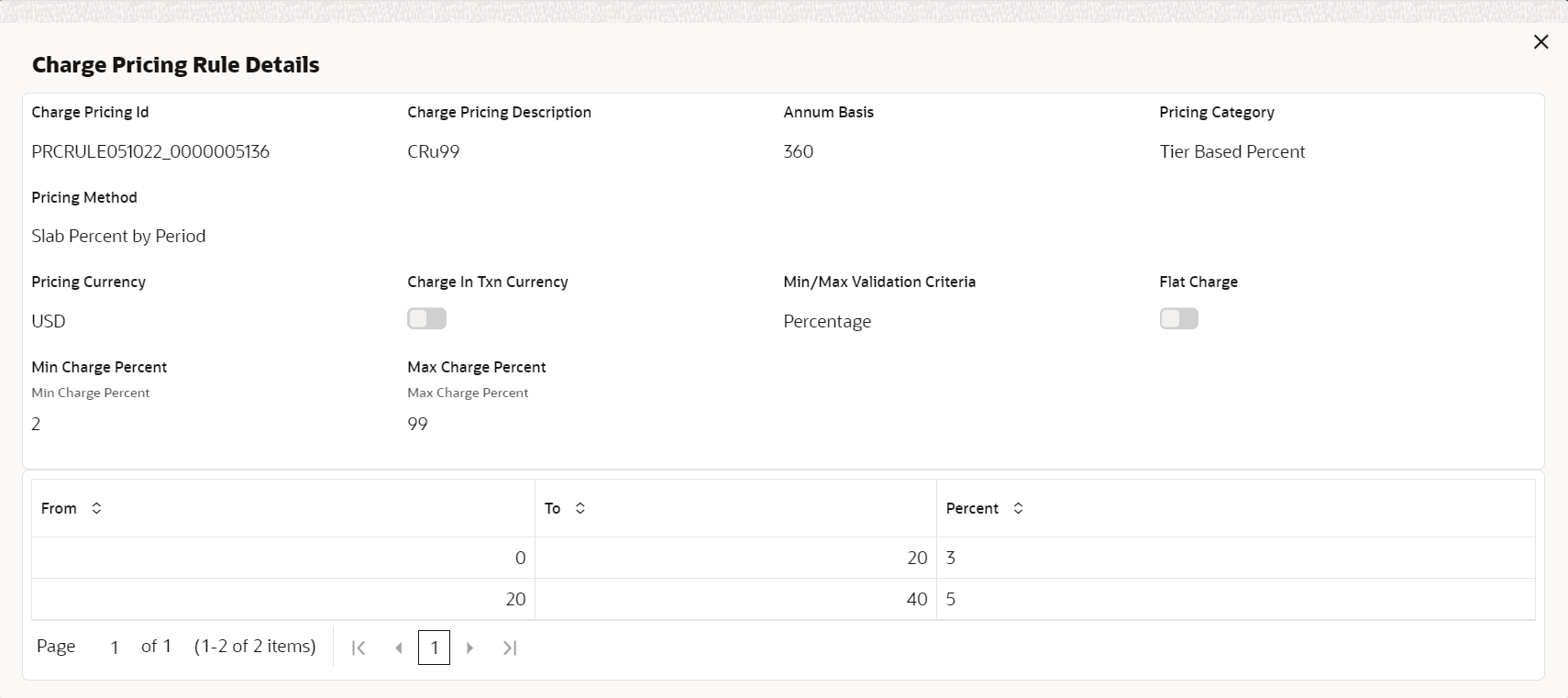

Charge Pricing Rule Click the search icon to select the charge pricing rule to be applied. External Pricing Switch the toggle ON to allow the user to configure the external pricing. By default, this toggle will be OFF.

Add/Override Charges Displays the details of new charges added in this grid. Default Charges Displays the default charges configured for the selected event in this grid, if the Inherit Charges is selected as Inherit Default Charges. These charges cannot be modified. - Click Sharing Percentage Allocation link to specify the sharing percentage for each party.The Charge Sharing Allocation popup screen displays.
- From the Party to Charge list, select the party to be charged.
- In the Sharing Percentage, enter the percentage to be allotted to the selected party.
- Click Add to add the details in the grid.
- Repeat these steps to add more parties to be charged.
The sum of percentages of all added parties should be 100. - If required, click
icon under the Action column in the grid and then click Edit to modify details or click Delete to remove the record.
- Click OK to save the charge sharing details.

- Click the hyperlink in the table grid to view the details of the pricing rule.The Charge Pricing Rule Details screen displays.
