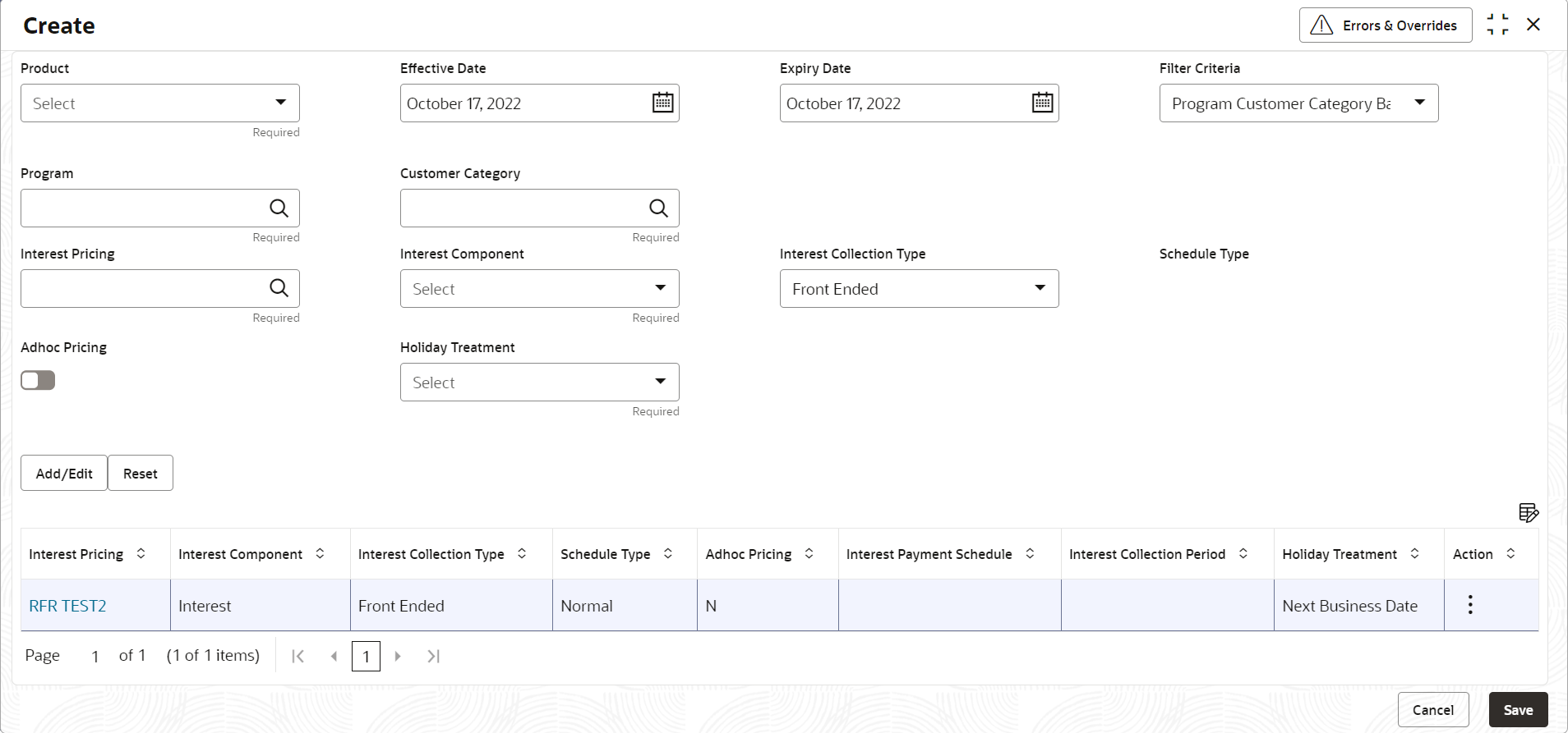

Figure 2-53 Create Interest Rate Decisioning
- Specify the fields on Create Interest Rate Decisioning
screen.For more information on fields, refer to the field description table.
The fields marked as Required are mandatory.Table 2-32 Create Interest Rate Decisioning - Field Description
Field Name Description Product Select the product to create the rate decisioning for. Effective Date Click the calendar icon to select the date from when the rate decisioning is effective. Expiry Date Click the calendar icon to select the date when the rate decisioning expires. Filter Criteria Select the appropriate filter criteria for the rate decisioning.

- Click Add/Edit to add the details to the grid.
- Perform the following steps to take action on the records in the grid:
- Select the record in the grid and then click Options icon in the Action column.
- Click Edit to edit the selected row.
- Click Delete to delete the selected row.
- Click Save to save the record and send it for authorization.
