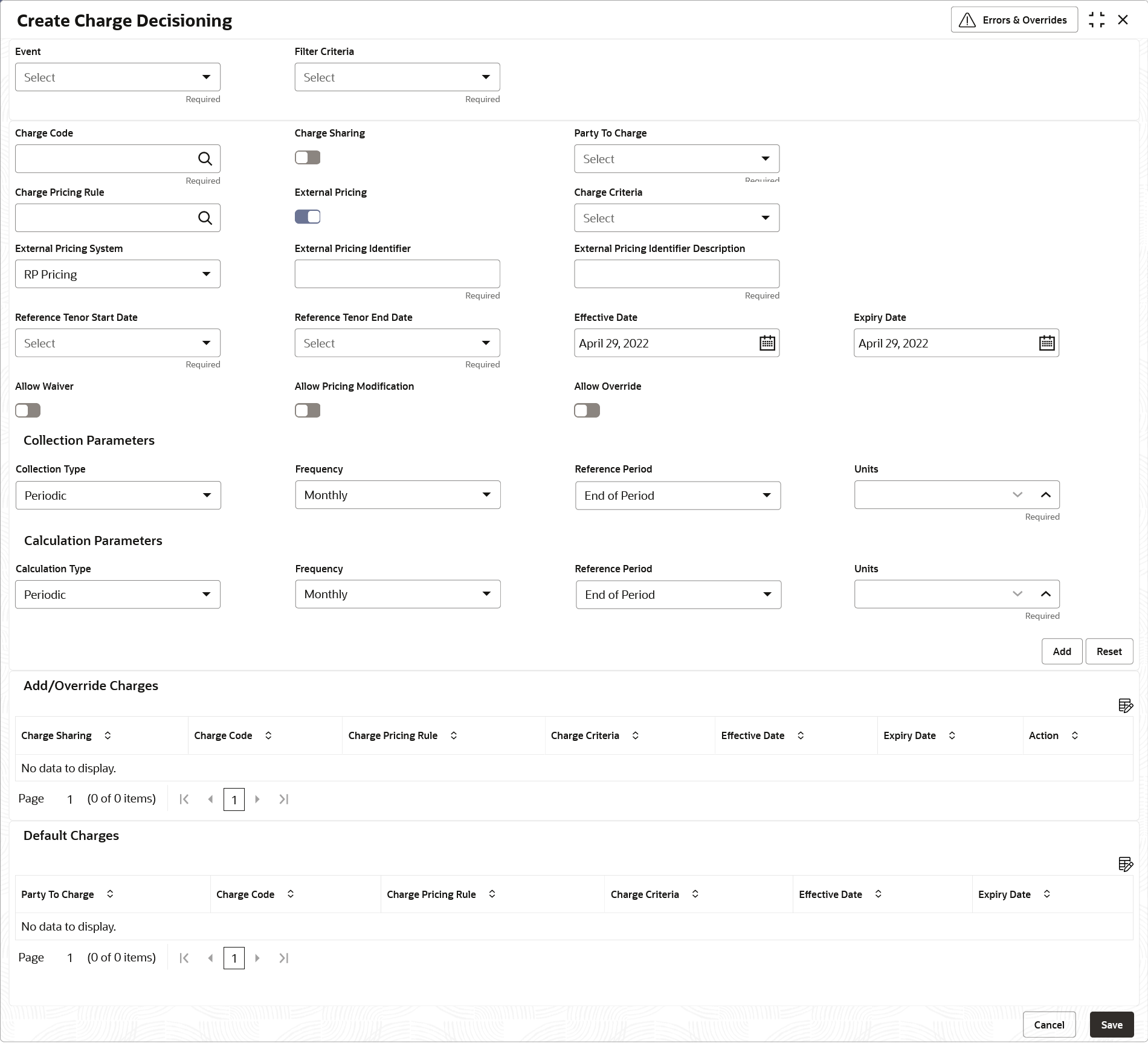

- Under Charge Decisioning, click Create Charge Decisioning.The Create Charge Decisioning screen displays.
- Specify the fields on Create Charge Decisioning screen.For more information on fields, refer to the field description table.
The fields marked as Required are mandatory.Table 3-14 Create Charge Decisioning - Field Description
Field Description Event Select the event on the occurrence of which, the charge should be applied. Filter Criteria Select the appropriate filter criteria on which the charge is required to be calculated and debited. This can be Default, or Instrument Type Status Based. Instrument Type Select the instrument type for which the charge is to be mapped. The options are:- PO

Effective Date Click the calendar icon to select the start date of the charge decisioning validity. Expiry Date Click the calendar icon to select the end date of the charge decisioning validity. Auto Waive Switch the toggle ON to enable automatic charge waiving at the time of transaction processing. This field is displayed only if Filter Criteria is selected as Instrument Type Status Based.
Allow Waiver Switch the toggle ON to enable manual charge waiving at the time of transaction processing. If the Auto Waive toggle is switched ON, then this toggle is switched OFF and disabled by default.
Allow Pricing Modification Switch the toggle On to allow pricing rule modification at the time of transaction processing. If the Auto Waive toggle is switched ON, then this toggle is switched OFF and disabled by default.
Allow Override Switch the toggle On to enable overriding of charge amount at the time of transaction processing. If the Auto Waive toggle is switched ON, then this toggle is switched OFF and disabled by default.

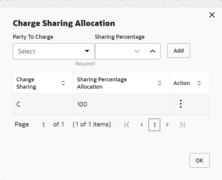

Add/Override Charges Displays the details of new charges added in this grid. Default Charges Displays the default charges configured for the selected event in this grid, if the Inherit Charges is selected as Inherit Default Charges. These charges cannot be modified. - Click Sharing Percentage Allocation link to specify the sharing percentage for each party.The Charge Sharing Allocation popup screen displays.
- From the Party to Charge list, select the party to be charged.
- In the Sharing Percentage, enter the percentage to be allotted to the selected party.
- Click Add to add the details in the grid.
- Repeat these steps to add more parties to be charged.
The sum of percentages of all added parties should be 100. - If required, click
icon under the Action column in the grid and then click Edit to modify details or click Delete to remove the record.
- Click OK to save the charge sharing details.
- Click Add to add the details to the grid.

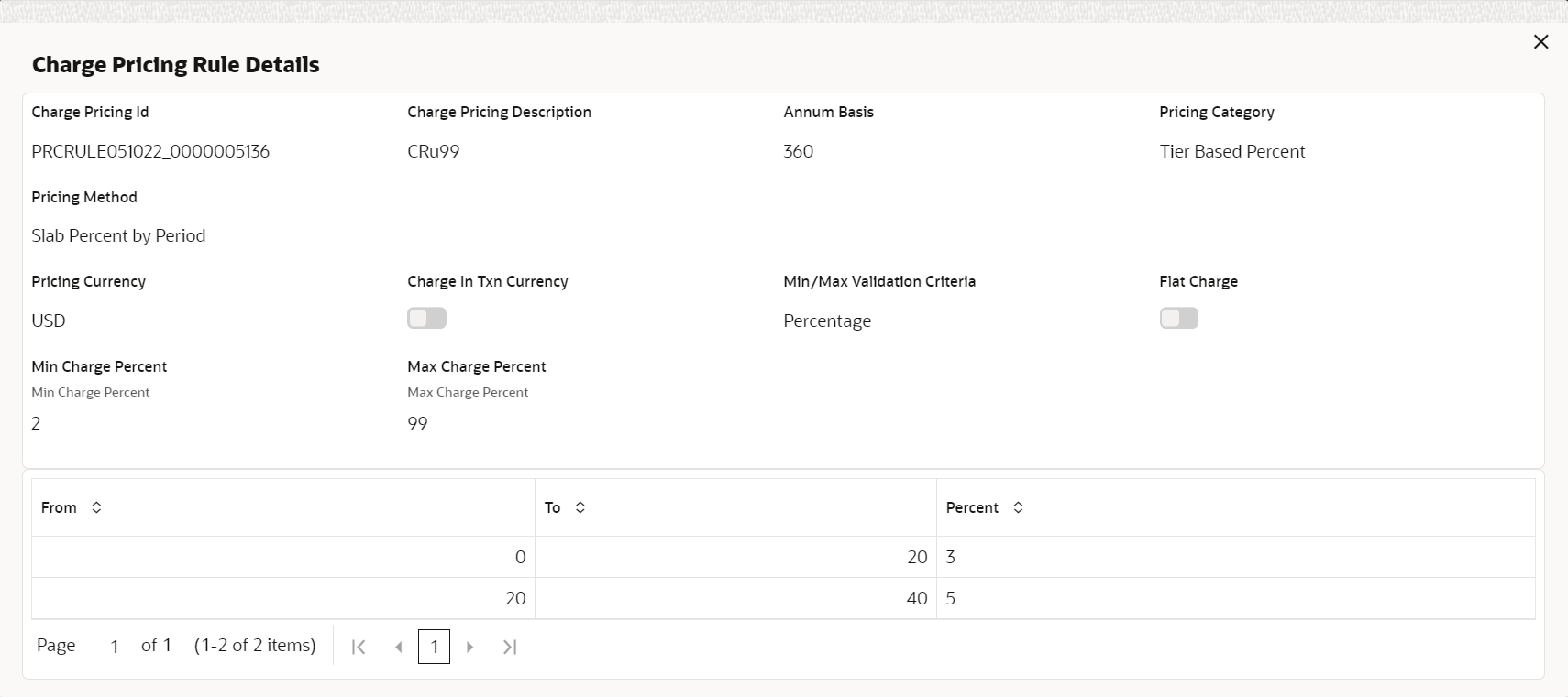

- Click the hyperlink in the table grid to view the details of the pricing rule.The Charge Pricing Rule Details screen displays.
