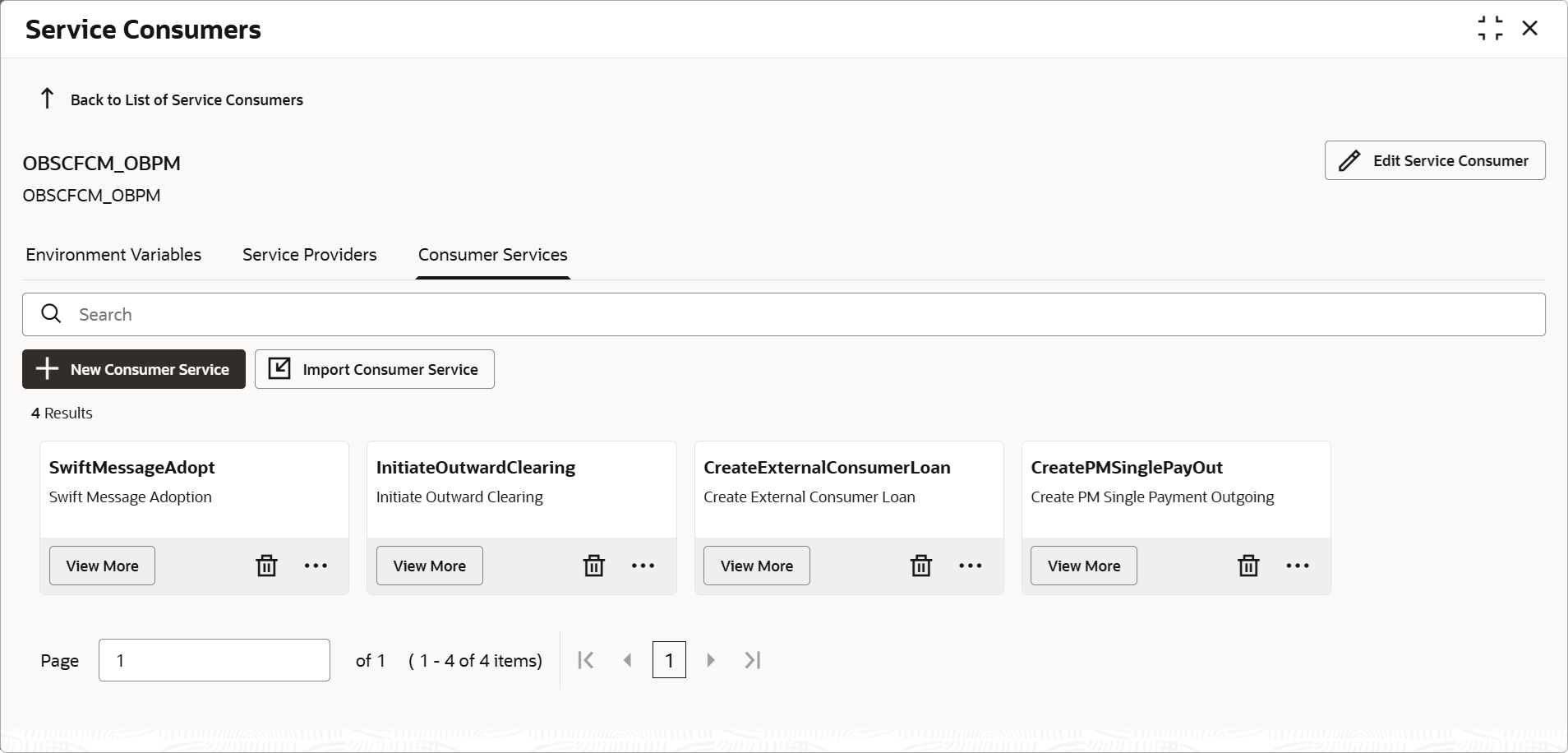

6.6 Consumer Services - Oracle Banking Payments
This topic describes about the consumer services required for Oracle Banking Payments Implementation.
- CreatePMSinglePayOut
- CreateExternalConsumerLoan
- SwiftMessageAdopt
This API enables the user to get the incoming payment details which is used for Invoice Payment Reconciliation during Auto and Manual reconciliation. This API is called from finance service and instruments.
SERVICE-CONSUMER = “OBSCFCM_OBPM”
SERVICE-CONSUMER-SERVICE= “CreatePMSinglePayOut”
This API enables the user to transfer the finance data to payments. This API is called from finance service and instruments.
SERVICE-CONSUMER-SERVICE= “CreateExternalConsumerLoan”

SwiftMessageAdopt
When payment mode is selected as Cross Border Transfer, this API will be used for external payment.
SERVICE-CONSUMER-SERVICE= “SwiftMessageAdopt”
