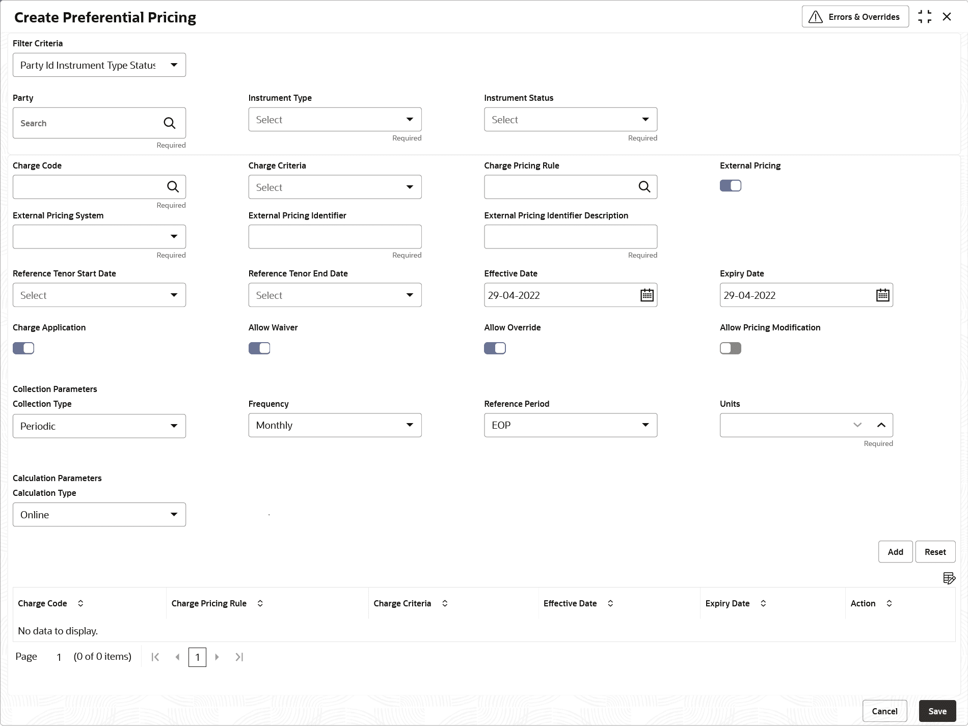

- On Home screen, click Receivables and Payavbles. Under Receivables and Payavbles, click Maintenance.
- Under Maintenance, click Charges. Under Charges, click Charge Preferential Pricing.
- Under Charge Preferential Pricing, click Create Preferential Pricing.The Create Preferential Pricing screen displays.
- Specify the fields on Create Preferential Pricing screen.
The fields marked as Required are mandatory.For more information on fields, refer to the field description table.
Table 3-17 Create Preferential Pricing - Field Description
Field Description Filter Criteria Select the appropriate filter criteria for specific application of accounting entries. Based on the selected criteria, the Party ID, Instrument Type, Instrument Status and Customer Category fields are displayed.
Party Click the Search icon to select the party to map the preferential pricing to. This field is displayed only if the Filter Criteria is selected as Party.
Instrument Type Select the type of instrument to map the preferential pricing to. Instrument statuses are available based on the selected instrument type.
This field is displayed only if the Filter Criteria is selected as Instrument Type.
Instrument Status Select the status of the instrument to map the preferential pricing to. This field is displayed only if the Filter Criteria is selected as Instrument Type.
Customer Category Click the Search icon to select the customer category. This field is displayed only if the Filter Criteria is selected as Customer Category.
Charge Code Click the Search icon to select the charge code for pricing configuration. Charge Criteria Select the criteria to be considered based on which charge should be calculated. The options are:- Count of POs
- Parent Charge Code
- Count of Invoices
- Invoice Amount
- PO Amount
Charge Pricing Rule Click the Search icon to select the charge pricing rule to be applied. Parent Charge Code Select the parent charge code. This field is displayed if the Charge Criteria is selected as Parent Charge Code.
External Pricing Switch the toggle ON to allow the user to configure the external pricing. By default, this toggle will be OFF.
External Pricing System Select the external pricing system from the dropdown list for which the external charges needs to be configured. This field appears only if the External Pricing toggle is ON.
External Pricing Identifier Specify the unique identifier for the external pricing system. This field appears only if the External Pricing toggle is ON.
External Pricing Identifier Description Specify the brief description about the external pricing identifier. This field appears only if the External Pricing toggle is ON.
Reference Tenor Start Date Specify which date should be considered to calculate the start of tenor duration. Reference Tenor End Date Specify which date should be considered to calculate the end of tenor duration. Effective Date Click the Calendar icon to select the start date of the preferential charge validity. Expiry Date Click the Calendar icon to select the end date of the preferential charge validity. Charge Application Switch the toggle ON to enable charge application. Allow Waiver Switch the toggle ON to enable charge waiving. Allow Override Switch the toggle ON to enable overriding of the charge. Allow Pricing Modification Switch the toggle ON to allow pricing modification. Collection Parameters Displays the fields related to Collections Parameters. Collection Type Select how the pricing should be collected. The options are:- Periodic
- Online
Frequency Select the frequency of charge collection. The options are:- Daily
- Weekly
- Monthly
- Half Yearly
This field is displayed only if the Collection Type is selected as Periodic.
Reference Period Select when the collection should take place for the selected frequency. For monthly or half-yearly frequency, the collection can take place either at the beginning of the period (BOP) or end of the period (EOP).
For weekly frequency, the collection can happen on a specific day of the week.
Units Specify whether the charge collection should take place as per units of specified frequency. This field is displayed only if the Collection Type is selected as Periodic.
Calculation Parameters Displays the fields related to Calculation Parameters. Calculation Type Select how the pricing should be calculated. The options are:- Periodic
- Online
Frequency Select the frequency of charge calculation. The options are:- Daily
- Weekly
- Monthly
- Half Yearly
This field is displayed only if the Calculation Type is selected as Periodic.
Reference Period Select when the calculation should take place for the selected frequency. For monthly or half-yearly frequency, the calculation can take place either at the beginning of the period (BOP) or end of the period (EOP).
For weekly frequency, the calculation can happen on a specific day of the week.
Units Specify whether the charge calculation should take place as per units of specified frequency. This field is displayed only if the Calculation Type is selected as Periodic.
Charges Grid Displays the details of the preferential pricing added as an entry in this grid. - Click Add to add the details to the grid.
- Click Reset to reset the rows in the grid.
- Click the hyperlink in the table grid to view the details of the pricing rule.The Charge Pricing Rule Details screen displays.
- Perform the following steps to take action on the records in the grid:
- Select the record in the grid and click Options icon in the Action column.
- Click Edit to modify the details.
- Click Delete to remove the record.
- Click Save to save the record and send it for authorization.
