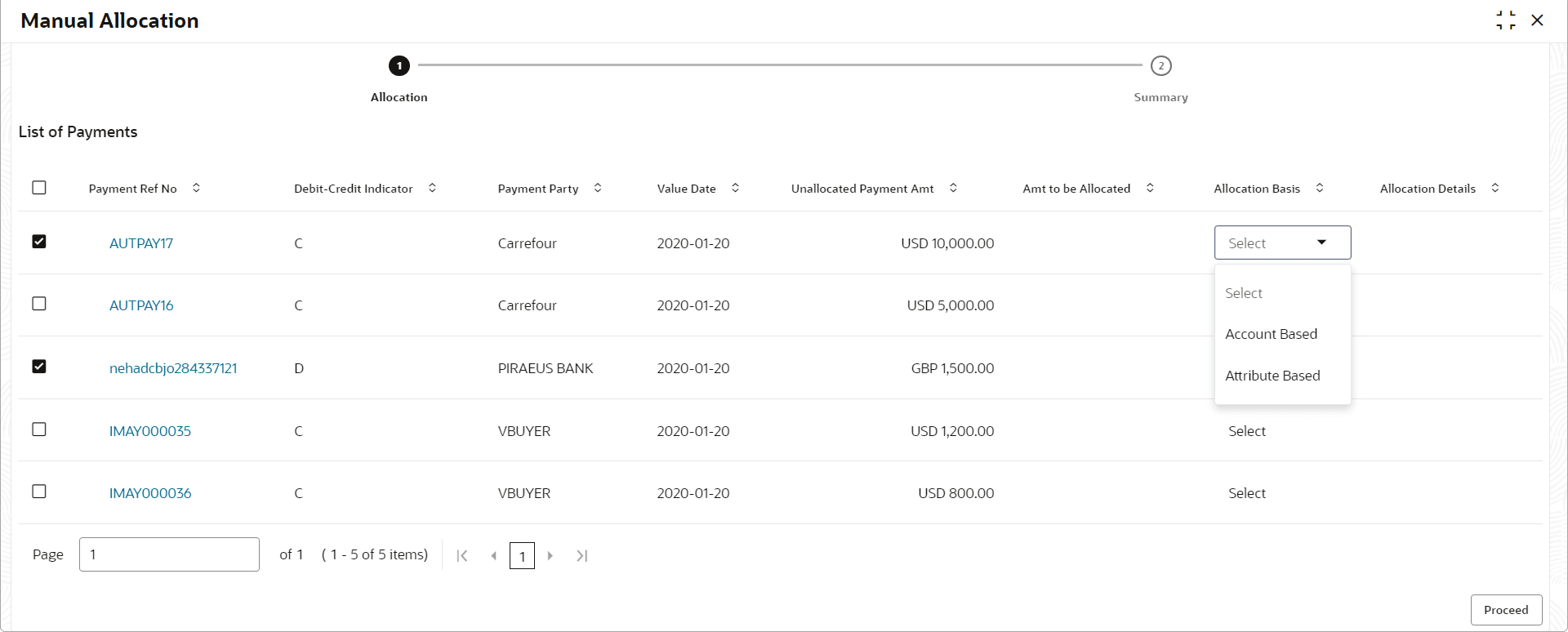

Based on the option selected from the Action list, perform the following steps:
If Allocate option is selected:
  1. Select the payment record and then under the Allocation Basis column, select the value to specify whether the allocation needs to be done based on account or attribute.
  2. In the Amt to be Allocated column, enter the amount to allocate.
  3. In the Allocation Details column, click the Rule Details link to specify the allocation details.

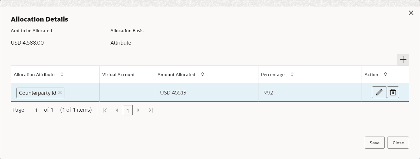

  4. Perform the following steps in the Allocation Details pop-up screen.
    1. Click Add icon to add a row for a virtual account and double click in each field of the row to add/edit the details.
    2. In the Allocation Attribute field, select the attribute to allocate the virtual account for. This field is displayed only for attribute based allocation selection.
    3. In the Virtual Account field, click the Search icon to fetch and then select the virtual account to be allocated. This fields is displayed only for account based allocation selection.
    4. In the Amount Allocated field, enter the amount to be allocated to the selected virtual account.
      The Percentage field is auto-calculated based on total amount to be allocated.
    5. In the Percentage field, enter the percentage of the amount being allocated.
      The Amount Allocated field is auto-calculated based on total amount to be allocated.
    6. If required, repeat the above steps to add more rows.
    7. Click Delete icon to remove a row or Edit icon () to modify the allocation details.
    8. Click Save to save the allocation details.
