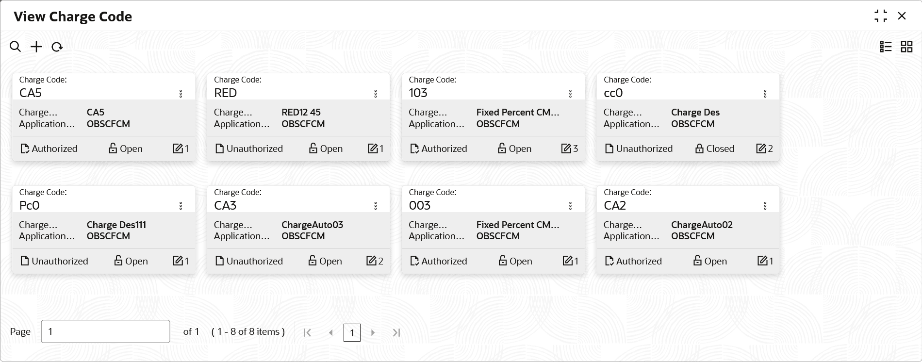

A tile is present for each record that has been created. The bottom portion of each record-tile displays the following:
  • The status, whether Authorized, Unauthorized, or Rejected.
  • Open or Closed.
  • The number of times the record has been submitted by the Maker added.

    The View Charge Code screen displays.
