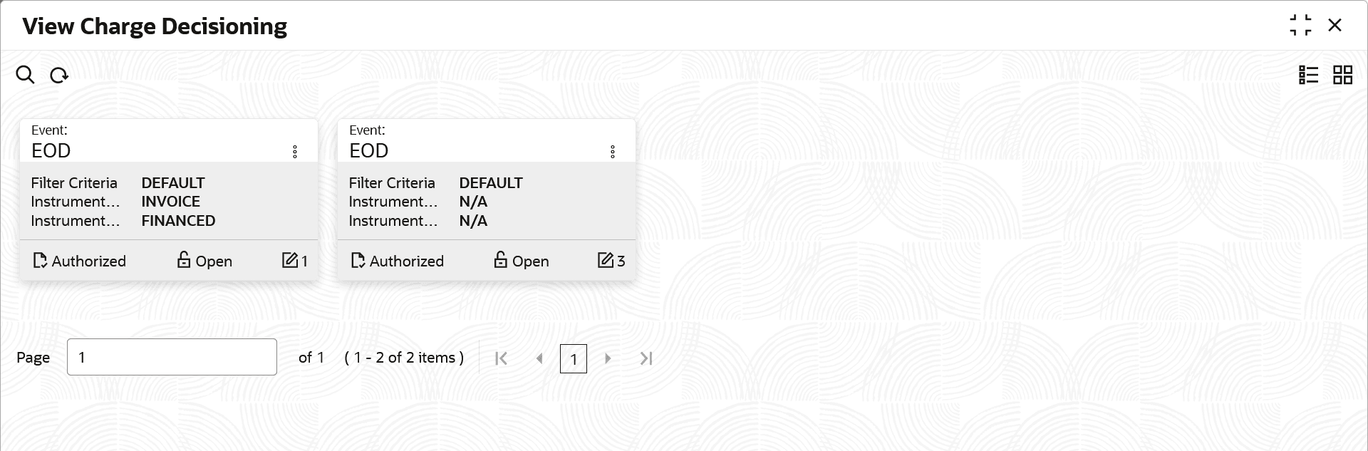

    The View Charge Decisioning screen displays.
    Figure 3-33 View Charge Decisioning
  4. Filter the records in the View screen:
    1. Click the Search icon to view the filters. The user can filter the records by Instrument Type, Instrument Status, Product, Credit/Debit Status, Event, Authorization Status and Record Status.
    2. Select the required filter criteria and click Search button to filter the records.
    3. Click Reset to reset the filter criteria.
  5. Click Refresh icon to refresh the records.
