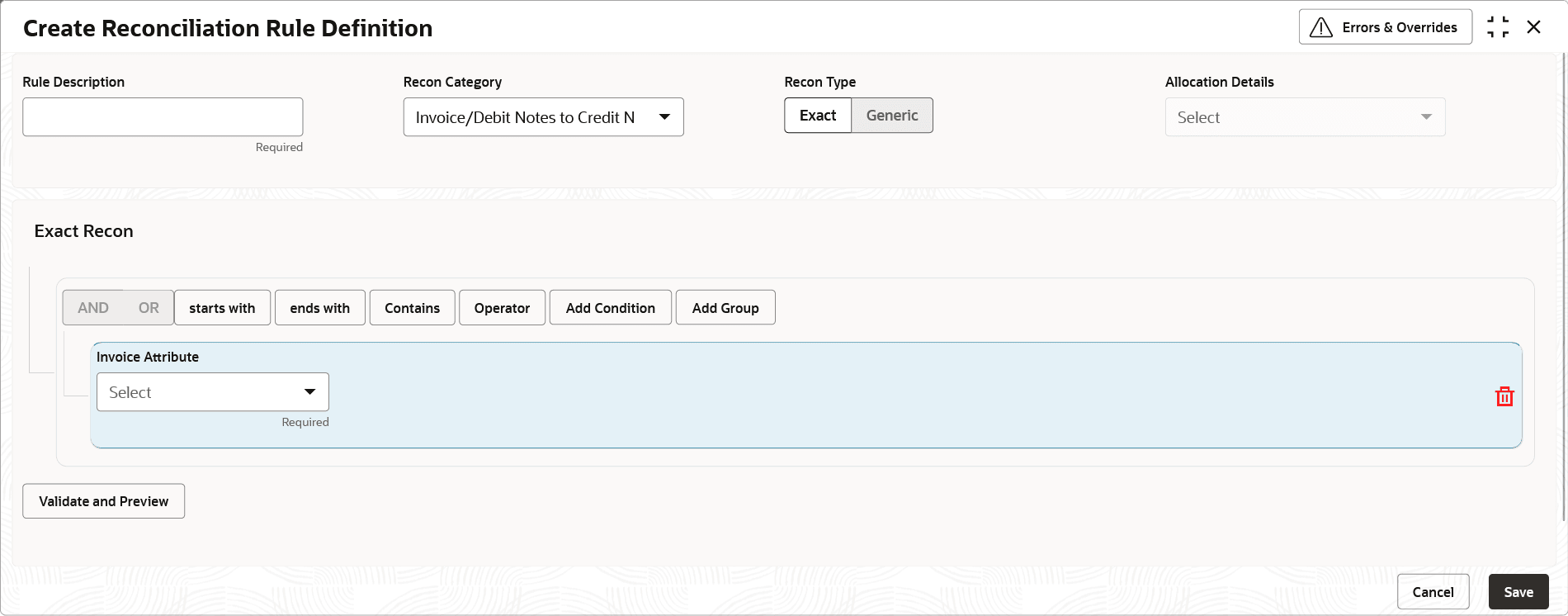

3.9.1.1 Create Exact Reconciliation Rule Definition
This topic describes the systematic instruction for setting up recon rule for Exact reconciliation category.
  1. On Home screen, click Receivables and Payables. Under Receivables and Payables, click Maintenance.
  2. Under Maintenance, click Reconciliation. Under Reconciliation, click Reconciliation Rule Definition
  3. Under Reconciliation Rule Definition, click Create Reconciliation Rule Definition.
    The Create Reconciliation Rule Definition screen displays.
    Figure 3-50 Create Exact Reconciliation Rule Definition
  4. Specify the fields on Create Exact Reconciliation Rule Definition screen.
    The fields marked as Required are mandatory.

  5. In the Exact Recon section, perform the following steps to create conditions or group of conditions:
    1. Click Add Condition to add a single line of condition. Or, click Add Group to add a group of conditions.
    2. Click inside the added container to view buttons for adding condition details.
      The Exact Recon - Condition/Group Details screen displays with the Fixed Value, Text between, Invoice/Payment Attributes, Cashflow/Payment Attributes, or Payment Attributes (depending on the selected recon category).

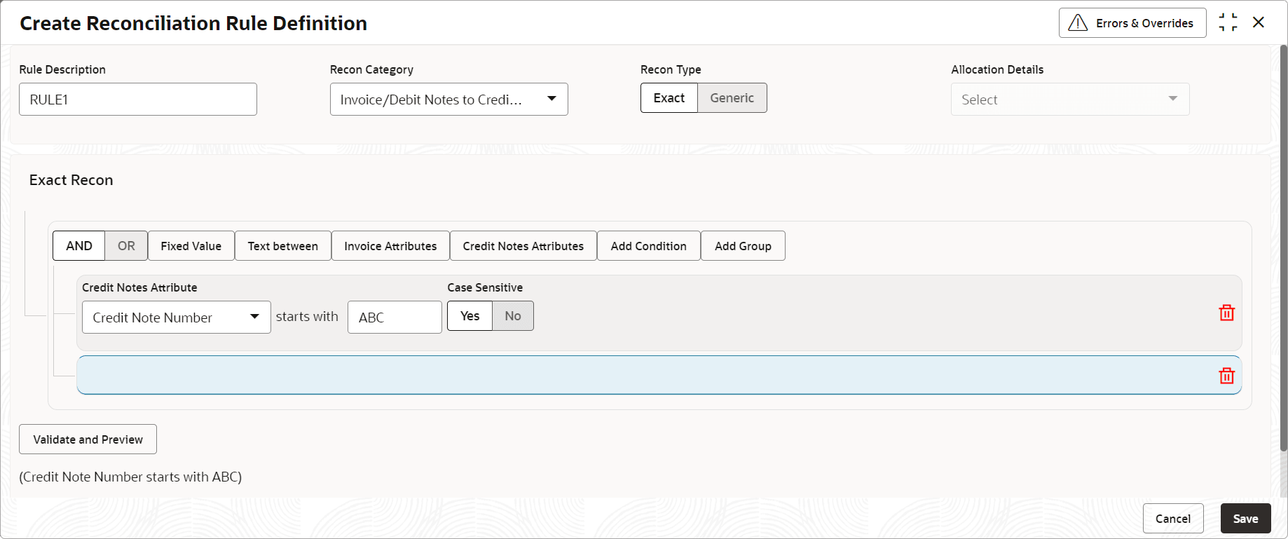

      Figure 3-51 Exact Recon - Condition/Group Details
    3. Click Fixed Values to define the value to be validated.

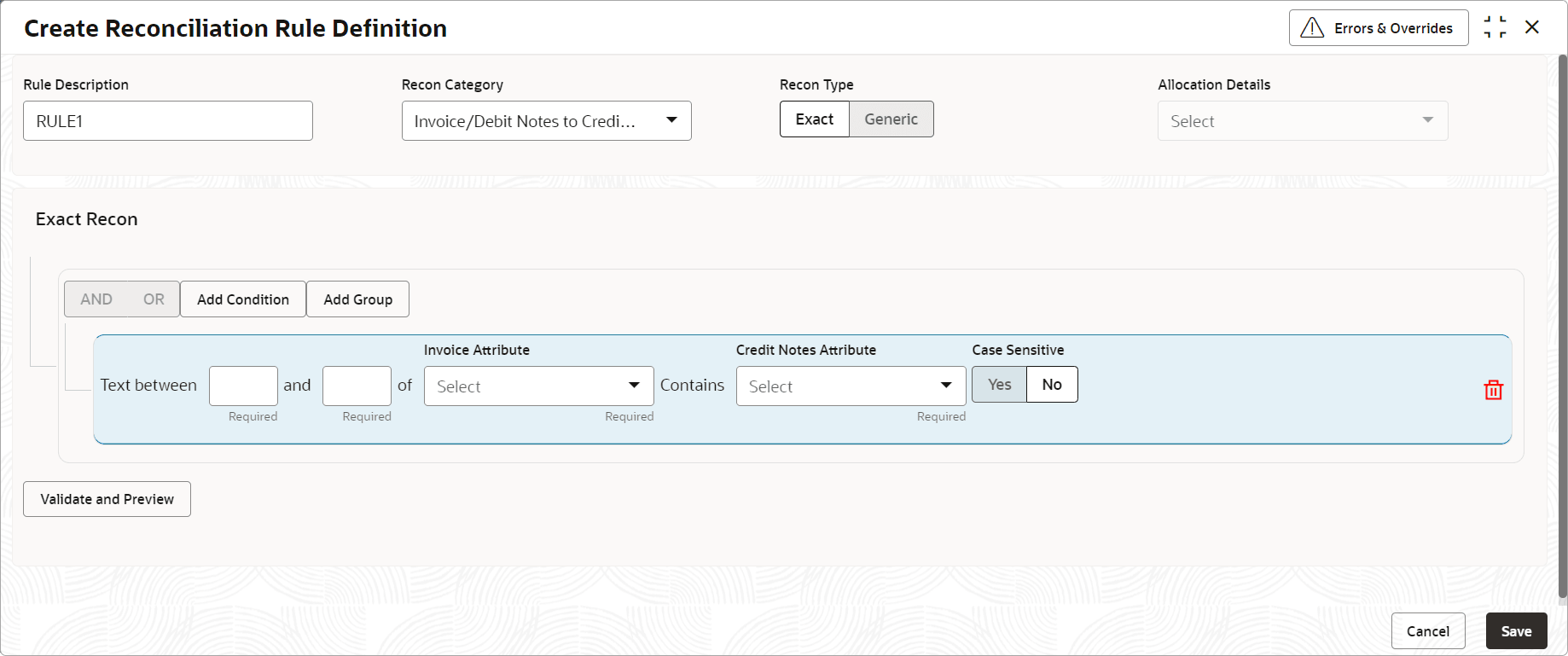

    4. Click Text between to define the range of text to be validated.
      The Exact Recon - Text Between screen displays.
      Figure 3-52 Exact Recon - Text Between
    5. Select the Case Sensitive as Yes or No to check the case sensitivity of the field value while recon execution.

    7. Click starts with, ends with and Contains to define the text to be validated based on each selection.
    8. Click Operator to specify how to compare defined values.
    9. Repeat the above steps to add more conditions and/or group of conditions.
    10. Click Delete icon to delete the condition located at the right-bottom of the condition container.
    11. Click AND / OR to define how many conditions or combination of conditions should be matched to execute the recon rule.
    12. Click Validate and Preview to check if the added conditions are valid or not.
