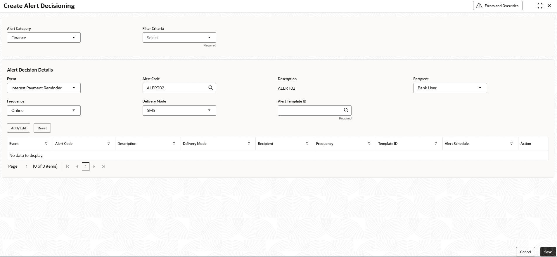

    The Create Alert Decisioning screen displays.
    Figure 2-36 Create Alert Decisioning
  4. Specify the fields on Create Alert Decisioning screen.
    The fields marked as Required are mandatory.
    Table 2-27 Create Alert Decisioning - Field Description
    Field Description
    Filter Criteria This section displays the following fields to select the category and filter criteria for creating an alert decision.
    Alert Category
    Select the category of the event for which the alert needs to be set.
    The available options are:
    • Limits
    • Finance
    Filter Criteria
    Select the appropriate filter criteria for specific application of alerts. The available options are:
    • Program Based
    • Product Based
    • Limit Party
    • Default
    Party
    Click the Search icon and select the limit party to set the alerts for.
    This field appears if the Filter Criteria is selected as Limit Party.
    Program
    Click the Search icon and select the program to set the alerts for.
    This field appears if the Filter Criteria is selected as Program Based.
    Product
    Click the Search icon and select the product to set the alerts for.
    This field appears if the Filter Criteria is selected as Product Based.
    Alert Decision Details This section displays the following fields to define the alert decision details for the selected filter criteria.
    Event
    Select the event for which the alert should be used. The list of events are displayed based on the selected category.
    If the Alert Category is selected as Finance, the following events are displayed in the drop-down list:
    • Finance Maturity
    • Finance Overdue
    • Loan Disburse
    • Loan Settle
    • Loan Partial Settle
    • Loan Payment Reminder
    • Finance Limit Exception
    • Loan Disburse In Progress
    • Loan Settle In Progress
    • Interest Collection Failure
    • Interest Payment Reminder
    • Interest Overdue
    • Finance Amendment
    • Finance Amendment In Progress
    If the Alert Category is selected as Limits, the following events are displayed in the drop-down list:
    • Limits Modification
    • Limits Sanction
    • Limit Expiry
    Alert Code Click the Search icon and select the required alert code. The list of alert codes are displayed as per selected combination of alert category and event.
    Description Displays the description of the selected alert code.
    Recipient Select the recipient to whom the alert should be sent.
    Frequency Select the frequency to send the alerts as follows:
    • Online - if the alert should be sent only when the event is generated.
    • Scheduled - if the alert should be sent one or more times prior to the generation of the event.
    Delivery Mode Select the mode through which the alert should be sent.
    Alert Template ID
    Click the Search icon and select the required alert template ID. The list of alert template ID's are displayed as per selected combination of frequency and delivery mode.
    This field is displayed only when Frequency is selected as Online and Delivery Mode is selected.
    Additional Phone
    Specify the additional phone number to send the alert on.
    This field is displayed only for the SMS modes of delivery.
    Additional Email
    Specify the additional email address to send the alert on.
    This field is displayed only for the Email delivery mode.
    Text Template for Email
    Click the Search icon and select the text template for an email alert.
    This field is displayed only for Online frequency and Email delivery mode.
    Attachment Template for Email
    Click the Search icon and select the attachment template for an email alert.
    Text Template for SMS
    Click the Search icon and select the text template for an SMS alert.
    This field is displayed only for Online frequency and SMS delivery mode.
    Text Template for Dashboard
    Specify the text template for the Dashboard alert.
    This field is displayed only for Online frequency and Dashboard delivery mode.

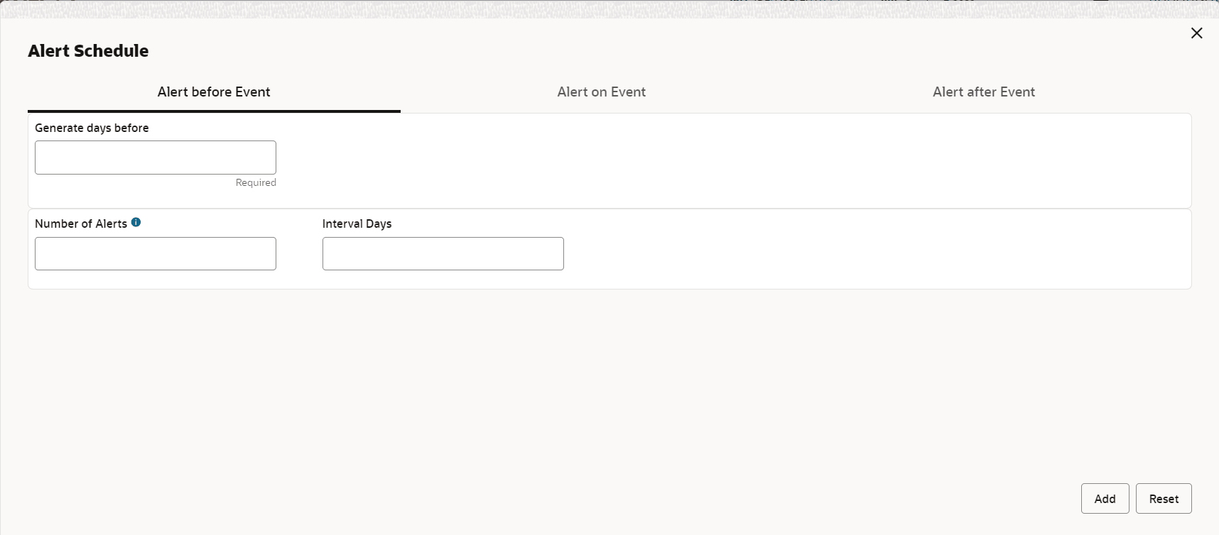

  5. On selecting the Scheduled option in the Frequency field, click the Alert Calendar icon to select the alert schedule.
    The Alert Schedule - Alert before Event popup screen displays.
    Figure 2-37 Alert Schedule - Alert before Event
  6. Specify the fields on Alert before Event tab.
    Table 2-28 Alert before Event - Field Description
    Field Description
    Generate days before Specify the number of days prior the event the alert to be sent.
    Number of Alerts Specify the total alerts to be sent.
    Interval Days Specify the interval in days between each alert.

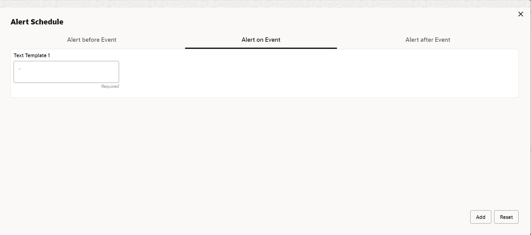

  7. In Alert Schedule pop-up screen, select the Alert on Event tab.
    The Alert Schedule - Alert on Event popup screen displays.
    Figure 2-38 Alert Schedule - Alert on Event
  8. Specify the fields on the Alert on Event tab.
    Table 2-29 Alert on Event - Field Description
    Field Description
    Text Template Specify the text for the alert.
    Attachment Template
    Click the Search icon to select the attachment template for the email alert.
    This field is displayed only if the Delivery Mode is selected as Email.

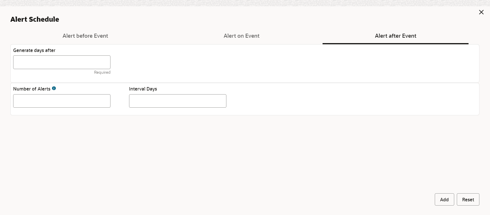

  9. In Alert Schedule popup screen, select the Alert after Event tab.
    The Alert Schedule - Alert after Event popup screen displays.
    Figure 2-39 Alert Schedule - Alert after Event
  10. Specify the fields on the Alert after Event tab.
    Table 2-30 Alert after Event - Field Description
    Field Description
    Generate days before Specify the number of days after the event the alert to be sent.
