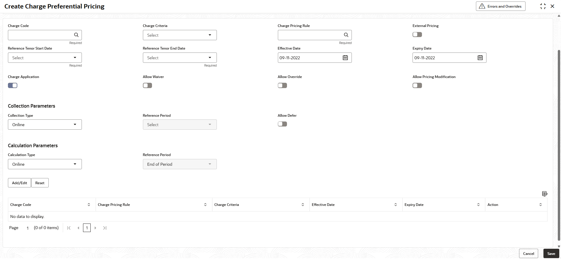

  3. Under Charge Preferential Pricing, click Create Preferential Pricing.
    The Create Preferential Pricing screen displays.
    Figure 2-53 Create Preferential Pricing
  4. Specify the fields on Create Preferential Pricing screen.
    The fields marked as Required are mandatory.
    Table 2-36 Create Preferential Pricing - Field Description
    Field Description
    Filter Criteria
    Select the appropriate filter criteria for specific application of accounting entries.
    Based on the selected criteria, the Program, Party ID, and Customer Category fields are displayed.
    Program
    Click the Search icon to select the program to map the preferential pricing to.
    This field is displayed only if the Filter Criteria is selected as Program.
    Party
    Click the Search icon to select the party to map the preferential pricing to.
    This field is displayed only if the Filter Criteria is selected as Party.
    Customer Category
    Click the Search icon to select the customer category.
    This field is displayed only if the Filter Criteria is selected as Customer Category.
    Charge Code Click the Search icon to select the charge code for pricing configuration.
    Charge Criteria
    Select the criteria on which charge should be calculated.
    The available options are:
    • Assignment Amount
    • Base Invoice Amount
    • Base PO Amount
    • Interest Collected
    • Invoice Acceptance Amount
    • Net Invoice Amount
    • Penalty on Principle Collected
    • Parent Charge Code
    • Penalty on Interest Collected
    • PO Acceptance Amount
    • Net PO Amount
    • Total Invoice Amount
    • Total PO Amount
    Parent Charge Code
    Select the parent charge code.
    This field is displayed if the Charge Criteria is selected as Parent Charge Code.
    Charge Pricing Rule Click the Search icon to select the charge pricing rule to be applied.
    External Pricing
    Switch the toggle ON to allow the user to configure the external pricing.
    By default, this toggle will be OFF.
    External Pricing System
    Select the external pricing system from the drop-down list for which the external charges needs to be configured.
    This field appears only if the External Pricing toggle is ON.
    External Pricing Identifier
    Specify the unique identifier for the external pricing system.
    External Pricing Identifier Description
    Specify the brief description about the external pricing identifier.
    Reference Tenor Start Date Specify which date should be considered to calculate the start of tenor duration.
    Reference Tenor End Date Specify which date should be considered to calculate the end of tenor duration.
    Effective Date Click the Calendar icon to select the start date of the preferential charge validity.
    Expiry Date Click the Calendar icon to select the end date of the preferential charge validity.
    Charge Application Switch the toggle ON to enable charge application.
    Allow Waiver Switch the toggle ON to enable manual charge waiving at the time of transaction processing.
    Allow Override Switch the toggle ON to enable overriding of the charge amount at the time of transaction processing.
    Allow Pricing Modification Switch the toggle ON to allow pricing rule modification at the time of transaction processing.
    Collection Parameters Displays the fields related to Collections Parameters.
    Collection Type
    User can determines how values related to the charge are collected or managed. Select how the pricing should be collected.
    • Periodic
    • Deferred
    • Online
    Reference Period If the default Collection Type is set to Online, the reference period shows as End of Period.
    Allow Defer Switch the toggle ON to defer the selected charge during transaction.
    Frequency
    Select the frequency of charge collection.
    • Daily
    • Weekly
    • Monthly
    • Half Yearly
    This field is displayed only if the Collection Type is selected as Periodic.
    Reference Period
    Select when the collection should take place for the selected frequency.
    For monthly or half-yearly frequency, the collection can take place either at the beginning of the period (BOP) or end of the period (EOP).
    For weekly frequency, the collection can happen on a specific day of the week.
    Units
    Specify whether the charge collection should take place as per units of specified frequency.
    Collection Event Select the collection event from the drop-down. The available options are:
    • Accept
    • Assignment
    • Disbursement
    • Paid/Recon
    • Recon
    • Settlement
    This field is displayed only if the Collection Type is selected as Deferred or when Allow Defer toggle is switched ON.
    Calculation Parameters Displays the fields related to Calculation Parameters.
    Calculation Type
    Specifies the method or approach for calculating the charge. Select how the pricing should be calculated.
    • Online
    Frequency
    Select the frequency of charge calculation.
    • Daily
    • Weekly
    • Monthly
    • Half Yearly
    This field is displayed only if the Calculation Type is selected as Periodic.
    Reference Period
    Select when the calculation should take place for the selected frequency.
    For monthly or half-yearly frequency, the calculation can take place either at the beginning of the period (BOP) or end of the period (EOP).
    For weekly frequency, the calculation can happen on a specific day of the week.
    Units
    Specify whether the charge calculation should take place as per units of specified frequency.
    Charges Grid Displays the details of the preferential pricing added as an entry in this grid.
