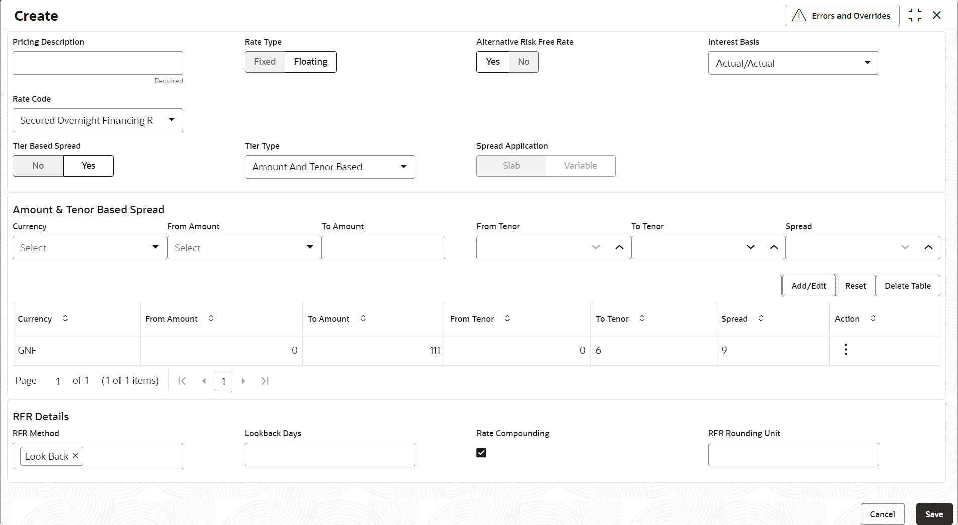

    The Create Interest Pricing screen displays.
    Figure 2-58 Create Interest Pricing
  4. Specify the fields on Create Interest Pricing screen.
    The fields marked as Required are mandatory.

  5. If Alternative Risk Free Rate field is set to Yes, then RFR Details section gets displayed.
    1. Click the RFR Method field to select the applicable risk free rate method.
    2. If Lockout or Look Back methods are selected, specify the values accordingly in the respective fields.
    3. Click the Rate Compounding checkbox to specify the risk free rate rounding value, if applicable.
  6. If the Tier Based Spread field is set to Yes, then select the required Tier Type list.
    1. Based on the Tier Type selected, specify the tier and spread details.
    2. Click Add/Edit to add the spread details to the grid.
    3. Repeat the steps to add more tiers, if required.
    4. Click Reset to clear the entered values.
    5. Select the record in the grid and then click Options icon in the Action column.
    6. Click Edit to edit the selected row.
    7. Click Delete to delete the selected row.
  7. Click Save to save the record and send it for authorization.
