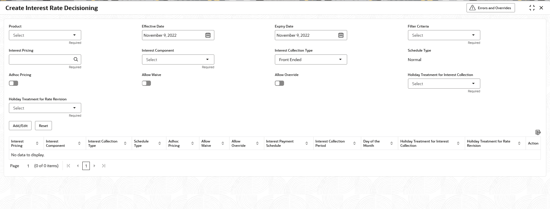

    The Create Interest Rate Decisioning screen displays.
    Figure 2-60 Create Interest Rate Decisioning
  4. Specify the fields on Create Interest Rate Decisioning screen.
