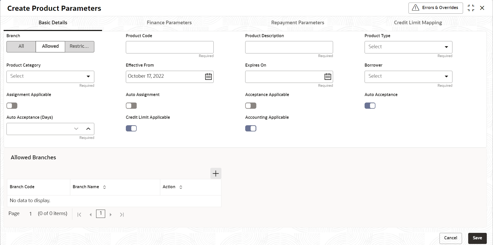

    The Create Product Parameters - Basic Details screen displays.
    Figure 2-10 Create Product Parameters - Basic Details
  3. On Basic Details tab, specify the fields to configure the basic details for the product being created.
    The fields marked as Required are mandatory.
    For more information on the fields, refer to the field description table.
    Table 2-9 Basic Details - Field Description
    Field Name Description
    Branch
    Select the option under which the product is to be created.
    • All - Product defined is applicable to all the branches.
    • Allowed - Product defined is applicable to only the selected branches.
    • Restricted - Product defined is applicable to all the branches except the selected branches.
    You can select only one of the options at any given time.
    Product Code Specify a unique code to identify the product.
    Product Description Specify a description for the product.
    Product Type Select whether the product is Buyer Centric or Supplier Centric.
    Product Category Select the underlying instrument category, whether Invoice or Purchase Order.
    Effective From
    Click the Calendar icon to select the date from when the product is active.
    If the field is left blank, then the branch date is considered by default.
    Expires On Click the Calendar icon to select the date up to when the product is valid.
    Borrower Select the borrower to be associated with the product, whether Anchor or Spoke.
    Assignment Applicable Switch the toggle ON if assignment on invoice is applicable for financing.
    Auto Assignment Switch the toggle ON if the assignment is to be performed automatically post invoice upload.
    Acceptance Applicable Switch the toggle ON if acceptance on invoice is applicable for financing.
    Auto Acceptance Switch the toggle ON if the acceptance is to be performed automatically post invoice upload.
    Auto Acceptance (Days) Specify the number of days after which the instrument is automatically deemed as accepted.

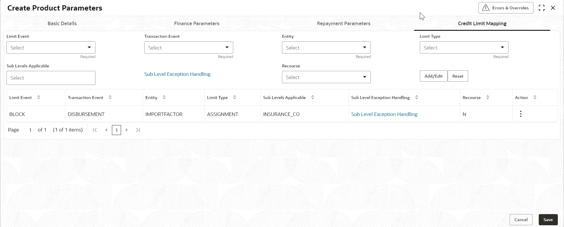

    Credit Limit Applicable
    Switch the toggle ON to map credit limits to the product.
    If you enable this toggle, the Credit Limit Mapping tab appears. You can map the limit type and related entities.
    Accounting Applicable Switch the toggle ON if accounting is applicable.
    On maintenance screens where product selection is required, only products relevant to the logged-in user's branch will be displayed.
    For existing implementations where the application is used in a single branch, the existing products can be mapped to either ALL or Allowed branch options at the discretion of the bank or Financial Institution during upgrade to current release version.
    For existing implementations where the application is used in multiple branches, the existing products must be mapped to respective branches under Allowed branch option at the discretion of the bank or Financial Institution during upgrade to current release version.
  4. On selection of Allowed or Restricted branch type, the Allowed/Restricted Branches section displays. Perform the below actions to add branch(es) for the product being created.
    1. Click Add to add a row.
    2. In the Branch Code field, click Search.
      The Branch Code pop-up screen displays.
    3. Enter the partial or complete code/name of the branch in the respective fields.
    4. Click Fetch. The relevant branch(es) appears.
    5. Select the required branch.
    6. Click Save in the Action column to save the row.
    7. Click Edit in the Action column to edit the row or click Delete in the Action column to delete the row.

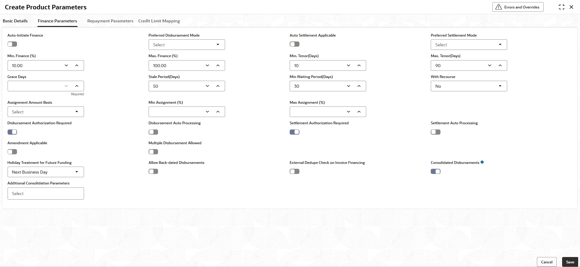

  5. Click Finance Parameters tab.
    The Create Product Parameters - Finance Parameters screen displays.
    Figure 2-11 Create Product Parameters - Finance Parameters
  6. On Finance Parameters tab, specify the fields to configure the finance parameters for the product being created.
    Table 2-10 Finance Parameters - Field Description
    Auto-Initiate Finance Switch the toggle ON to enable automated financing (Straight Through Processing) of instruments such as invoices, debit notes, and so on.
    Preferred Disbursement Mode
    Select the preferred mode of disbursement for this product.
    The available options are:
    • Account Transfer
    • CBT – Cross Border Transfer
    • Cheque
    • EFT
    This field is mandatory when Auto Initiate Finance is enabled.
    Auto Settlement Applicable Switch the toggle ON to enable automated settlement (repayment) for this product.
    Preferred Settlement Mode
    Select the preferred mode of settlement for this product.
    • Account Transfer
    • Cheque
    • EFT
    Min. Finance (%) Specify the minimum finance percentage allowed for financing a transaction of this product.
    Max. Finance (%) Specify the maximum finance percentage allowed for financing a transaction of this product.
    Min. Tenor (Days) Specify the minimum tenor allowed for financing a transaction of this product.
    Max. Tenor (Days) Specify the maximum tenor allowed for financing a transaction of this product.
    Grace Days
    Specify the number of grace days.
    This is the period post the finance due date, within which the finance can be settled without penalty.
    Stale Period (Days)
    Specify the number of stale days.
    This is the period post the invoice date, after which the invoice becomes stale and will not be financed automatically any more for this product.
    Min Waiting Period (Days) Specify the minimum period up to which the finance cannot be closed for this product.
    With Recourse Select Yes to specify that the finance is allowed with recourse, else select No.
    Assignment Amount Basis
    Select the assignment amount type for financing a transaction of this product.
    • Acceptance Amount
    • Net Invoice Amount
    Min. Assignment (%) Specify the minimum percentage of the assignment amount allowed for financing a transaction of this product.
    Max. Assignment (%) Specify the maximum percentage of the assignment amount allowed for financing a transaction of this product.
    Disbursement Auth Required Switch the toggle ON to enable authorization for STP disbursement transactions.
    Disbursement Auto Processing Switch the toggle ON to enable automatic processing of disbursement transactions.
    Settlement Auth Required Switch the toggle ON to enable authorization for STP finance settlement transactions.
    Settlement Auto Processing Switch the toggle ON to enable automatic processing of settlement transactions.
    Amendment Applicable Switch the toggle ON to enable amendment for this product.
    Amendment Auth Required Switch the toggle ON to enable authorization for the finance amendment transactions.
    Amendment Auto Processing Switch the toggle ON to enable automatic processing of finance amendment transactions.
    Multiple Disbursement Allowed Switch the toggle ON to enable multiple finance disbursements for an invoice.
    Holiday Treatment for Future Funding
    Select the day to consider if the finance disbursement falls on a holiday.
    • Next Business Day
    • Previous Business Day
    Allow Back-Dated Disbursements Switch the toggle ON to enable the back-dated disbursements for this product.
    Conditions for Marking Invoice Paid
    Select whether the financed invoice should be marked as Paid during Disbursement or during Settlement.
    This field appears only when the Buyer is the borrower, for which the Product should have one of the following configurations:
    • Product Type = Buyer Centric; Product Category = Invoice; Borrower = Anchor
    • Product Type = Supplier Centric; Product Category = Invoice; Borrower = Spoke
    The options available in this field are:
    • Disbursement:
      • If the invoice is financed to the maximum finance percentage, then during disbursement it is marked as Paid. The outstanding invoice amount, if any, is handled as per margin handling settings.
      • If the invoice is not financed to the maximum finance percentage, then during disbursement, the invoice is marked as Partially Paid. Once the outstanding invoice amount is settled based on margin handling settings, then the invoice is marked as Paid.
    • Settlement:
      • If an invoice is financed to the maximum finance percentage, and if all underlying finances are fully paid off during settlement, then the invoice is marked as Paid.
      • If the invoice is not financed to the maximum finance percentage, then during settlement the invoice is marked as Partially Paid. It is then marked as Paid, after the outstanding payment is made.
    External Dedupe Check on Invoice Financing When this feature is ON, it will check for duplicate financing with the Invoice Registry. If it is OFF, the check will not happen.
    Consolidated Disbursements This field determines whether financing is processed in batches or per instrument. When set to Yes, instruments will be grouped together under a single financing, provided they meet the necessary criteria. If set to No, each instrument will be financed individually, with consolidation occurring only if the request count exceeds the specified threshold.
    Additional Consolidation Parameters
    Specify additional fields/keys used to determine how disbursements are consolidated (grouping criteria).
    Note: When the Consolidated Disbursements field is Yes, additional consolidation parameters listed below will be pre-selected in this field.
    • External Account Number
    • Charge Code
    • Amount Type
    Pre-Shipment settlement gets initiated only if the Auto Settlement Applicable is enabled.
    For existing implementations, Conditions for Marking Invoice Paid is defaulted to Null i.e., the invoice gets marked as Paid if an invoice payment is directly received. Banks or Financial Institutions should modify the fields as per the table to achieve a different functionality, if required.

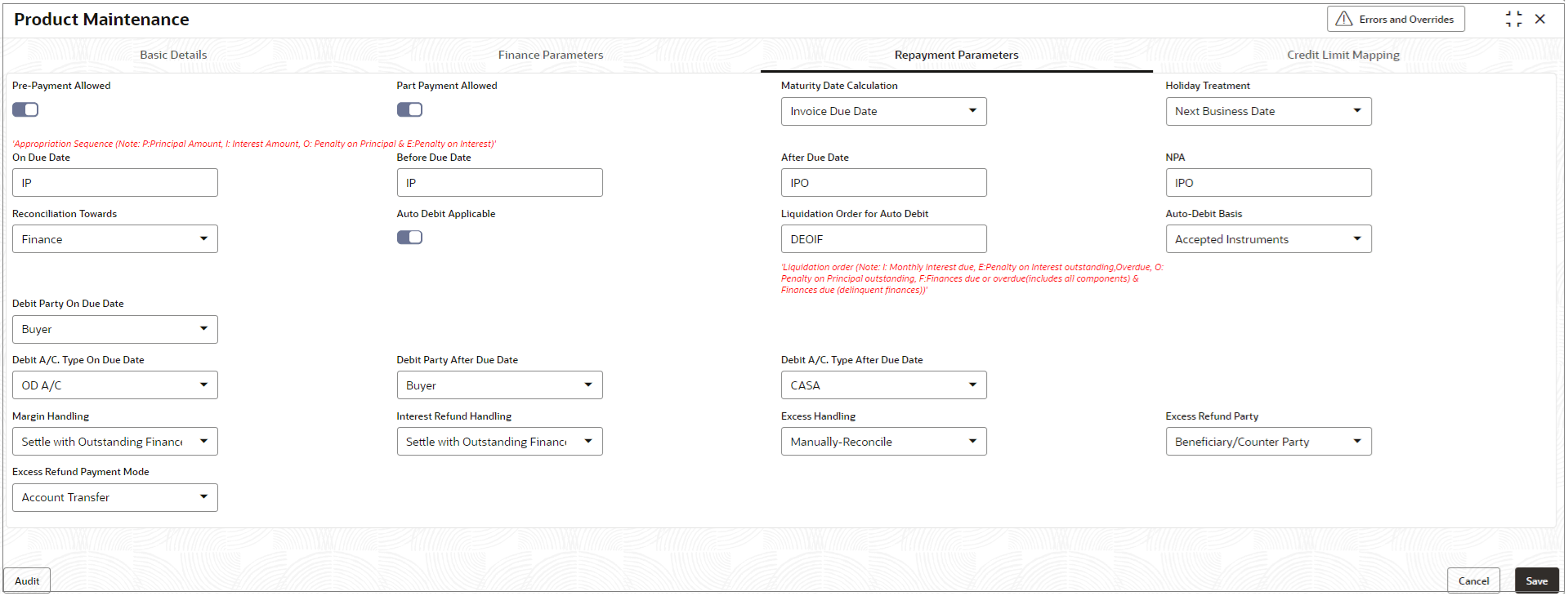

  7. Click Repayment Parameters tab.
    The Create Product Parameters - Repayment Parameters screen displays.
    Figure 2-12 Create Product Parameters - Repayment Parameters
  8. On Repayment Parameters tab, specify the fields to configure the repayment parameters for the product being created.
    Table 2-11 Repayment Parameters - Field Description
    Pre-Payment Allowed Switch the toggle ON if prepayment is allowed for finances availed under this product. That is part or full repayment before the finance due date.
    Part Payment Allowed Switch the toggle on if part payment is allowed for finances availed under this product.
    Maturity Date Calculation
    Select the basis for calculating the maturity date of the finance.
    • When Invoice option selected in Product Category:
      • Invoice Due Date
      • Business Date + Max Tenor
      • Invoice Due Date + Max Tenor
      • Payment Due Date
    • When PO option selected in Product Category:
      • PO Date
      • PO Date + Max Tenor
    Holiday Treatment
    Select the value if the maturity date falls on a holiday for this product.
    • Next Business Date
    • No Change
    • Previous Business Date
    On Due Date
    Specify the appropriation sequence for the repayment amount if the payment is received on due date.
    • P – Principal Amount
    • I – Interest Amount
    • E – Penalty on Interest
    Before Due Date
    Specify the appropriation sequence for the repayment amount if the payment is received before due date.
    After Due Date
    Specify the appropriation sequence for the repayment amount if the payment is received after due date.
    • O - Penalty on Principal
    NPA
    Specify the appropriation sequence for the repayment amount if the payment is received after the finance has turned NPA.
    Reconciliation Towards Select whether the reconciliation is towards Invoice or Finance.
    Auto Debit Applicable Switch the toggle ON if the account should be auto debited on the finance/invoice due date for this product.
    Liquidation Order for Auto Debit
    Specify the default auto-debit liquidation order to be applied in case partial funds are debited from the payment party on auto-debit.
    • E - Penalty on Interest Outstanding
    • O - Penalty on Principal Outstanding
    • I – Monthly Interest Due
    • D - Overdue Finance (Delinquent finances)
    • F - Finance Due or Overdue (Outstanding Finances)
    This field is mandatory if Auto Debit Applicable is enabled.
    Auto-Debit Basis
    Select the basis on which of the instruments should be auto-debited on the finance/invoice due date.
    • Accepted Instruments - The account is auto-debited when the invoice/debit note is in the Accepted status, and Reconciliation Towards is set to Invoice.
    • Financed Instruments - The account is auto-debited when the invoice/debit note is financed, irrespective of acceptance status, and Reconciliation Towards is set to Invoice.
    • Accepted or Financed Instruments - The account is auto-debited when the invoice/debit note is either accepted or financed, and Reconciliation Towards is set to Invoice.
    • All Instruments - The account is auto-debited when Reconciliation Towards is set to Invoice, irrespective of whether the invoice/debit note is accepted or financed.
    This field is displayed only if Auto Debit Applicable is enabled. By default, All Instruments is selected.
    Debit Party On Due Date
    Select the party from whose account the amount should be debited.
    • Buyer
    • Supplier
    Debit A/C. Type On Due Date
    Select the account Type to be debited.
    • CASA
    • OD A/C
    Debit Party After Due Date
    Select the party from whose account the amount should be debited, if the business date is greater than finance maturity date for this product.
    • Buyer
    • Supplier
    Debit A/C. Type After Due Date
    Select the account type to be debited if the business date is greater than finance maturity date for this product.
    • CASA
    • OD A/C
    Margin Handling
    Select how the margin should be handled.
    • Auto-Settle and Refund to Supplier
    • Manually Settle O/s Finances
    • Refund to the Supplier
    • Settle with Outstanding Finances
    This field is displayed only if Product Category is selected as Invoice in Basic Details tab.
    Margin Payment Mode
    Select the mode of payment for the margin amount.
    • Account Transfer
    • Cheque
    • EFT
    This field is displayed only if Margin Handling is selected as Refund to the Supplier or Auto-Settle and Refund to Supplier.
    Interest Refund Handling
    Select how the interest refund should be handled.
    • Auto-Settle and Refund to IBP
    • Refund to the Interest Bearing Party
    Interest Refund Payment Mode
    Select the mode of payment for the interest refunds.
    • Account Transfer
    • Cheque
    • EFT
    This field is displayed only if Interest Refund Handling is selected as Refund to the Interest Bearing Party or Auto-Settle and Refund to IBP.
    Excess Handling
    Select how the excess payment made towards settlement of outstanding invoice/finance, should be handled.
    • Auto-Reconcile
    • Auto-Reconcile and Refund
    • Manually-Reconcile
    • Refund to beneficiary or payment party
    Excess Refund Party
    Select the party to refund the excess amount to.
    • Beneficiary/Counter Party
    • Payment Party
    Excess Refund Payment Mode
    Select the mode of payment for the excess payment refund.
    • Account Transfer
    • Cheque
    • EFT
  9. Click Credit Limit Mapping tab.
    The Create Product Parameters - Credit Limit Mapping screen displays.
    Figure 2-13 Credit Limit Mapping
  10. On Credit Limit Mapping tab, specify the fields to configure the credit limits for the product being created. This tab is displayed only if Credit Limit Applicable is enabled in the Basic Details tab.
    Table 2-12 Credit Limit Mapping - Field Description
    Limit Event Select the event for which the limit is to be applied.
    Transaction Event Select the transaction event for which the limit event is to be applied.
    Entity Select the main entity for which the limit is to be applied.
    Limit Type Select the type of limit.
    Sub Levels Applicable Select the applicable sub-level entities/nodes.
    Recourse Select whether recourse is applicable.

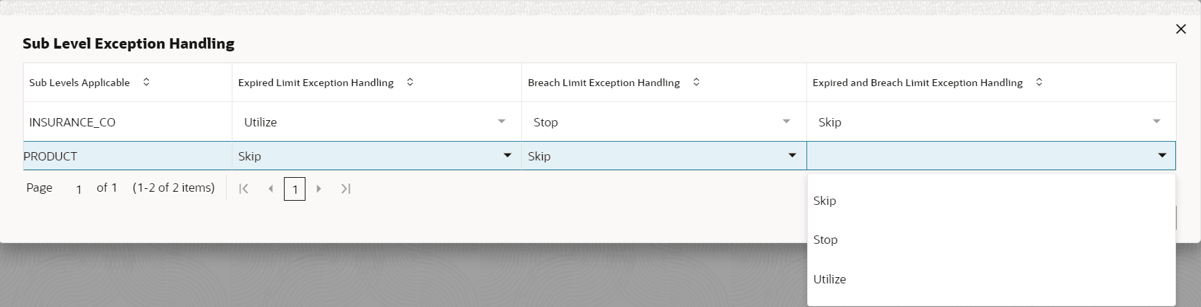

  11. Click Sub Level Exception Handling link to specify the exception handling behavior for the sub-level entities/nodes.
    The Sub Level Exception Handling pop-up screen displays.
    Figure 2-14 Sub Level Exception Handling
  12. On Sub Level Exception Handling screen, specify the fields to set the exception handling behavior.
    Table 2-13 Sub Level Exception Handling - Field Description
    Sub Levels Applicable Displays the selected sub-level entities/nodes.
    Expired Limit Exception Handling
    Select the exception handling behavior when the limit is expired.
    • Skip
    • Stop
    • Utilize
    Breach Limit Exception Handling
    Select the exception handling behavior when the limit is breached.
    • Skip
    • Stop
    • Utilize
    Expired and Breach Limit Exception Handling
    Select the exception handling behavior when the limit is both expired and breached.
    • Skip
    • Stop
    • Utilize
    1. Select the required exception behaviors and click Ok to save the details.
  13. Click Add/Edit to add the details to the grid.
  14. Click Reset to clear the selected values, if required.
  15. Perform the following steps to act on the records in the grid.
    1. Click Options icon in the Action column to edit or delete the row.
  16. Click Save to save the record and send it for authorization (if applicable).
