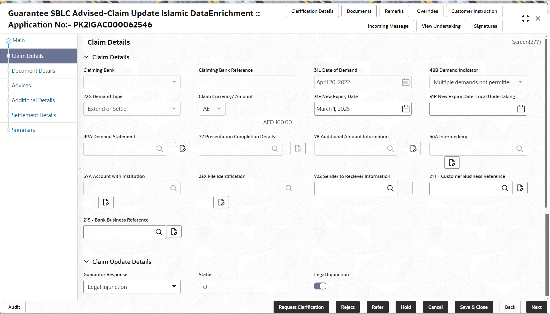

2.3.2 Claim Details
This topic provides the systematic instructions to capture the additional details in Data Enrichment stage of Guarantee SBLC Advised Claim Update Islamic process.
- On Claim Details screen, specify the fields.
Figure 2-9 Claim Details
Description of the illustration declaimdetails.pngFor more information on fields, refer to the field description table below.

Customer Business Reference Specify the Customer Business Reference number or click 'Search' icon to search and select the Customer Business Reference number. Bank Business Reference Specify the Bank Business Reference number or click 'Search' icon to search and select the Bank Business Reference number. Claim Update Details Specify the Claim Update details based on the description in the following table: Guarantor Response Select the guarantor response from the drop-down. The values are: - Legal Injunction
- Reject Claim
- Settle Claim
- Extension
Status Read Only field. System with default status based on the user acceptance or rejection of the extension request.
If the applicant has accepted the extension, the status of the claim update should be Extension – Accepted and handoff from Oracle Banking Trade Finance Process Management Cloud Service should be provided to the Guarantee Amendment function id in OBTF.
If the applicant has rejected the extension, the status of the claim update should be Extension – Rejected and handoff from Oracle Banking Trade Finance Process Management Cloud Service should be provided to the Guarantee Claim Update function id in OBTF.
If the applicant has provided the legal injunction, the status of the claim update should be Injunction and handoff from Oracle Banking Trade Finance Process Management Cloud Service should be provided to the Guarantee Claim Update function id in OBTF.
If the bank has found discrepancy in the claim, user selects Invalid Claim. The status should be Rejected and handoff from Oracle Banking Trade Finance Process Management Cloud Service should be provided to the Guarantee Claim Update function id in OBTF.
Legal Injunction User can update the claim status if there is any legal injunction in processing the claim. This option is enabled if Legal Injunction and Reject Claim is selected in Guarantor Response field.
Reason for Refusal Specify the the reason for refusal. This field appears if you select Reject Claim option in Guarantor Response field.
Disposal of Documents Read Only field. System defaults the mode in which the documents have to be disposed in case of rejection of claim.
Sender to Receiver Information Specify the details of sender to receiver Information. This field appears if you select Reject Claim option in Guarantor Response field.
