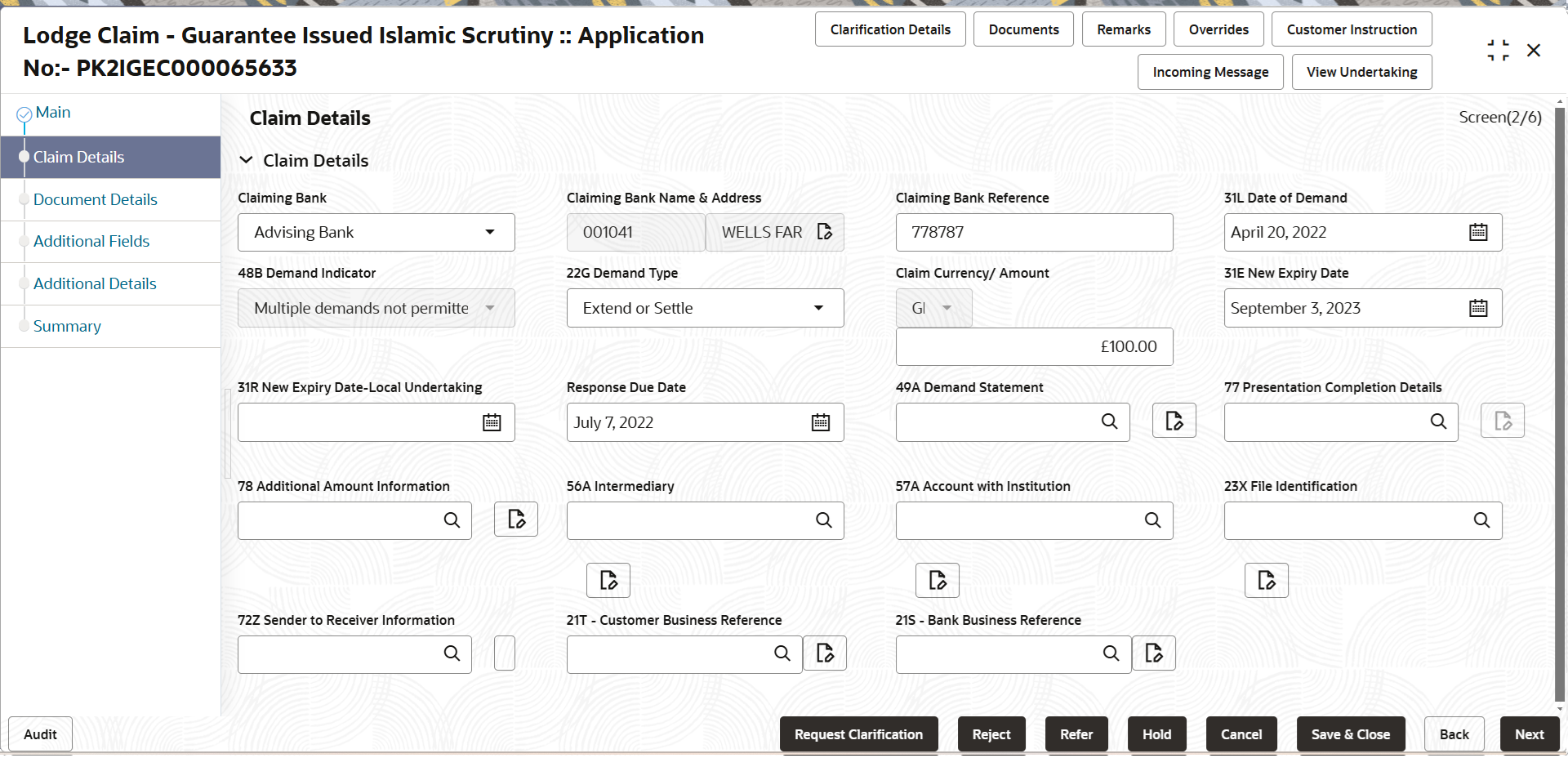

2.3.2 Claim Details
This topic provides the systematic instructions to capture the additional details in Scrutiny stage of Lodge Claim Guarantee Issued Islamic process.
- On Claim Details screen, specify the fields.
Figure 2-9 Claim Details
Description of the illustration scrutinyclaimdetails.pngFor more information on fields, refer to the field description table below.

Field Description Claiming Bank Select the Claiming Party from whom the claim under the Bank Guarantee issued is received while lodging the Guarantee Claim. The options are:
- Advising Bank
- Others
Claiming Bank Name & Address This field is read only and displays the claiming bank details, if Advising Bank option is selected in Claiming Bank field. Click the Search icon to search and select the claiming bank customer id from the look-up, if it is a customer of the bank and if not select the WALKIN id and manually capture Bank name and address.
This field is editable if Others option is selected in Claiming Bank field.
This field is mandatory if Claiming Bank field has values.
Claiming Bank Reference Specify the claiming bank reference details, if the claimed is not received from Beneficiary. User can specify the Transaction Reference number from MT 765. In case of STP of incoming MT 765, system to populate the details from incoming MT 765.
If the claim is received from the beneficiary, this field will not be editable.
Date of Demand Specify the date on which the demand is issued by the beneficiary. In case of STP of Incoming MT 765, the System to populate the value in tag 31L, Date of Demand from incoming MT 765.
Demand Indicator Read Only field. System defaults value from Guarantee /SBLC Issuance.
Select the linkage type.Demand Type Select the type of demand. The values are: - Extend or Settle
- Settle
In case of STP of Incoming MT 765, the demand type is defaulted from the incoming MT 765 message.
In case of Non-Online, User can input the value as per claim.
Claim Currency/ Amount Specify the claim amount. New Expiry Date Specify the new expiry date, if Demand Type field is Extend or Settle. New Expiry Date-Local Undertaking Specify or select the new expiry date/local Undertaking. Response Due Date System defaults value from Guarantee /SBLC Issuance, if Demand Type field is Settle. The user can change the value. Specify the response due date, if Demand Type field is Extend or Settle
Demand Statement Specify the narrative text that constitutes the demand. field displays the limit currency, when the user select the Liability Number. The codes can be:- COMP: Complete demand, no other documentation to accompany or follow this message.
- INCP: Incomplete demand, supporting documentation to be presented separately.
In case of STP of Incoming MT 765, this field is defaulted from the incoming MT 765 message. In case of Non-Online, User can specify the value as per claim.
Presentation Completion Details Specify the presentation of completion details, if demand statement is provided. This field specifies information about the presentation documentation. If the presentation is incomplete, this must specify how the presentation will be completed. In case of STP of Incoming MT 765, this field is defaulted from the incoming MT 765 message.
Additional Amount Information Specify the details on additional amount in this field. In case of STP of Incoming MT 765, this field is defaulted from the incoming MT 765 message.
Intermediary Specify the Intermediary bank details or click Search to search and select the Intermediary bank details from the look-up. This field specifies the financial institution through which the amount claimed must pass to reach the account with institution.
Account with Institution Specify the details of Account with Institution or click Search to search and select the Account with Institution from the look-up. This field specifies the financial institution at which the amount claimed is to be settled.
File Identification Click Search to search and select the file identification FFT Code from the look-up. Sender to Receiver Information Click Search to search and select the sender to receiver information FFT Code from the look-up. Customer Business Reference Click Search to search and select the customer business reference from the look-up. Bank Business Reference Click Search to search and select the bank business reference from the look-up. - Click Next.The task will move to next data segment.
