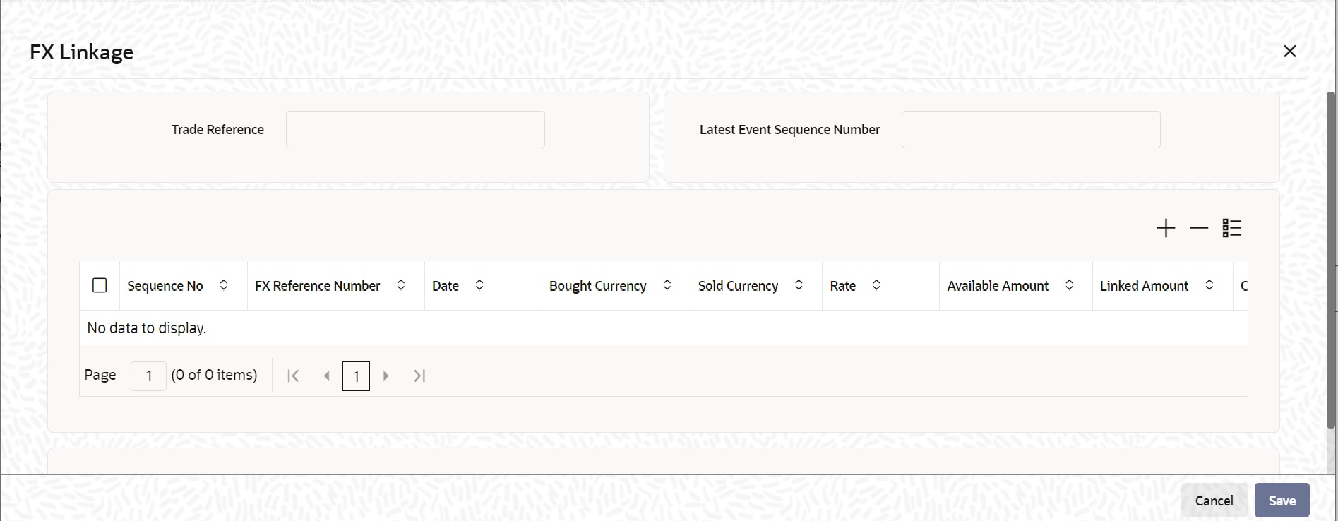

Navigate to Bills and Collection Contract Detailed screen.
- On the Bills and Collection Contract Detailed screen,
click FX Linkage Details.FX Linkage screen is displayed.
This link invokes a screen in which you can link a BC involving a specific counterparty with FX deals involving the same counterparty.
You can link one or more FX deals to a bill. The value of an FX deal should not exceed the value of the bill it hedges.
If you link several FX deals to a bill, the total value of all the deals should not exceed the bill amount.Table 5-21 FX Linkage - Field Description
Field Description Sequence No System generates the ‘Sequence No’ for linked FX contracts sequentially FX Reference no Indicates FX deal reference no. from treasury system. Date Indicates FX deal value date. FX Value date should be greater or equal to BC Maturity Date. BOT/SOLD Currency LC contract currency should be BOT currency of the FX transaction in case of an export LC or the SOLD currency in case of an Import LC. Bought Currency: Presents FX Deal Bought Currency. Incase of export contract, LC contract currency should be same FX Bought Currency.
Sold Currency: Presents FX Deal Bought Currency. Incase of import contract, LC contract currency should be same FX Sold Currency.
Rate Presents FX deal Exchange rate Available Amount Present FX available amount (i.e) FX contract amount minus total linked FX amount. Linked Amount User will capture Linked amount at FX Linkage screen. Sum of Linked amount will not be greater than BC contract amount. Linked amount will not be greater than the available amount for linkage. Current Utilized amount Current Utilized amount will display the current amount utilized of the event. Total Utilized amount Total Utilized amount will display the total amount utilized of the contract. OBTF system initiates the link/delink/utilization to treasury system as below,- During initiation of bills with operation other than purchase/negotiation/discount, link request is being initiated from OBTF.
