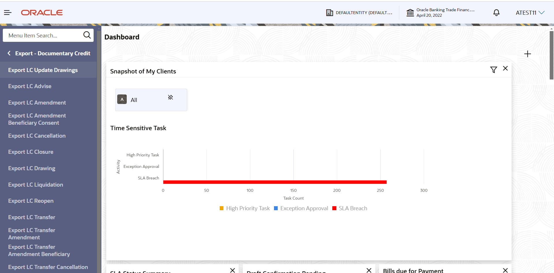

- On Home screen, click Trade Finance. Under Trade Finance, click Export Documentary Credit.
- Under Export Documentary Credit, click Export
LC Update Drawings.
Figure 2-3 Export LC Update Drawings

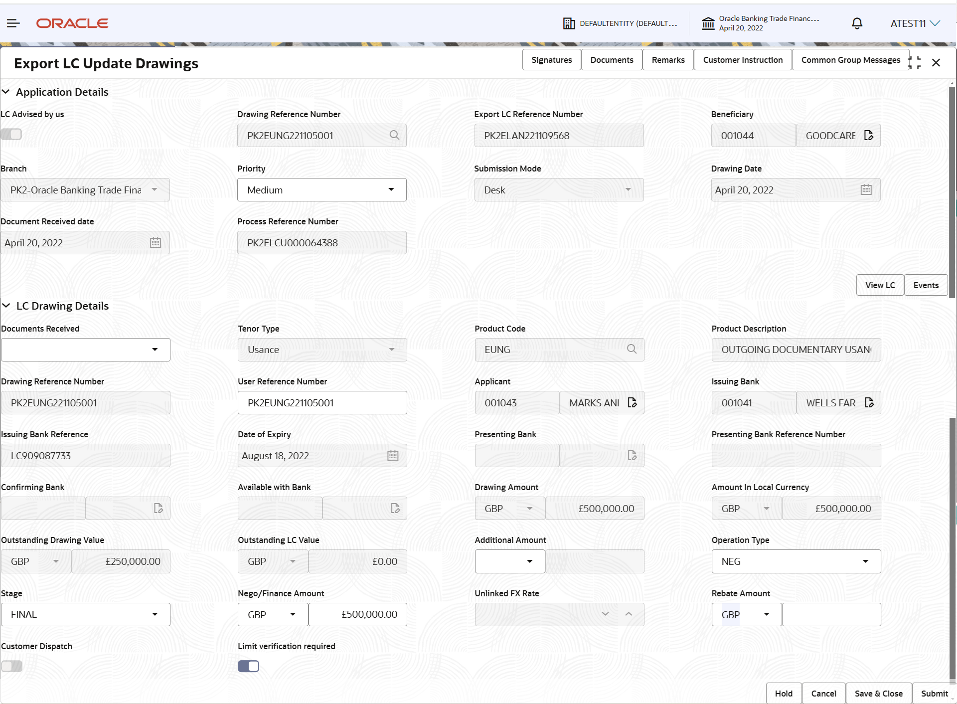

Description of the illustration exportlcupdatedrawings.pngThe Export LC Update Drawings - Registration screen appears.The Export LC Drawing - Registration stage has two sections Application Details and LC Details. Let’s look at the details of Registration screens below:
Figure 2-4 Export LC Update Drawings - Registration - Application Details
Description of the illustration registrationapplicationdetails.png - On Export LC Update Drawings - Registration - Application
Details screen, specify the fields.In case of MT798 message(738) application details is defaulted to SWIFT.
The fields which are marked as Required are mandatory.For more information on fields, refer to the field description table below.
Table 2-3 Export LC Update Drawings - Registration - Application Details - Field Description
Field Description LC Advised by us Enable the option, if LC is advised by negotiating bank. Disable the option, if LC is not advised by the negotiating bank.
Drawing Reference Number Specify the drawing reference number. Alternatively, click Search to search and select the drawing reference number. In the lookup, user can search giving Customer ID, Currency, Amount, User Reference Number and Value Date to fetch the LC details. Based on the search result, select the applicable LC for drawing.
In case of silent confirmation, user gets an alert message “The LC has been Silently Confirmed.”Export LC Reference Number Read only field. Exporter LC Reference Number is auto-populated based on the selected LC from the lookup.
Beneficiary If LC Advised by us toggle is enabled, this field is read-only. Beneficiary is auto-populated based on the selected LC from the look-up. If LC Advised by us toggle is disabled, click Search to search and select the beneficiary customer.
If beneficiary is a customer of the bank, system will check for valid KYC status. If KYC status is not valid, system will display alert message.
Branch Read only field. Branch details is auto-populated based on the selected Export LC Reference Number.
Priority System populates the priority of the customer based on priority maintenance. If priority is not maintained for the customer, system will populate 'Medium' as the default priority. User can change the priority populated any time before submit.
Submission Mode Read only field. System populates the submission mode of Export LC Update Drawings request.
By default the submission mode will have the value as ‘Desk’.
- Desk - Request received through Desk
- Courier - Request received through Courier
- Email - Request received through email
- Fax - Request received through Fax
Drawing Date Read only field. Drawing date is auto-populated based on the selected drawing.
Document Received Date Read only field. By default, the application will display system date.
Process Reference Number Read only field. Unique sequence number for the transaction.
This is auto generated by the system based on process name and branch code.

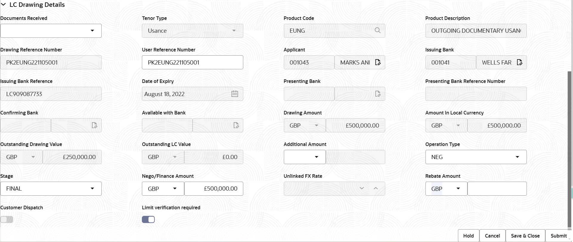

LC DetailsDrawing Details will be populated from the drawings. Registration user can update the fields if required.
Description of the illustration registrationlcdetails.png - On Export LC Update Drawings - LC Details screen,
specify the fields.
Table 2-4 Export LC Update Drawings - Registration - LC Details - Field Description
Field Description Documents Received Select the number of sets of documents received from the drop-down.. The options are:- First
- Second
- Both
Tenor Type Read only field. Tenor is auto-populated based on the selected drawing.
Product Code Read only field. Product code is auto-populated based on the selected drawing.
Product Description Read only field. This field displays the description of the product as per the product code.
Drawing Reference Number Read only field. Drawing reference number is auto-populated based on the selected drawing.
User Reference Number System defaults the user reference number based on the product code. The user can change the user reference number.
Applicant Read only field. Applicant details is auto-populated based on the selected drawing.
Issuing Bank If LC Advised by us toggle is enabled, this field is read-only. Issuing bank is auto-populated based on the selected LC from the look-up. If LC Advised by us toggle is disabled, click Search to search and select the issuing bank.
The system will display the- SWIFT code (if available)
- Name and address of the bank
Issuing Bank Reference If LC Advised by us toggle is enabled, this field is read-only. Issuing bank reference is auto-populated based on the selected LC from the look-up. If LC Advised by us toggle is disabled, specify the issuing bank reference number.
Date of Expiry Read only field. Date of expiry is auto-populated based on the selected drawing.
Presenting Bank If LC Advised by us toggle is enabled, this field is read-only. Presenting bank is auto-populated based on the selected LC from the look-up. If LC Advised by us toggle is disabled, specify the presenting bank or click Search to search and select the presenting bank.Note:
In case the selected Bank is not RMA Compliant, the system displays error message “RMA arrangement not available”.Presenting Bank Reference Number Read only field. Presenting bank reference number is auto-populated based on the selected drawing.
Confirming Bank Click Search to search and select the confirming bank. Available with Bank Click Search to search and select the value for available with bank from the look-up. Note:
The Available Bank details should be handed off against ‘Collecting Bank’ Party in OBTF.Note:
If the Bank selected in Confirming Bank and Available with Bank are same, system should hand off only the Confirming Bank details in Back office.Note:
If Confirming Bank/Available with Bank are the same as Issuing Bank/Presenting Bank, system should display an error.Drawing Amount LC Drawing Amount is auto-populated based on the selected LC. User can edit the details, if required.
Amount In Local Currency Read only field. System fetches the local currency equivalent value for the LC amount from back office (with decimal places).
Outstanding Drawing Value Read only field. Outstanding drawing value is auto-populated.
This field displays the value as per the latest LC.
Outstanding LC Value Read only field. Outstanding LC value is auto-populated.
Additional Amount Select the currency and specify any additional amount to be processed under this LC drawing. Operation Type If LC Advised by us toggle is enabled, this field is read-only. Operation type is auto-populated based on the selected LC from the look-up. If LC Advised by us toggle is disabled, select the operation type.
Stage Select the stage from the drop-down. The options are:- Initial
- Final
Nego/Finance Amount Negotiation/Financing amount is auto-populated based on the selected LC from the look-up. Unlinked FX Rate Unlinked FX Rate is auto-populated based on the selected LC from the look-up. Rebate Amount Select the currency and specify the rebate to the bill outstanding amount. Customer Dispatch The value is populated from back office based on the maintenance. If the option is enabled, the customer has the option to dispatch the documents directly to the importer’s bank.
Bank user is not allowed to edit the field, if the value defaulted from the back office is “No”,
If the option is enabled, the bank has to dispatch the documents to the importer’s bank. - Click Submit.The task will move to next logical stage of Export LC Update Drawings.
