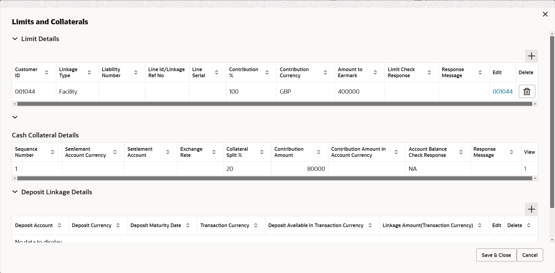

Description of the illustration scrutinyadditionaldetails.pngLimits and Collaterals
On Approval, system should not release the Earmarking against each limit line and system should handoff the “Limit Earmark Reference Number “to the back office. On successful handoff, back office will make use of these “Limit Earmark Reference Number” to release the Limit Earmark done in the mid office (OBTFPMCS) and should Earmark the limit from the Back office.
In case multiple Lines are applicable, Limit Earmark Reference for all lines to be passed to the back office.
Figure 2-16 Limit Details
Description of the illustration scrutinylimitdetails1.pngFor more information on fields, refer to the field description table below.
Table 2-21 Limit Details - Field Description
Field Description Limit Details Specify the limit details. Click plus icon to add new limit details.
Below fields are displayed on the Limit Details pop-up screen, if the user clicks plus icon.
Customer ID This field displays the applicant’s/applicant bank customer ID defaulted from the application. Linkage Type Select the linkage type. Linkage type can be:
- Facility
- Liability
By default Linkage Type should be Facility.
Contribution % System will default this to 100%. User can modify, if contribution is more than 100%. System will display an alert message, if modified. Once contribution % is provided, system will default the amount.
System to validate that if Limit Contribution% plus Collateral% is equal to 100. If the total percentage is not equal to 100 application will display an alert message.Note:
The collateral % maintained for the customer is defaulted into the Collateral Details screen. If collateral % is not maintained for the customer, then system should default the collateral % maintained for the product. User can modify the defaulted collateral percentage, in which case system should display a override message “Defaulted Collateral Percentage modified.Liability Number Click Search to search and select the Liability Number from the look-up. The list has all the Liabilities mapped to the customer.
Contribution Currency This field displays the contribution currency. Line ID/Linkage Ref No Click Search to search and select from the various lines available and mapped under the customer id gets listed in the drop-down. LINE ID-DESCRIPTION will be available for selection along with Line ID. When you click on 'verify', the system will return value if the limit check was successful or Limit not Available. If limit check fails, the outstanding limit after the transaction value will be shown in the limit outstanding amount.
The user can click the Line Id link to view the limit details.Note:
User can also select expired Line ID from the lookup and on clicking the verify button, system should default “The Earmarking cannot be performed as the Line ID is Expired” in the “Response Message” field.This field is disabled and read only, if Linkage Type is Liability.
Limit/Liability Currency This field displays the limit currency, when the user select the Liability Number. Limits Description This field displays the limits description. Limit Check Response This field displays the limit check response. Response can be ‘Success’ or ‘Limit not Available’ based on the limit service call response.
The value in this field appears, if you click the Verify button.
Amount to Earmark This field defaults the amount to earmark. Contribution amount will default based on the contribution %.
User can change the value.
Expiry Date This field displays the date up to which the Line is valid. Limit Available Amount This field displays the value of available limit, i.e., limit available without any earmark. The Limit Available Amount must be greater than the Contribution Amount. The value in this field appears, if you click the Verify button.
Response Message This field displays the detailed response message. The value in this field appears, if you click the Verify button.
ELCM Reference Number This field displays the ELCM reference number. Limit Details grid Below fields appear in the Limit Details grid along with the above fields. Line Serial Displays the serial of the various lines available and mapped under the customer id. This field appears on the Limits grid.
Edit Click the link to edit the Limit Details. Cash Collateral Details This section displays the Cash Collateral Details. Collateral Percentage System populates the Collateral % maintained in the Customer / Product for the counter party of the contract. User can modify the collateral percentage.
Collateral Currency and amount System populates the contract currency as collateral currency by default. User can modify the collateral Currency and amount.
Exchange Rate System populates the exchange rate maintained. User can modify the collateral Currency and amount.
System validates for the Override Limit and the Stop limit if defaulted exchange rate is modified.

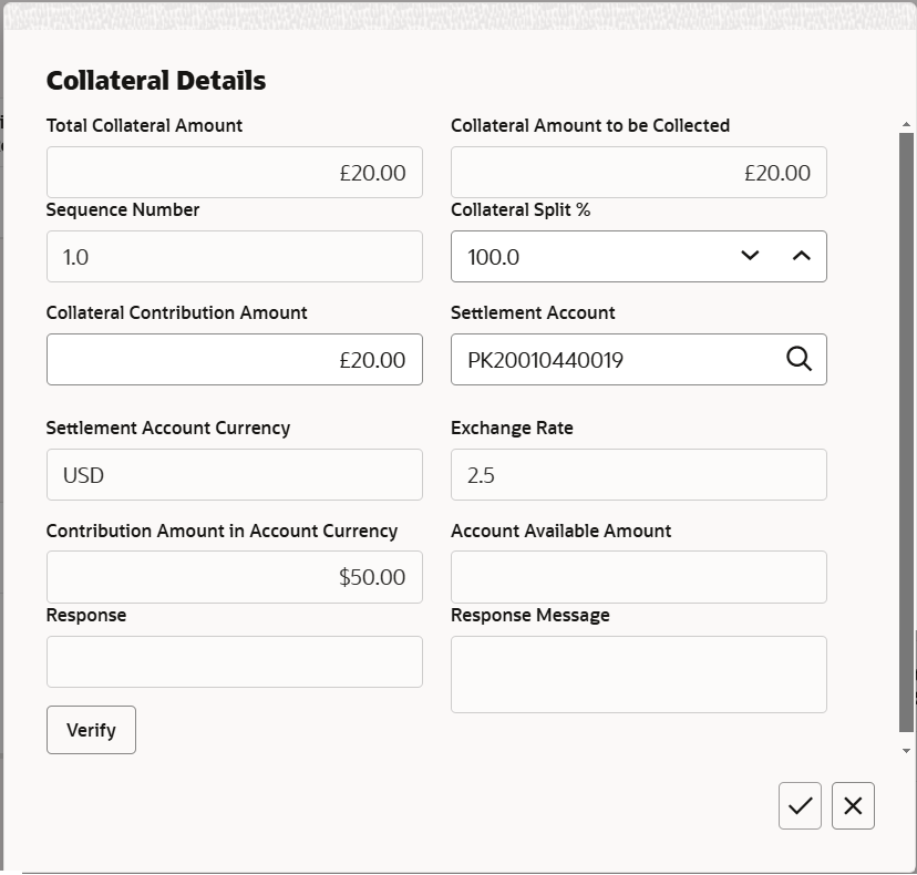

Collateral Details pop-up screen Click + plus icon to add new collateral details. Below fields are displayed on the Collateral Details pop-up screen, if the user clicks plus icon.
Total Collateral Amount Read only field. This field displays the total collateral amount provided by the user.
Collateral Amount to be Collected Read only field. This field displays the collateral amount yet to be collected as part of the collateral split.
Sequence Number Read only field. The sequence number is auto populated with the value, generated by the system.
Collateral Split % Specify the collateral split% to be collected against the selected settlement account.
Collateral Contribution Amount Specify the collateral amount to be collected against the selected settlement account. User can either provide the collateral % where the collateral amount will be auto populated or modifying the collateral amount will auto correct the collateral %.
Settlement Account Click Search to search and select the settlement account for the collateral. Settlement Account Currency Read only field. This field displays the settlement account currency defaulted by the system.
Exchange Rate Read only field. This field displays the exchange rate, if the settlement account currency is different from the collateral currency.
Contribution Amount in Account Currency Read only field. This field displays the contribution amount in the settlement account currency as defaulted by the system.
Account Available Amount Read only field. System populates the account available amount on clicking the Verify button.
Response Read only field. System populates the response on clicking the Verify button.
Response Message Read only field. System populates the response message on clicking the Verify button.
Verify Click to verify the account balance of the Settlement Account. Save & Close Click to to save and close the record. Cancel Click to cancel the entry. Cash Collateral Details grid Below fields appear in the Cash Collateral Details grid along with the above fields. Collateral % Specify the percentage of collateral to be linked to this transaction. If the value is more than 100% system will display an alert message. The collateral % maintained for the customer is defaulted into the Collateral Details screen. If collateral % is not maintained for the customer, then system should default the collateral % maintained for the product. User can modify the defaulted collateral percentage, in which case system should display a override message “Defaulted Collateral Percentage modified.
Contribution Amount This field displays the collateral contribution amount. The collateral % maintained for the customer is defaulted into the Collateral Details screen. If collateral % is not maintained for the customer, then system should default the collateral % maintained for the product. User can modify the defaulted collateral percentage, in which case system should display a override message “Defaulted Collateral Percentage modified.
Edit Click edit link to edit the collateral details. Account Available Amount This field displays the account available amount which will be auto-populated based on the settlement account selection. Deposit Linkage Details In this section which the deposit linkage details is captured.
System should allow the user to Link one or more existing Deposits as a contribution to secure underlying transactions. On Submit of DE stage, system will create Linkage of the Deposit/modification of existing Linkage by calling Back-office system (DDA) system directly.
Click + plus icon to add new Deposit Linkage details.
Edit Click edit link to edit the deposit linkage details. Deposit Linkage Details pop-up screen Below fields are displayed on the Deposit Linkage Details pop-up screen, if the user clicks plus icon. Deposit Account Click Search to search and select deposit for linkage from the list of all the customer Deposits. All the Deposits of the customer should be listed in the LOV search. User should be able to select the deposit for linkage.
Deposit Branch This field displays the deposit branch which will be auto-populated based on the deposit account selection. Deposit Available Amount This field displays the deposit available amount and currency which will be auto-populated based on the deposit account selection. Deposit Maturity Date This field displays the maturity date of deposit based on the deposit account selection. Exchange Rate This field displays the latest exchange rate for deposit linkage. This will be picked up from the exchange rate maintenance from the common core.
Deposit Available In Transaction Currency This field displays the deposit amount available, after exchange rate conversion, if applicable. Linkage Percentage % Specify the value for linkage percentage. Linkage Amount (Transaction Currency) This field displays the transaction amount, user can change the value. System validates the linking amount with available Deposit balance and should not allow to link more than the available amount.
Deposit Details grid Below fields appear in the Deposit Details grid along with the above fields. Deposit Currency This field displays the deposit currency. Transaction Currency This field displays the transaction currency. - Click Save and Close to save the details and close the
screen.

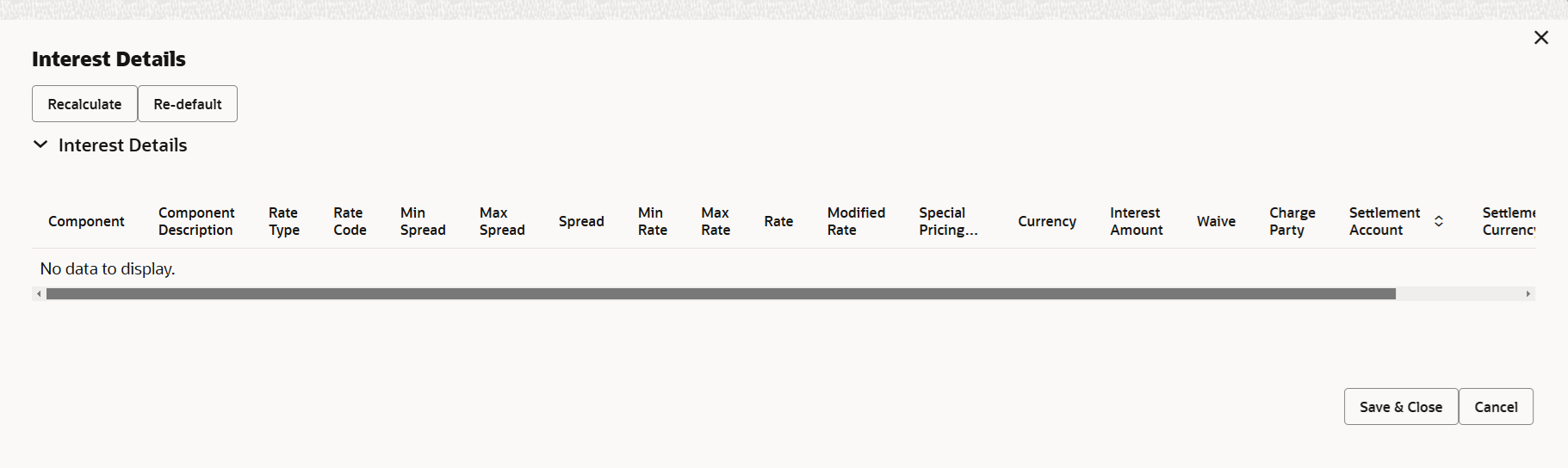

screen.Interest Details
The user can view and modify the Interest details simulated from the back office system. On update of the Interest rate user has to click on Recalculate button. System will trigger a simulation call to the back office and the updated Interest details will be reflected in this section.
Description of the illustration intrestdetails.pngFor more information on fields, refer to the field description table below.
Table 2-24 Interest Details - Field Description
Field Description Component This field displays the component maintained in the back office. Component Description This field displays the description of the component. Rate Type This field displays the rate type maintained for the component in back office. - Fixed Floating
- Special
Rate Code This field displays the rate code applicable for the component. Min Spread This field displays the minimum spread applicable for the Rate Code. This field have value, if the Rate Type is Floating.
Max Spread This field displays the maximum spread applicable for the Rate Code. This field have value, if the Rate Type is Floating.
Spread This field displays the spread applicable for the Component in case of Floating Rate Component. User can change the defaulted value. System validates whether the spread input is within the Minimum to Maximum Spread.
Min Rate This field displays the minimum rate applicable for the Rate Code. Max Rate This field displays the maximum rate applicable for the Rate Code. Rate This field displays the value applicable for the Rate Code. You can modify the value, if the Rate Type is Fixed. System validates whether the Rate input is between the Minimum and Maximum Rate.
Modified Rate This field displays the modified rate. Special Pricing Reference Number Specify the Special Pricing Reference Number, when there is a special Interest rate to be provided for that customer against the interest component (Main Component). Special Pricing Reference is not applicable for Penal Interest components.
For transactions initiated from OBDX, the Special Pricing Reference Number will be populated from OBDX and user cannot edit the same.Note:
System displays an override as “Special Pricing Applicable”, on clicking “Save” in the Interest Details screen, if Special Pricing Reference number has been provided.Currency This field displays the interest currency. Amount Specify the interest amount, if the Rate Type is Special. In other cases , the amount will be calculated by back office immediately only if the Interest is collected in Advance or if Back Dated Interest is collected. In that scenario, the Amount will be populated on Re-simulation from back office. Otherwise Interest will be calculated only in the batch as maintained.
Waive User can waive the Interest applicable. System displays an override, if the user has waived the Interest. Charge Party This field displays the Charge Party based on the type of transaction. In case of Export Transactions, Drawer should be the defaulted Charge Party for Collection Bills and Beneficiary for the LC Bills. In case of Import Transactions, Drawee should be the Charge Party for Collection and Applicant for the LC Bills.
Settlement Account This field displays the settlement account of the Charge Party for debit of Interest. User can change the value. System displays an error if a different customer is chosen. If different account of the Charge Party is selected, system should display a override. In case the user modifies the Interest Rate, the user should click on Recalculate button to get the modified amount from the back office and display the new Amount.(Recalculation is done in back office and not in OBTFPMCS).
Settlement Currency This field displays the settlement account currency. Settlement Branch This field displays the settlement account branch. - Click Save and Close to save the details and close the

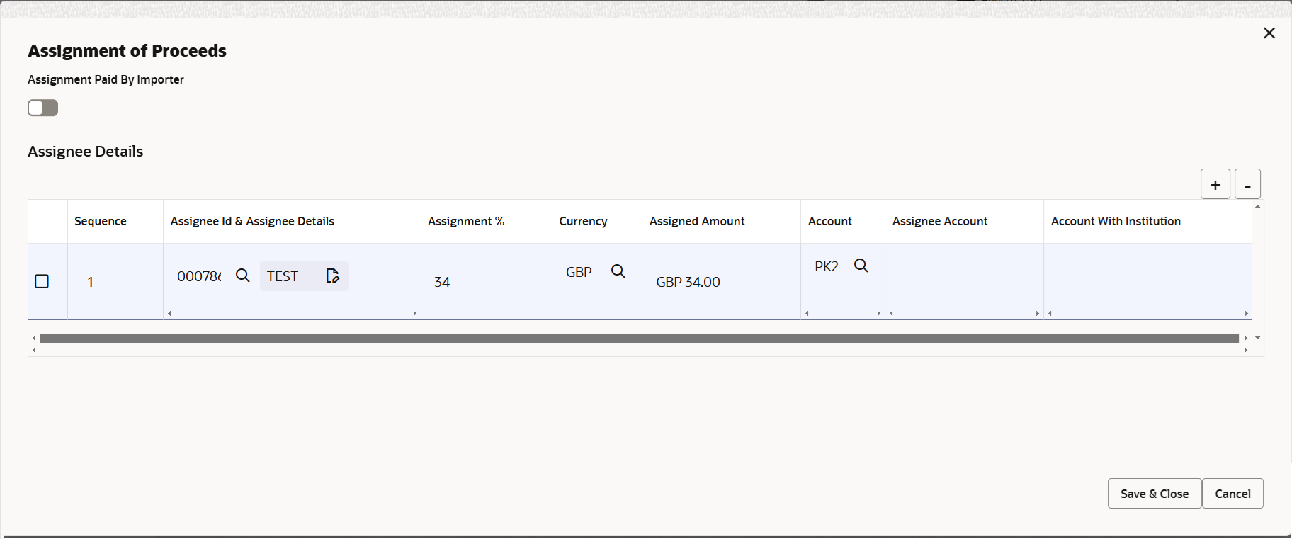

screen.Assignment of Proceeds
In this tile, assignment details for the applicable processes is displayed. Proceeds can be assigned only if the parties have been assigned during drawing or update drawing process.
Table 2-25 Assignment of Proceeds - Field Description
Field Description Assignment Paid By Importer Enable the option, if assignment is paid by importer. The user can click + to add multiple Assignment of Proceeds.
Sequence Specify the sequence number. Assignee ID & Assignee Details Click Search to search and select the assignee id. Assignee details appear based on selected assignee ID. User can add multiple assignees to a single Bill under LC with the assignment amount or assignment percentage of parent LC.
WALKIN customers is allowed as assignee.Assignment % Specify the percentage of LC amount that has be assigned to the assignee. Once the user updates the rate, the system calculates the amount as per assigned rate and default in the assigned amount field. If the user directly captures the assigned amount then the assigned percentage has to calculate the percentage and the same to be populated in the screen. If contribution is more than 100%, system to display an alert message. Once contribution % is input system will default the amount. System to validate that Limit Contribution percentage plus Collateral percentage is equal to 100. Otherwise system to provide override.The assignment percentage should be rounded to two decimal places.
Currency Click Search to search and select the account currency of the settlement account of the assignee. Only the currencies for which the settlement account is available, only those currency will be displayed. Assigned Amount Specify the amount that has to be assigned to the assignee. If the user has already entered the assignment percentage, system to calculate the amount and populate the value.
Assignee Bank Details Click Search to search and select the assignee bank. Account with Institution Click Search to search and select the account number of the Account with Institution. - Click Save and Close to save the details and close the

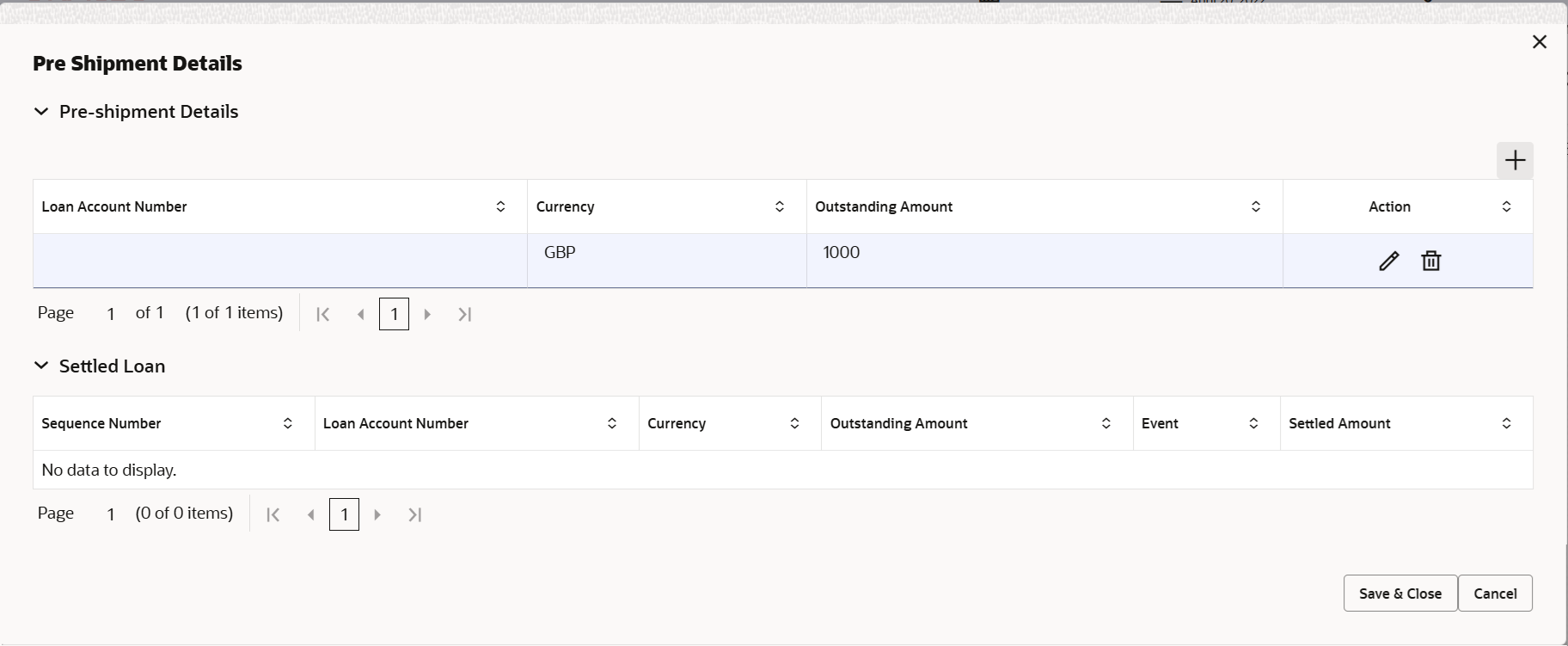

screen.Pre-Shipment Details
This section links an existing Preshipment Credit.
Description of the illustration scrutinypreshipmentdetails.pngFor more information on fields, refer to the field description table below.
Table 2-26 Pre-Shipment Details - Field Description
Field Description Pre Shipment Details Specify the pre-shipment details. The user can click + to add multiple Pre Shipment Details.
Loan Account Number Click Search to search and select the loan account number. Currency Application defaults the currency of the Pre-Shipment Credit Number. Outstanding Amount Application defaults the outstanding amount of the Pre-Shipment Credit Number. Action Click Edit icon to edit the pre-shipment details. Click Delete icon to delete the pre-shipment details.
Setteled Loan This section displays the settled loan details. Sequence Number This field displays the sequence of the settled loan. Loan Account Number This field displays the settled loan account number. Currency This field displays the currency of the settled loan account number. Outstanding Amount This field displays the outstanding amount. Event This field displays the event. Setteled Amount This field displays the settled amount. - Click Save and Close to save the details and close the
screen.

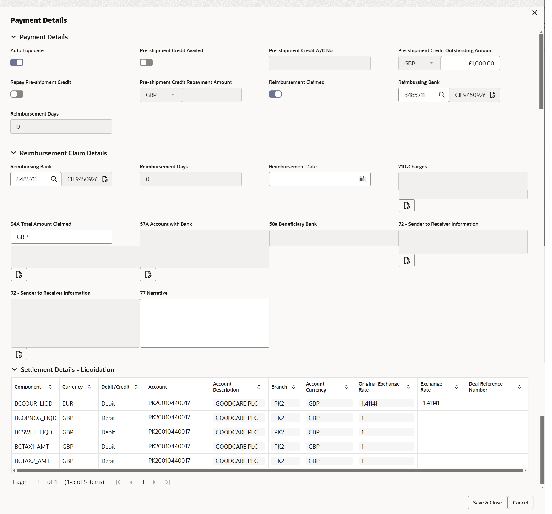

Payment Details
Table 2-27 Payment Details - Field Description
Field Description Payment Details Specify the Payment Details. Auto Liquidate If LC Advised by us option is enabled, auto liquidation required details gets defaulted from the LC. If LC Advised by us option is disabled, enable Auto Liquidate, if auto liquidation is required. It is applicable only if the drawing is without discrepancy.
Disable Auto Liquidate, if auto liquidation is not required.
Preshipment Credit Availed If LC Advised by us option is enabled, pre-shipment credit availed details gets defaulted from the LC. If LC Advised by us option is disabled, enable Preshipment Credit Availed, if pre-shipment credit is availed.
Disable Preshipment Credit Availed, if pre-shipment credit is not availed.
Preshipment Credit A/C No. This field displays the pre-shipment credit account number. Preshipment Credit Outstanding Amount Specify the preshipment credit outstanding amount. Repay Preshipment Credit If LC Advised by us option is enabled, repay pre-shipment credit details gets defaulted from the LC. If LC Advised by us option is disabled, enable Repay Pre-shipment Credit, if pre-shipment credit to be repaid.
Disable Repay Pre-shipment Credit, if there is no pre-shipment credit to be repaid.
Preshipment Credit Repayment Amount This field displays the pre-shipment credit repayment amount. Reimbursement Claimed If LC Advised by us option is enabled, reimbursement claimed details gets defaulted from the LC. If LC Advised by us option is disabled, enable Reimbursement Claimed, if reimbursement to be claimed.
Disable Reimbursement Claimed, if there are no reimbursement to be claimed.
Reimbursing Bank If LC Advised by us option is enabled, reimbursing bank details gets defaulted from the LC. Click Search to search and select the reimbursing bank, if Reimbursement Claimed option is enabled.Note:
If the user selects another bank and in case the selected Bank is not RMA Compliant, the system displays error message “RMA arrangement not available, Only MT999 messages can be sent to the bank”.Reimbursement Days Specify the number of days before the maturity date on which the reimbursement claim needs to be triggered. Liquidate using Collateral Enable the option, if liquidation is done using Collateral. Reimbursing Claim Details Specify the Reimbursing Claim Details. Reimbursing Bank Click Search to search and select the reimbursing bank, if Reimbursement Claimed option is enabled.Note:
If the user selects another bank and in case the selected Bank is not RMA Compliant, the system displays error message “RMA arrangement not available, Only MT999 messages can be sent to the bank”.Reimbursement Days Specify the number of days before the maturity date on which the reimbursement claim needs to be triggered. Reimbursement Date Reimbursement date will be displayed based on the reimbursement days and maturity date. Enables user to capture the reimbursement date. If reimbursement date is later than the branch date, system will display an error.
Charges Click the edit icon and specify the charge details in Line 1-6 and click Save & Close to save the changes. The user can edit the details by clicking the edit icon.
Total Amount Claimed Specify the total amount claimed. Account with Bank Click the edit icon and specify the account with bank details in Line 1-6 and click Save & Close to save the changes. The user can edit the details by clicking the edit icon.
Beneficiary Bank Click the edit icon and specify the beneficiary bank details in Line 1-6 and click Save & Close to save the changes. The user can edit the details by clicking the edit icon.
Sender to Receiver Information Click the edit icon and specify the sender to receiver information in Line 1-6 and click Save & Close to save the changes. The user can edit the details by clicking the edit icon.
T 754- Advice of Payment/Acceptance/Negotiation Details Specify the T 754- Advice of Payment/Acceptance/Negotiation Details. Charges to be recovered Click the edit icon and specify the charges to be recovered in Line 1-6 and click Save & Close to save the changes. The user can edit the details by clicking the edit icon.
Charges to be added Click the edit icon and specify the charges to be added in Line 1-6 and click Save & Close to save the changes. The user can edit the details by clicking the edit icon.
Narrative Specify the narrative. Settlement Details - Liquidation Specify the Settlement Details - Liquidation. Component This field displays the component based on the product selected. Currency This field displays the currency for the component. Debit/Credit This field displays the debit/credit indicators for the components. Account This field displays the account details for the components. Account Description This field displays the description of the selected account. Branch This field displays the branch of the selected account. Account Currency This field displays the currency for all the items based on the account number. Original Exchange Rate System displays the Original Exchange Rate as simulated in settlement details section from OBTF. Exchange Rate The exchange rate for the settlement. Deal Reference Number The exchange deal reference number. - Click Save and Close to save the details and close the screen.
