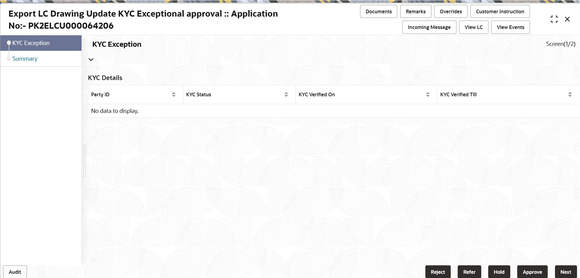

Exception - Know Your Customer (KYC)
- Log in into OBTFPMCS application, KYC exception queue. KYC exception failed tasks for Trade Finance transactions will be listed in your queue.
- Open the task, to see summary tiles that display a summary of
available updated fields with values.
User can pick up a transaction and do the following actions:
Approve- After changing the KYC status in the back end application (outside this process).
- Without changing the KYC status in the back end application.
- Reject (with appropriate reject reason).
Figure 2-38 Know Your Customer (KYC)
Exception

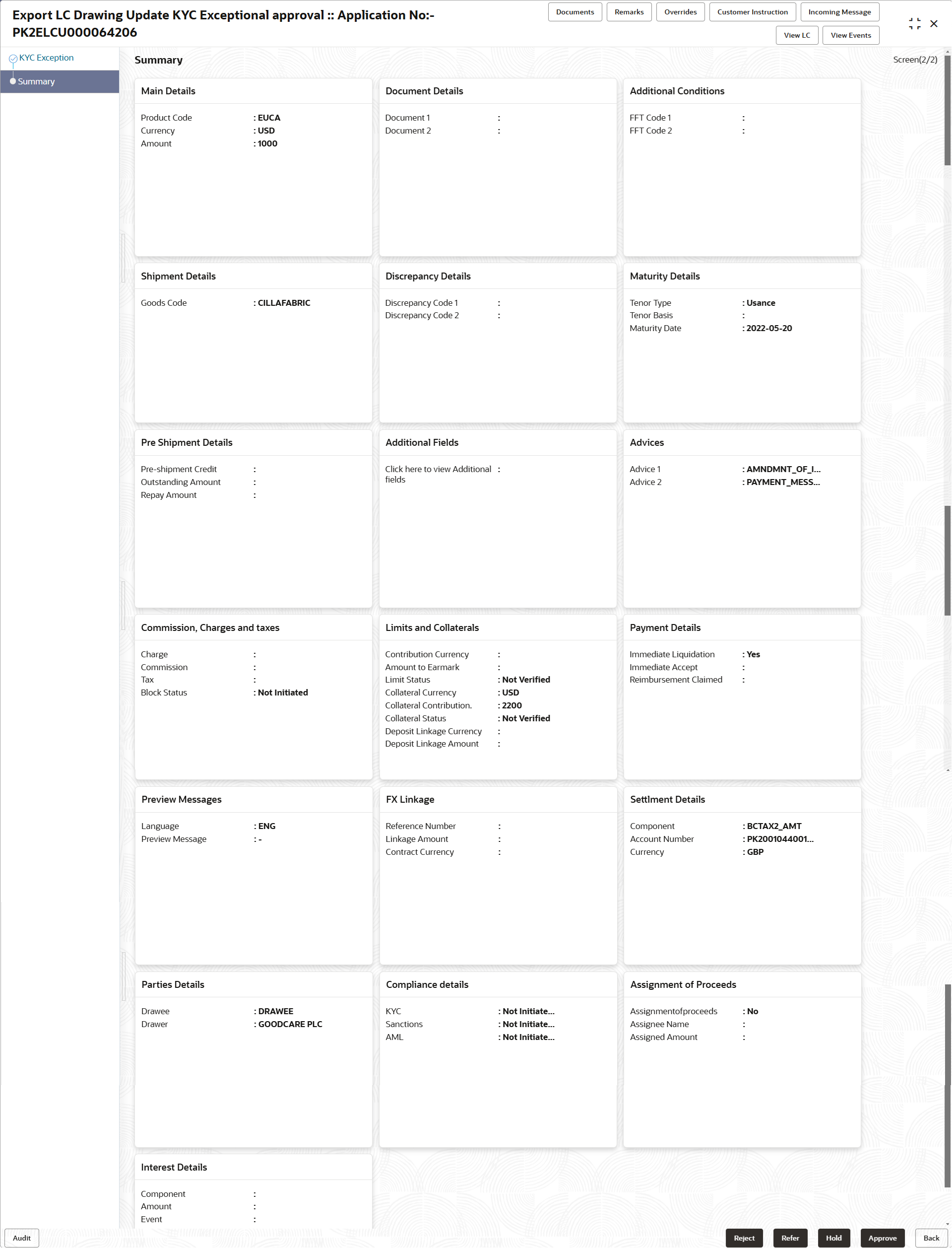

- Main Details - User can view the application and LC details.
- Documents Details- User can view the Document details.
- Additional Conditions - User can view the additional conditions.
- Shipment Details - User can view shipment details.
- Discrepancy Details - User can view the discrepancy noted for the current LC drawing.
- Maturity Details - User can view the maturity details.
- Pre Shipment Details - User can view the pre shipment details.
- Advices - User can viewthe advices details.
- Limits and Collaterals - User can view limits and collateral details.
- Commission, Charges and Taxes - User can view the charge details.
- Payment Details - User can view the payment details.
- Preview Messages - User can view the preview of the message.
- FX Linkage - User can view the FX linkage details.
- Settlement Details - User can view the settlement details.
For more information on Action Buttons, refer to the field description table below.
