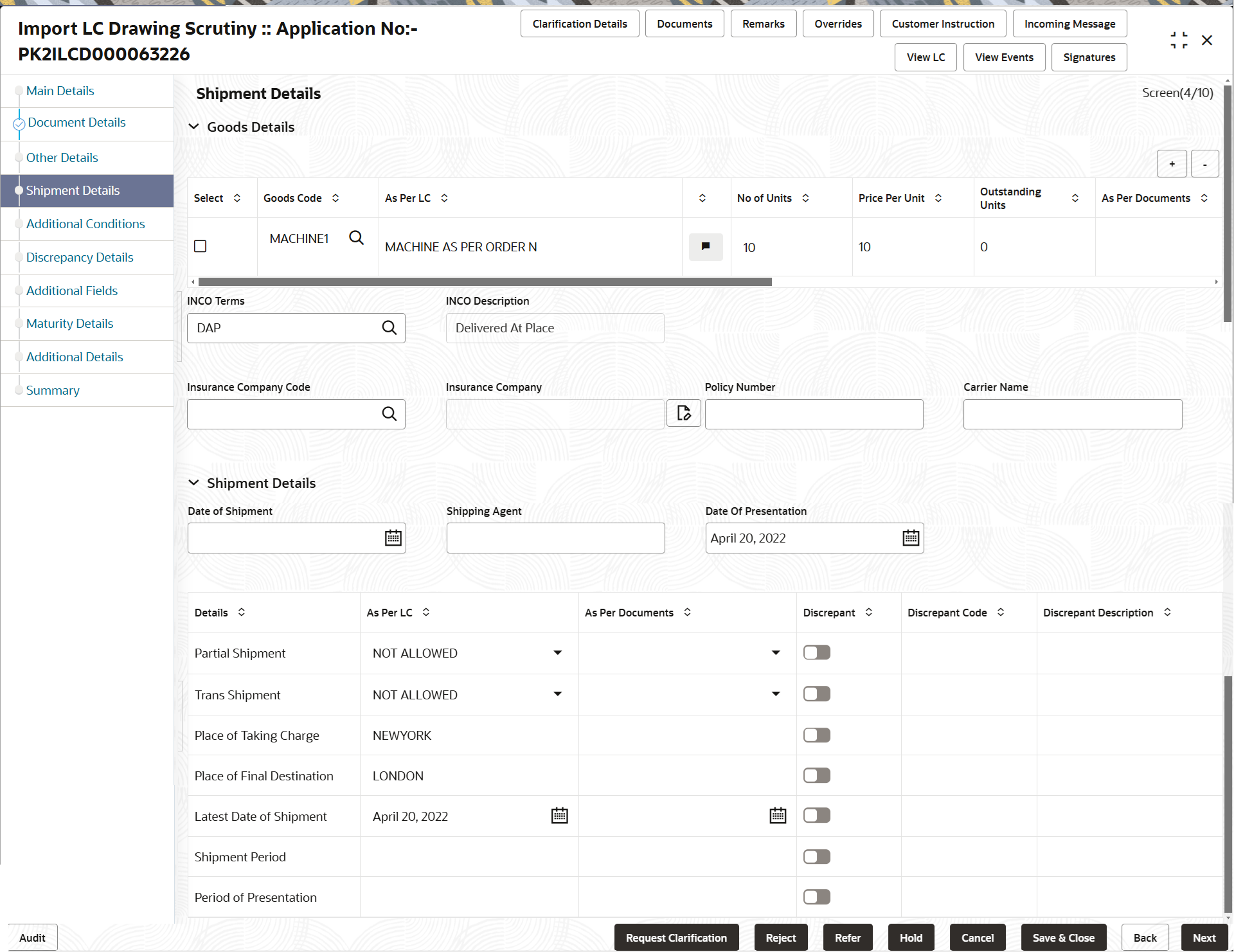

2.2.4 Shipment Details
This topic provides the systematic instructions to capture the shipment details.
- On Shipment Details screen, specify the fields.
Figure 2-10 Shipment Detials
Description of the illustration scrutinyshipmentdetails.pngFor more information on fields, refer to the field description table below.
Table 2-12 Shipment Detials - Field Description
Field Description Goods Details Specify the goods details. Click + sign to add multiple good details.
Select Check box to select the record. Goods Code This field displays goods code as per latest LC. Click Search to search and select the goods code for adding a new good details.
As per LC This field displays description of the goods as per the latest LC. No of Units Specify the number of units being imported or exported. Price per Unit Indicates the value for price per unit. Outstanding Units Indicates the value for Outstanding Units. As per Documents Specify the description of goods as per the documents.
Click the edit icon to edit the description of goods. Discrepant Enable the option, if there is difference between LC requirement and documents received. Discrepant Code Click Search to search and select the discrepancy code based on the discrepancy identified. This field is enabled if Discrepant option is enabled.
Discrepant Description This field displays the description based on the discrepancy code.
Click the edit icon to edit the Discrepant description. Insurance Company Code Click Search to search and select the insurance company code. Insurance Company The details of insurance company is populated as per the selected Insurance Company Code. Policy Number Specify the policy number of the insurance. Carrier Name Specify the details of the carrier as per the documents received, if the goods got shipped via multiple carriers. Shipment Details. Specify the Shipment Details. As part of amendment, user can change the values available in the fields based on the description in the following table.
Date Of Shipment Select the date of shipment as per the documents received. Shipping Agent Specify the shipping agent details based on the document received. Date of Presentation The date of presentation is auto-populated based on the system date. User can change the date.
Details The details represent the fields in latest LC. As per LC Specify or select the description of the fields as per the latest LC. As per Documents Specify or select the description of the fields as per the documents. Discrepant Enable the option, if there is difference between LC terms and documents received. Discrepant Code Click Search to search and select the discrepancy code based on the discrepancy identified. This field is enabled if Discrepant option is enabled.
Discrepant Description This field displays the description based on the discrepancy code. Partial Shipments This field displays the Partial Shipment terms from LC. User to capture if the shipment was partial. If the terms in LC is different from what is captured from document, system will mark discrepancy with discrepancy description as ‘Discrepancy in Partial Shipment terms’ User can modify the description.
Transshipment This field displays the value of Transshipments as per the issued LC. User to capture if the shipment was Trans-shipped. If the terms in LC is different from what is captured from document, system will mark discrepancy with discrepancy description as ‘Discrepancy in Trans-Shipment terms’ User can modify the description.
Place Of Taking Charge This field displays the value of place of taking in charge, if any from LC. User to capture Place of Taking charge if any, from documents received. If the terms in LC is different from what is captured from document, system will mark discrepancy with discrepancy description as ‘Discrepancy in Place of Taking Charge’ User can modify the description.
Place Of Final Destination This field displays the value of Place of Final Destination, if any from LC. User to capture Place of Final Destination if any from documents received. If the terms in LC is different from what is captured from document, system will mark discrepancy with discrepancy description as ‘Discrepancy in Place of Taking Charge’ User can modify the description.
Latest Date Of Shipment This field displays the value of Latest Date of Shipment, if any from LC. System also displays the Shipment Date already captured as per documents. If the shipment date is later than the latest date of shipment, system will mark discrepancy as ‘Late Shipment’. User can modify the description.
Shipment Period This field displays the value of shipment period, if any from LC. System will also display the Shipment Date already captured as per documents. If the shipment date is later than Shipment Period + Date of Expiry, system will mark discrepancy as ‘Late Shipment’. User can modify the description.
Period of Presentation This field displays the period of presentation, if any from LC. System also displays the Presentation Date already captured as per documents. If the presentation date is later than the latest date of shipment+ Presentation Period, system will mark discrepancy as ‘Late Presentation’. User can modify the description.
