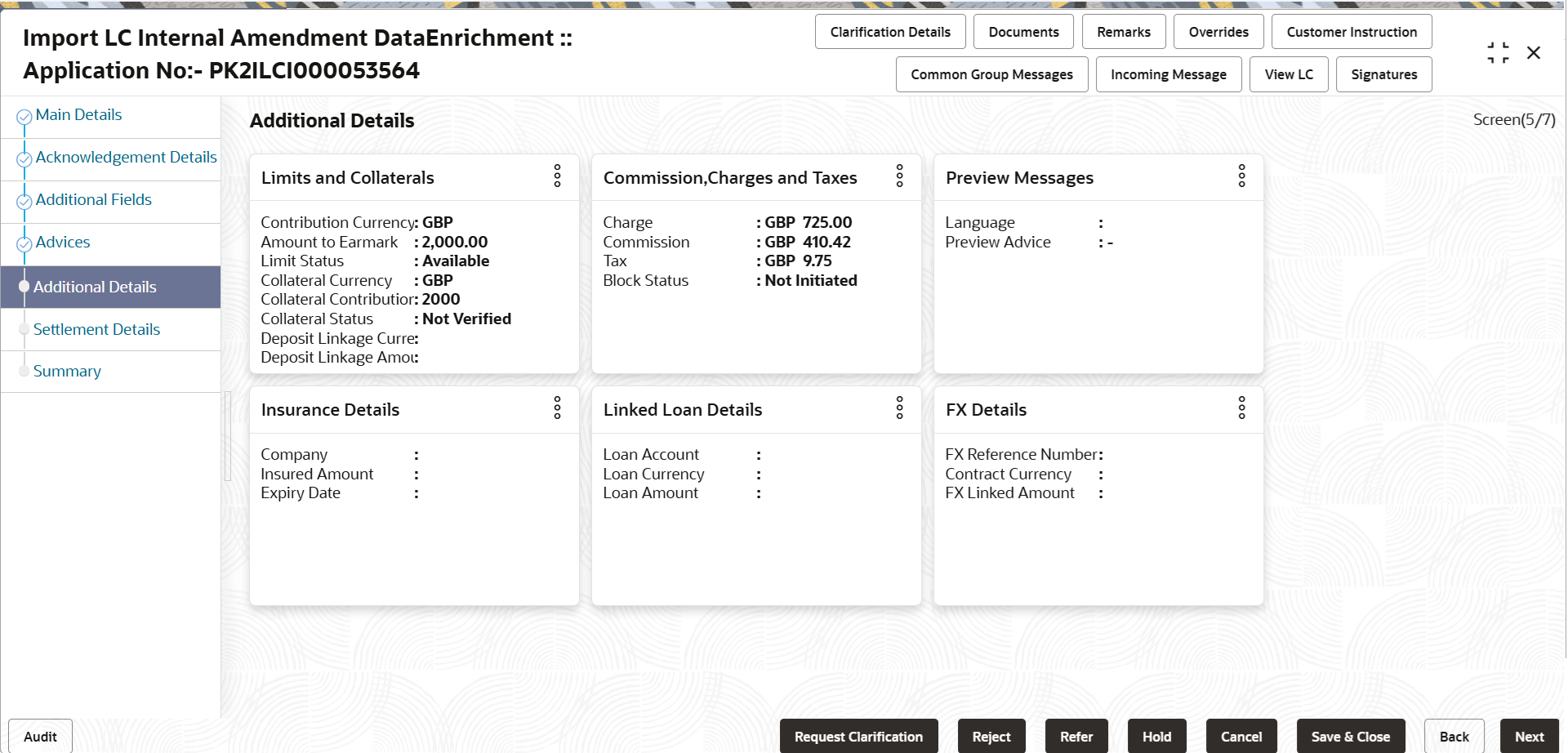

2.3.5 Additional Details
This topic provides the systematic instructions to capture the additional details.
- On Additional Details screen, click the 3 dots on any
Additional Details tile to view the details.
Figure 2-12 Additional Details
Description of the illustration deadditionaldetails.png - Click Save and Close to save the details and close the
screen.

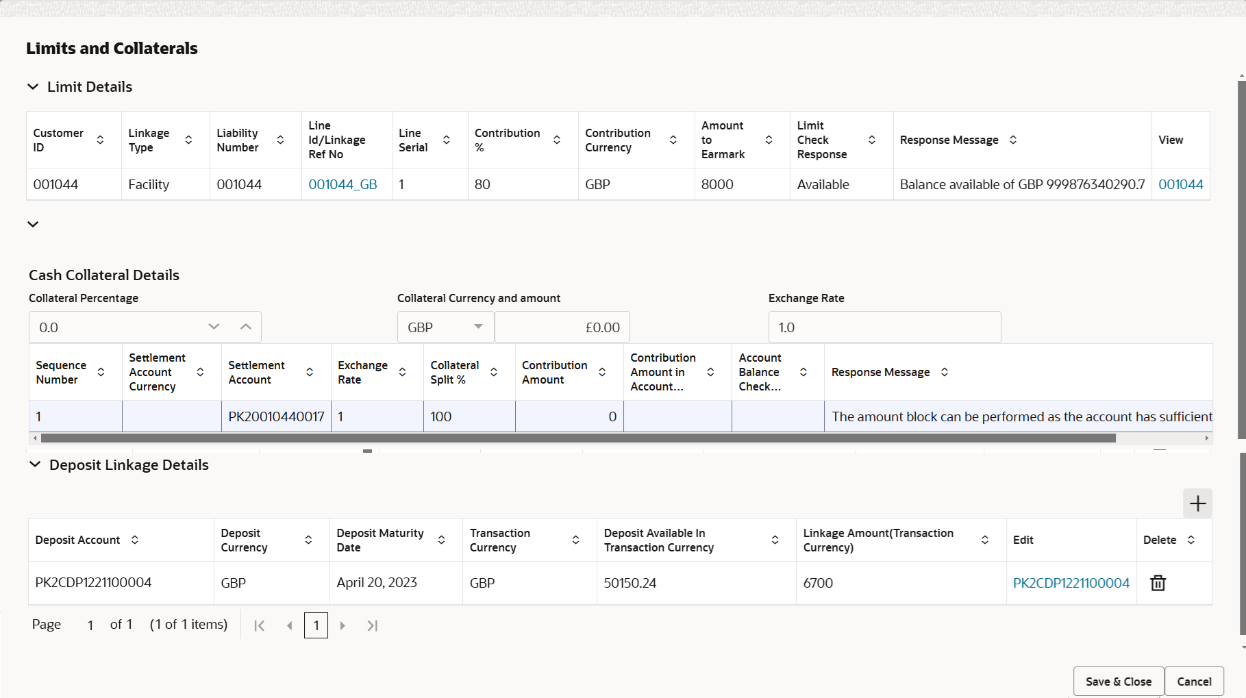

Limits and Collaterals
On Approval, system should not release the Earmarking against each limit line and system should handoff the “Limit Earmark Reference Number “to the back office. On successful handoff, back office will make use of these “Limit Earmark Reference Number” to release the Limit Earmark done in the mid office (OBTFPMCS) and should Earmark the limit from the Back office.
In case multiple Lines are applicable, Limit Earmark Reference for all lines to be passed to the back office. Provide the Limit Details based on the description in the following table.
Description of the illustration delimitdetails.pngFigure 2-13 Limit Details
Description of the illustration scrutinylimitdetails1.pngFigure 2-14 Collateral Details

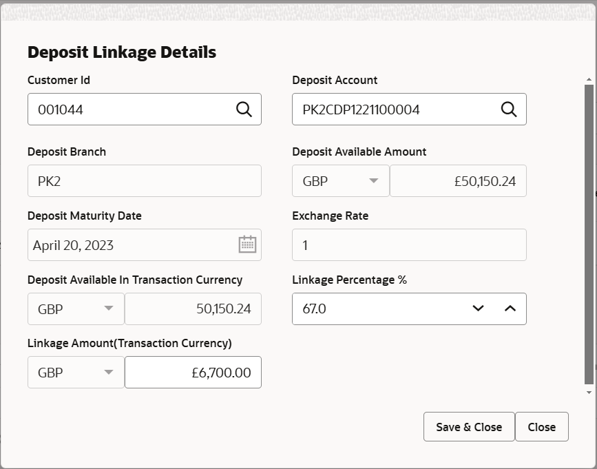

Description of the illustration decollateraldetails1.pngFigure 2-15 Deposit Linkage Details
Description of the illustration dedepositdetails1.pngFor more information on fields, refer to the field description table below.
Table 2-15 Limit Details - Field Description
Field Description Limit Details Below fields are displayed on the Limit Details pop-up screen, if the user clicks plus icon. Customer ID This field displays the applicant’s/applicant bank customer ID defaulted from the application. The user can change the Customer ID.
Linkage Type Select the linkage type. Linkage type can be:
- Facility
- Liability
By default Linkage Type should be “Facility”.
Contribution % System defaults this field to 100%. User can modify this value. If contribution is more than 100%, system displays an alert message, if modified.
Once contribution % is provided, system defaults the amount.
System validates that if Limit Contribution% plus Collateral% is equal to 100. If the total percentage is not equal to 100 application will display an alert message.Note:
The collateral % maintained for the customer is defaulted into the Collateral Details screen. If collateral % is not maintained for the customer, then system should default the collateral % maintained for the product. User can modify the defaulted collateral percentage, in which case system should display a override message “Defaulted Collateral Percentage modified.Liability Number Click Search to search and select the Liability Number from the look-up. The list has all the Liabilities mapped to the customer.
Contribution Currency Read only field. This field displays the contribution currency.
Line ID/Linkage Ref No Click Search to search and select from the various lines available and mapped under the customer id list. LINE ID-DESCRIPTION will be available for selection along with Line ID. When you click on 'verify', the system will return value if the limit check was successful or Limit not Available. If limit check fails, the outstanding limit after the transaction value will be shown in the limit outstanding amount.
The user can click the Line Id link to view the limit details.Note:
User can also select expired Line ID from the lookup and on clicking the verify button, system should default “The Earmarking cannot be performed as the Line ID is Expired” in the “Response Message” field.This field is disabled and read only, if Linkage Type is Liability.
Limit/Liability Currency Read only field. This field displays the limit currency, when the user select the Liability Number.
Limits Description Read only field. This field displays the limits description.
Limit Check Response Read only field.This field displays the limit check response. Response can be ‘Success’ or ‘Limit not Available’ based on the limit service call response.
The value in this field appears, if you click the Verify button.
Amount to Earmark This field defaults the amount to earmark. Contribution amount will default based on the contribution %.
User can change the value.
Expiry Date Read only field. This field displays the date up to which the Line is valid.
Limit Available Amount Read only field. This field displays the value of available limit, i.e., limit available without any earmark. The Limit Available Amount must be greater than the Contribution Amount.
Response Message Read only field. This field displays the detailed response message. The value in this field appears, if you click the Verify button.
ELCM Reference Number Read only field. This field displays the ELCM reference number.
Limit Details grid Below fields appear in the Limit Details grid along with the above fields. Line Serial Displays the serial of the various lines available and mapped under the customer id. Edit Click the link to edit the Limit Details. Cash Collateral Details Specify the Collateral details based on the description of following table: Collateral Percentage System populates the Collateral % maintained in the Customer / Product for the counter party of the contract. User can modify the collateral percentage.
Specify the percentage of collateral to be linked to this transaction. If the value is more than 100% system will display an alert message. The collateral % maintained for the customer is defaulted into the Collateral Details screen. If collateral % is not maintained for the customer, then system should default the collateral % maintained for the product. User can modify the defaulted collateral percentage, in which case system should display a override message “Defaulted Collateral Percentage modified.
Collateral Currency and amount System populates the contract currency as collateral currency by default. User can modify the collateral Currency and amount.
Exchange Rate System populates the exchange rate maintained. System validates for the Override Limit and the Stop limit if defaulted exchange rate is modified.

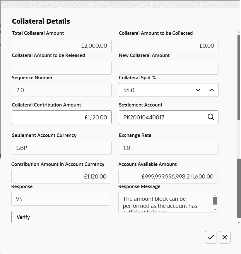

Collateral Details Below fields are displayed on the Collateral Details pop-up screen, if the user clicks plus icon. Total Collateral Amount Read only field. This field displays the total collateral amount provided by the user.
Collateral Amount to be Collected Read only field. This field displays the collateral amount yet to be collected as part of the collateral split.
Sequence Number Read only field. The sequence number is auto populated with the value, generated by the system.
Collateral Split % Specify the collateral split% to be collected against the selected settlement account. Collateral Contribution Amount Specify the collateral amount to be collected against the selected settlement account. User can either provide the collateral % where the collateral amount will be auto populated or modifying the collateral amount will auto correct the collateral %.
Settlement Account Click Search to search and select the settlement account for the collateral. Settlement Account Currency Read only field. This field displays the settlement account currency defaulted by the system.
Exchange Rate Read only field. This field displays the exchange rate, if the settlement account currency is different from the collateral currency.
Contribution Amount in Account Currency Read only field. This field displays the contribution amount in the settlement account currency as defaulted by the system.
Account Available Amount Read only field. System populates the account available amount on clicking the Verify button.
Response Read only field. System populates the response on clicking the Verify button.
Response Message Read only field. System populates the response message on clicking the Verify button.
Verify Click to verify the account balance of the Settlement Account. Save Click to to save and close the record. Close Click to cancel the entry. Cash Collateral Details grid Below fields appear in the along with the above fields. Contribution Amount This field displays the collateral contribution amount. The collateral % maintained for the customer is defaulted into the Collateral Details screen. If collateral % is not maintained for the customer, then system should default the collateral % maintained for the product. User can modify the defaulted collateral percentage, in which case system should display a override message “Defaulted Collateral Percentage modified.

Deposit Linkage Details pop-up screen Click plus icon to add new deposit linkage details. Below fields are displayed on the Deposit Linkage Details pop-up screen, if the user clicks plus icon.
Customer Id This field displays the defaulted from the application. The user can change the Customer ID.
Deposit Account Click Search to search and select deposit for linkage from the list of all the customer Deposits. All the Deposits of the customer should be listed in the LOV search. User should be able to select the deposit for linkage.
Deposit Branch Read only field. This field displays the deposit branch which will be auto-populated based on the deposit account selection.
Deposit Available Amount Read only field. This field displays the deposit available amount and currency which will be auto-populated based on the deposit account selection.
Deposit Maturity Date Read only field. This field displays the maturity date of deposit based on the deposit account selection.
Exchange Rate Read only field. This field displays the latest exchange rate for deposit linkage.
This will be picked up from the exchange rate maintenance from the common core.
Deposit Available In Transaction Currency Read only field. This field displays the deposit amount available, after exchange rate conversion, if applicable.
Linkage Percentage % Specify the value for linkage percentage. Linkage Amount (Transaction Currency) This field displays the transaction amount, user can change the value. System validates the linking amount with available Deposit balance and should not allow to link more than the available amount.
Deposit Details grid Below fields appear in the Deposit Details grid along with the above fields. Deposit Currency This field displays the deposit currency. Transaction Currency This field displays the transaction currency. Edit Click edit link to edit the deposit linkage details. - Click Save and Close to save the details and close the

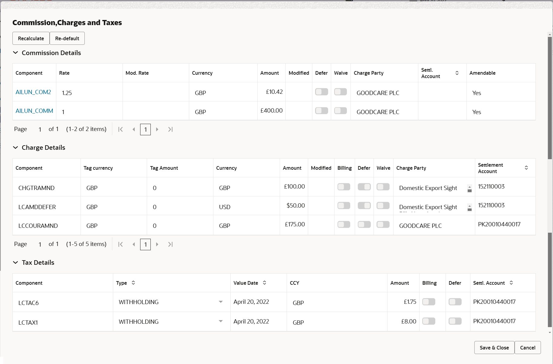

Charge Details
This section displays charge details, commission and tax components mapped to the product from the back office system. If default charges are available under the product, they should be defaulted here with values. If customer or customer group specific charges are maintained, then the same will be defaulted from back end system.For more information on fields, refer to the field description table below.
Table 2-16 Charge Details - Field Description
Field Description Commission Details This section displays the commission details. By default, all the charges, commission and margin are collected from the counter-party.
Component Displays the commission component. Click the link to view the component details.
Rate Displays the rate that is defaulted from product. The commission rate, if available in Back Office defaults in OBTFPMCS.
If flat commission is applicable, then commission amount defaulted from back office is modifiable by the user. Rate field will be blank and the user cannot modify the Rate field.
Mod. Rate From the default value, if the rate is changed the value gets updated in this field. The user can change the value.
Currency Displays the currency in which the commission have to be collected. Amount Displays the amount that is maintained under the product code. The commission rate, if available in Back Office defaults in OBTFPMCS. The user is able to change the rate, but not the commission amount directly. The amount gets modified based on the rate changed and the new amount is calculated in back office based on the new rate and is populated in OBTFPMCS.
Modified From the default value, if the amount is changed, the value gets updated in the modified amount field. Defer Switch to
for charges/commissions has to be deferred and
collected at any future step.
Waive Switch to
to waive the charges/commissions.
Based on the customer maintenance, the charges/commission can be marked for Billing or Defer.
If the defaulted Commission is changed to defer or billing or waive, system must capture the user details and the modification details in the ‘Remarks’ place holder.
Charge Party Charge party is 'Applicant' by default. User can change the value to Beneficiary. Settl. Account The settlement account. Amendable Displays if the field is amendable or not. Charge Details This section displays the charge details. Component Displays the charge component type. Tag Currency Displays the tag currency in which the charges have to be collected. Tag Amount Displays the tag amount that is maintained under the product code. Currency Displays the currency in which the charges have to be collected. Amount This field displays the amount that is maintained under the product code. Modified From the default value, if the rate is changed or the amount is changed, the value gets updated in the modified amount field. Billing Switch to
to make the details available for billing engine for
further processing, if charges are handled by separate
billing engine.
On simulation of charges/commission from Back Office, if any of the Charges/Commission component for the customer is ‘Billing’ enabled, ‘Billing’ toggle for that component should be automatically enabled in OBTFPMCS.
The user can not enable/disable the option, if it is de-selected by default.
This field is disabled, if ‘Defer’ toggle is enabled.
Defer Switch to
to defer the charges and collect at any future
step.
On simulation of charges/commission from Back Office, if any of the Charges/Commission component for the customer is AR-AP tracking enabled, ‘Defer’ toggle for that component should be automatically checked in OBTFPMCS.
The user can enable/disable the option the check box. On de-selection the user has to click on ‘Recalculate’ charges button for re-simulation.
Waive Switch to
to waive the charges.
Based on the customer maintenance, the charges should be marked for Billing or for Defer.
This field is disabled, if Defer toggle is enabled.
Charge Party Displays the charge party. By default the charge party is ‘Applicant’. Settlement Account Click Search icon to search and select the settlement account. Tax Details This section displays the tax details. The tax component is calculated based on the commission and defaults if maintained at product level. User cannot update tax details and any change in tax amount on account of modification of charges/ commission will be available on click of Re-Calculate button or on hand off to back-end system.
Component Displays the tax component. Type Displays the type of tax component. Value Date Displays the value date of tax component. Ccy Displays the currency in which the tax have to be collected. The tax currency is the same as the commission.
Amount Displays the tax amount based on the percentage of commission maintained. The user can edit the tax amount, if applicable.
Billing Switch to
further processing, if taxes are handled by separate billing
engine.
Defer Switch to
to defer the taxes and collect at any future step.
Switch to
if you do not want to defer the taxes.
On disabling the user has to click on ‘Recalculate’ charges button for re-simulation.
Settl. Account System defaults the settlement account. The user can modify the settlement account.

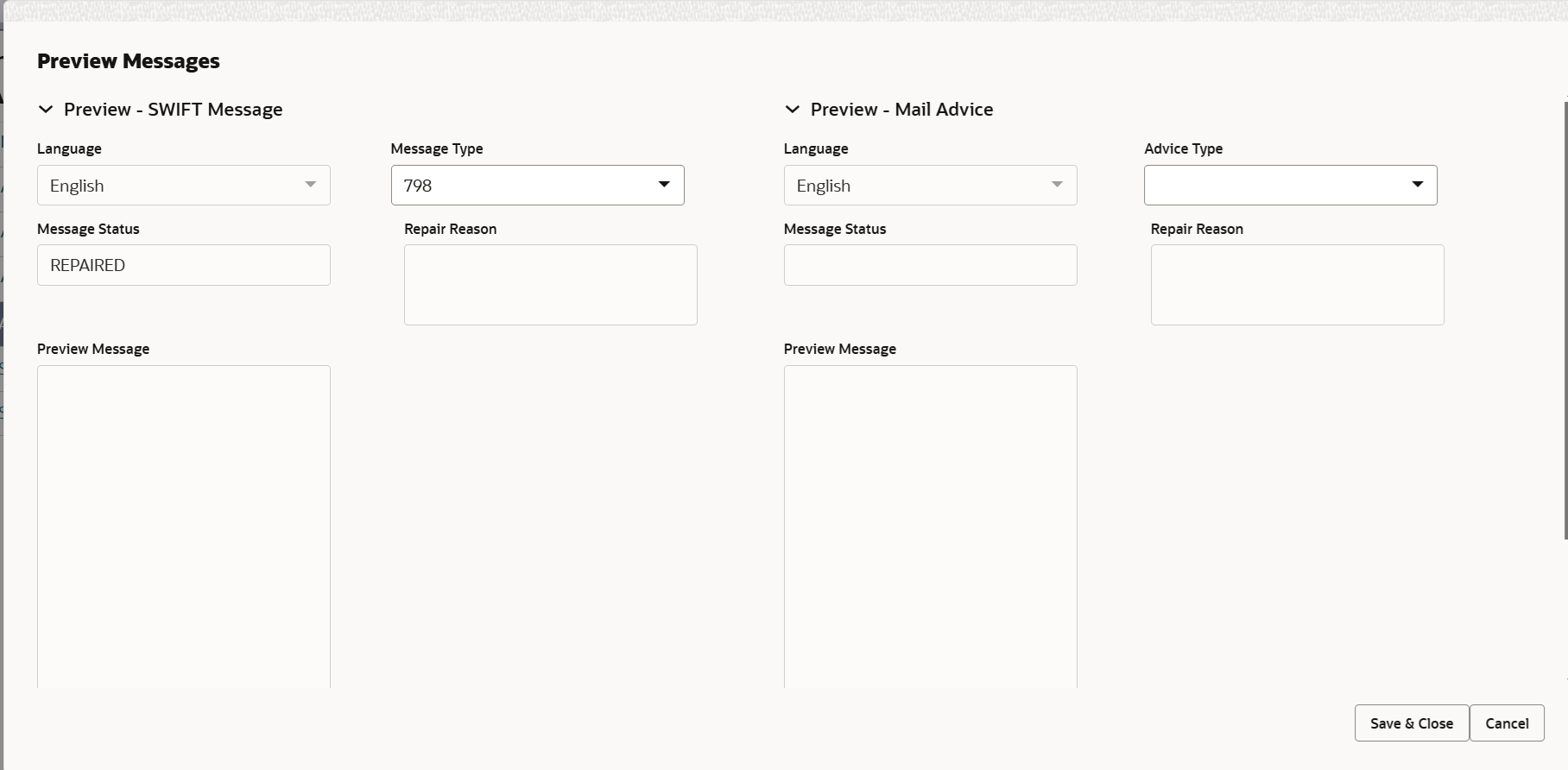

screen.Preview Messages
The draft LC message from the back office should be simulated and displayed in the Preview Message tile.
Description of the illustration deadditionaldetailspreview.pngFor more information on fields, refer to the field description table below.
Table 2-17 Preview Messages - Field Description
Field Description Preview SWIFT Message This section displays the preview of SWIFT Messages fields. Language Read only field. English is set as default language for the preview.
Message Type Select the message type. Message Status Read only field. Display the message status of draft message of internal amendment details.
Repair Reason Read only field. Display the message repair reason of draft message of internal amendment details.
Preview Message This field displays a preview of the draft message. Preview Mail Advice This section displays the preview of Mail Advice fields. Language Read only field. English is set as default language for the preview.
Advice Type Select the advice type. Message Status Read only field. Display the message status of draft message of internal amendment details.
Preview Message This field displays a preview of the advice. Draft Confirmation This section displays the draft confirmation fields. Draft Confirmation Required Switch to
, if draft confirmation is required.
Customer Response Specify the response received from customer. If the response is received online, the response is auto populated in this field by the system.
Customer Remarks Read only field. Display the remarks from the customer for the draft.
Response Date Read only field. Display the customer response received date.
Customer Email ID 1 Click Search icon to search and select the Email ID from lookup. The user can select from the Customer Email Address field of the customer maintenance in Back Office and replicated in OBTFPMCS.
By default this field is blank.

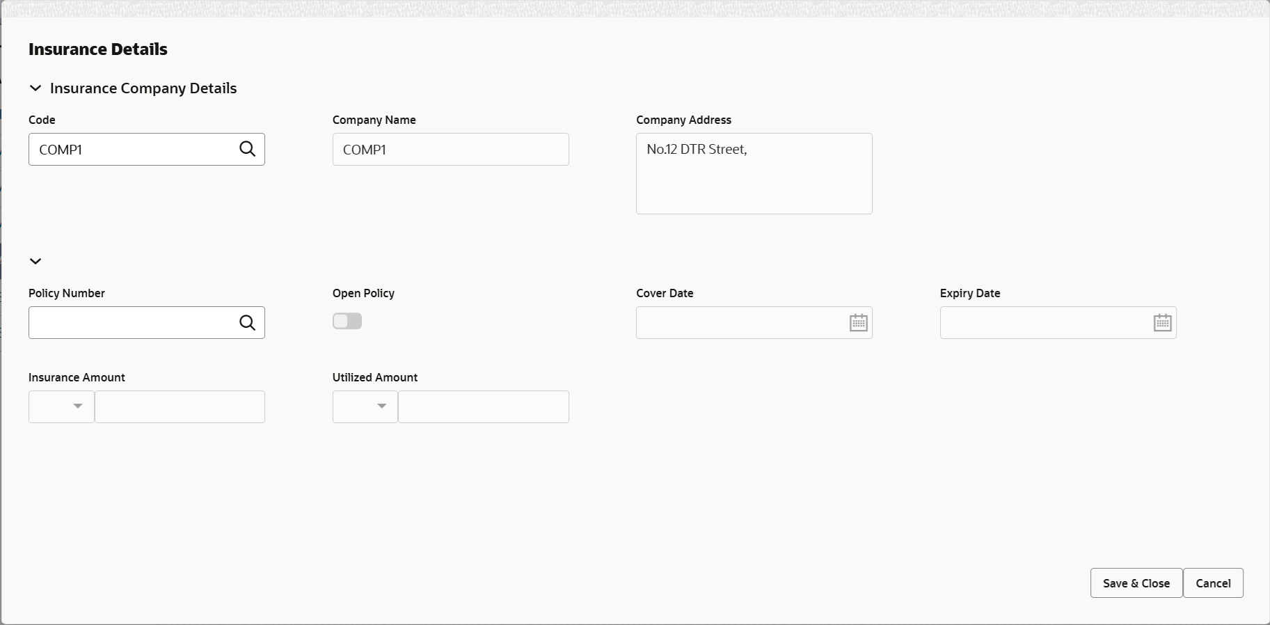

screen.Insurance Details
Provide the Insurance details based on the description in the following table.
Description of the illustration deinsurancedetails.pngFor more information on fields, refer to the field description table below.Table 2-18 Insurance Details - Field Description
Field Description Code Click Search icon to search and select insurance company code. Company Name This field displays the insurance company name as per the selected company code. Company Address This field displays the insurance company adress details as per the selected company code. Policy Number Click Search icon to search and select the policy number of the insurance. Open Policy Read only field. If enabled, this field denotes whether the policy is an open policy.
Cover Date The cover date of the policy. Expiry Date The Expiry Date of the Policy. System displays an override if the policy is expired.
Insurance Amount The insurance amount for the policy. Utilized Amount This field displays the utilized amount, if the policy is an Open Policy. - Click Save and Close to save the details and close the

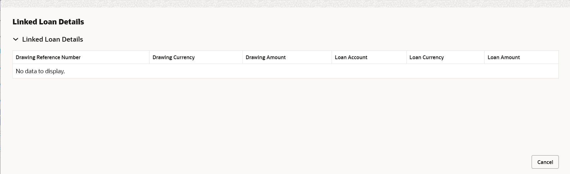

screen.Linked Loan Details
The bank user can view the details of linked loan accounts.
Description of the illustration delinkedloandetails.pngFor more information on fields, refer to the field description table below.
Table 2-19 Linked Loan Details - Field Description
Field Description Linked Loan Details Drawing Reference Number This field displays the drawing reference number of the linked loan account. Drawing Currency This field displays the drawing currency of the linked loan account. Drawing Amount This field displays the drawing amount of the linked loan account. Loan Account This field displays the loan account number. Loan Currency This field displays the currency of the loan account. Loan Amount This field displays the loan amount. - Click Save and Close to save the details and close the

- Reduction of LC contract amount with FX, through LC amendment will be restricted, when the contract amount goes below the FX linkage amount. User will be intimated with the message.
Description of the illustration fxlinkagedetails.pngFor more information on fields, refer to the field description table below.
Table 2-20 FX Linkage - Field Description
Field Description FX Details. Below fields are displayed on the FX Linkage pop-up screen, if the user clicks the plus icon.
FX Reference Number Click Search to search and select the FX contract reference number. On select and save and close, system defaults the available amount, bot currency, sold currency and rate. Forward FX Linkage available for selection at bill would be as follows,- Counterparty of the FX contract should be the counterparty of the Bill contract.
- Active Forward FX transactions authorized not marked for auto liquidation.
Bill contract currency should be BOT currency of the FX transaction in case of an export Bill or the SOLD currency in case of an Import Bill.
Currency Read only field. This field displays the FX SOLD currency from the linked FX contract.
Contract Amount This field displays the FX SOLD currency and Amount. The user can change the currency. Available FX Contract Amount Read only field. This field displays the available FX contract amount.
The value is from the “Available Amount” in FXDLINKG screen in OBTR.
Available Amount SOLD currency and Amount is displayed.
Linkage Amount System defaults the amount available for linkage. The Linkage amount should default the LC Contract Currency and allowed to change the linkage amount alone.
The validation “Sum of Linked amount will not be greater than contract amount” or “Linkage amount will not be greater than the available amount for linkage” should be triggered on save of the FX linkage screen when trying to link the single FX or multiple FX.
Rate Read only field. This field displays the rate at which the contract is booked.
FX Amount in Local Currency Read only field. This field displays the FX amount in local currency.
The value is defaulted as FX BOT currency and Amount from FXDTRONL
FX Expiry Date Read only field. This field displays the expiry date from the linked FX contract.
FX Delivery Period - From Read only field. This field displays the date from which the contract is valid for utilization.
FX Delivery Period - To Read only field. This field displays the date to which the contract is valid for utilization.
FX Linkage grid Below fields appear in the FX linkage grid along with the above fields. Bought Currency Read only field. This field displays the currency from the linked FX contract.
Sold Currency Read only field. This field displays the currency from the linked FX contract.
Available Contract Amount Read only field. Available amount will be FX contract amount minus the linked amount. Available amount for linkage should be greater than Zero.
Linked Amount Sum of Linked amount will not be greater than LC contract amount. Linked amount will not be greater than the available amount for linkage.
Total Utilized Amount Read only field. This field displays the total amount utilized against the corresponding linked FX.
On query, both Utilized and Total Utilized amount holds the amount of latest version.
The value is Total Utilized Amount SOLD currency and Amount for Import LC/Guarantee Issuance from FXDLINKG .
Average FX Rate Read only field. Multiple forward FX contract could be linked,and exchange rate of FX contract vary from each. Hence, effective exchange rate for bill would be arrived using weighted average method and it is utilized during purchase/negotiation/discount or liquidation of the bill. This will be populated in the Average FX Rate.
Action Click Edit icon to edit the FX details. Click Delete icon to delete the FX details.
- Click Next.The task will move to next data segment.
For more information on action buttons, refer to the field description table below.
Table 2-21 Additional Details - Action Buttons - Field Description
Field Description Clarification Details Clicking the button opens a detailed screen, user can see the clarification details in the window and the status will be 'Clarification Requested'. Documents Click to View/Upload the required document. Application displays the mandatory and optional documents.
The user can view and input/view application details simultaneously.
When a user clicks on the uploaded document, Document window get opened and on clicking the view icon of the uploaded document, Application screen should get split into two. The one side of the document allows to view and on the other side allows to input/view the details in the application.Remarks Specify any additional information regarding the Import LC Internal Amendment. This information can be viewed by other users processing the request. Content from Remarks field should be handed off to Remarks field in Backend application.
Overrides Click to view the overrides accepted by the user. Customer Instruction Click to view/ input the following - Standard Instructions – In this section, the system will populate the details of Standard Instructions maintained for the customer. User will not be able to edit this.
