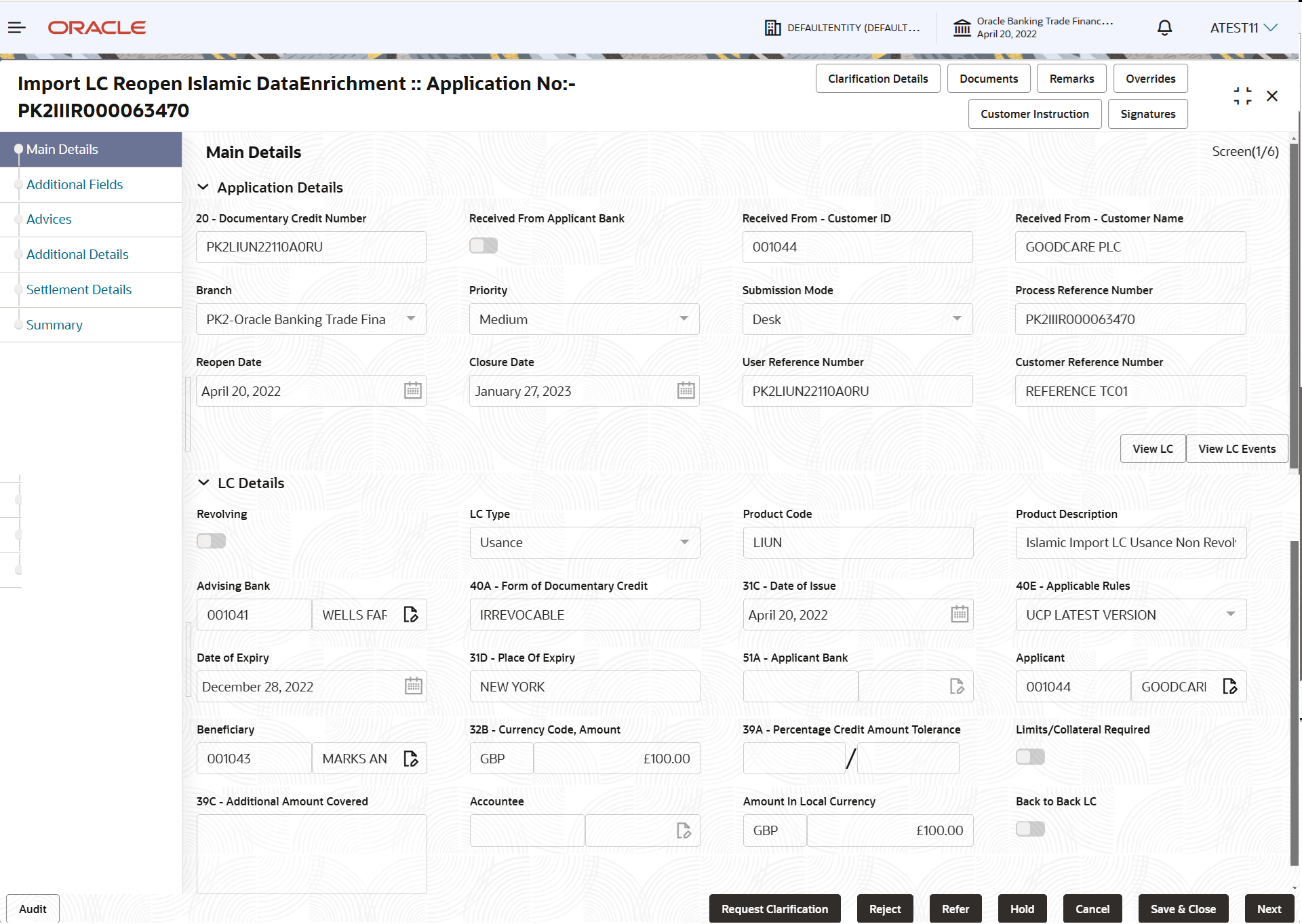

- On Data Enrichment - Main Details screen, specify the
fields that were not entered at Registration stage.For more information on fields, refer to the field description table below.
Figure 2-7 Data Enrichment - Main Details
Description of the illustration demainapplicationdetails.pngField Description Documentary Credit Number Read only field. The drawing reference number as selected in the Registration stage.
Received From Applicant Bank Read only field. Displayed as available from earlier stage.
Received From - Customer ID Read only field. Displayed as available from earlier stage.
Received From - Customer Name Read only field. Displayed as available from earlier stage.
Branch Read only field. Displayed as available from earlier stage.
Priority Read only field. System will populate the priority of the customer based on priority maintenance. If priority is not maintained for the customer, system will populate 'Medium' as the default priority.
Submission Mode Read only field. Displayed as available from earlier stage.
Process Reference Number Read only field. Displayed as available from earlier stage.
Reopen Date Read only field. Displayed as available from earlier stage.
Closure Date Read only field. Displayed as available from earlier stage.
User Reference Number Read only field. Displayed as available from earlier stage.
Customer Reference Number Read only field. Displayed as available from earlier stage.

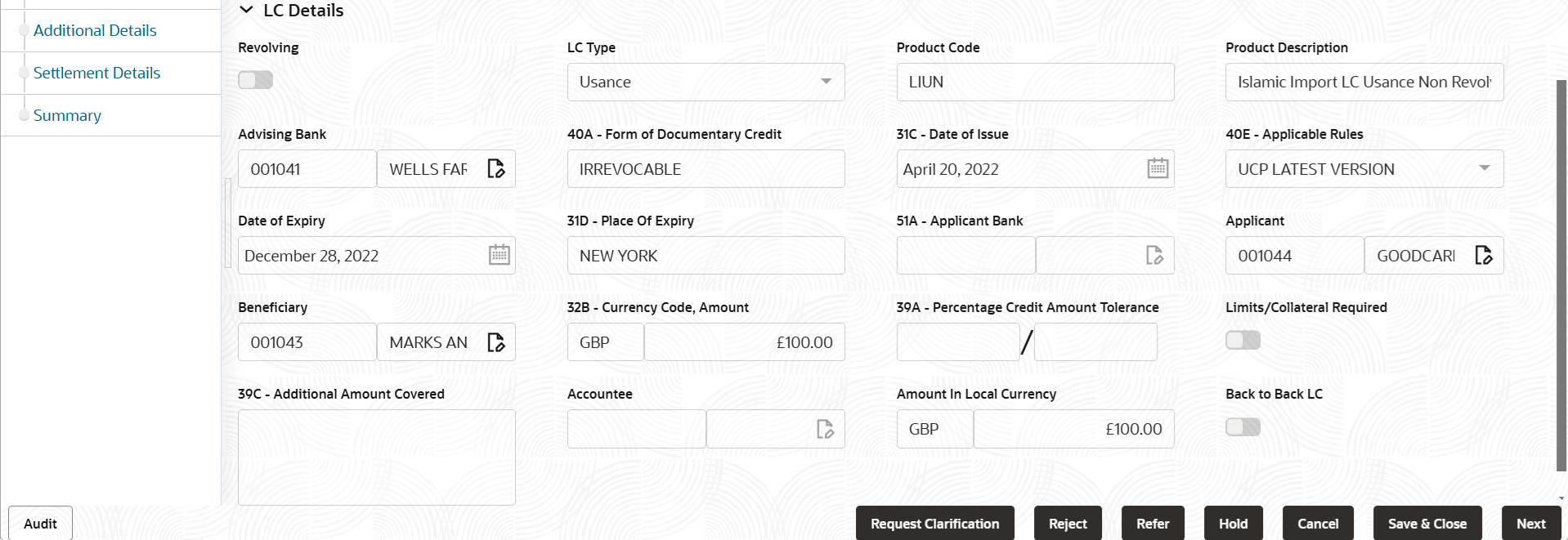

LC DetailsThe fields listed under this section are same as the fields listed under the LC Details section in Registration. All fields displayed in LC details section are read only fields.
For more information on fields, refer to the field description table below.Figure 2-8 LC Details
Description of the illustration demainlcdetails.pngTable 2-6 Data Enrichment - Main Details - Liquidation Details - Field Description
Field Description Revolving Read only field. This field displays the revolving value as per the latest LC details. LC Type Read only field. This field displays the LC type as per the latest LC details. Product Code Read only field. This field displays the product code used during LC Reopen. Product Description Read only field. This field displays the description as in Import LC. Advising Bank Read only field. This field displays the advising bank details as per the latest LC details. Form of Documentary Credit Read only field. This field displays the form of documentary credit details as per the selection done at the time of Import LC Issuance. Date of Issue Read only field. This field displays the LC issuance date. Applicable Rules Read only field. This field displays the applicable rule as per the latest LC details.
Date of Expiry Read only field. This field displays the expiry date as per the latest LC details.
Place of Expiry Read only field. This field displays the place of expiry as per the latest LC details.
Applicant Bank Read only field. This field displays the applicant bank details as per the latest LC details.
Applicant Read only field. This field displays the details of the applicant as per the latest LC details.
Beneficiary Read only field. This field displays the beneficiary details as per the latest LC details.
Currency Code, Amount Read only field. This field displays the currency code of LC along with the currency details as per the latest LC details.
Percentage Credit Amount Tolerance Read only field. This field displays the percentage credit amount tolerance details as per the latest LC details.
Limits/Collateral Required Read only field. Limits/Collateral applicable as per the latest LC details is displayed.
Additional Amount Covered Read only field. This field displays any additional amount covered as per the latest LC details.
Accountee Read only field. Accountee details as per the latest LC details is displayed.
Amount In Local Currency Read only field. Amount in local currency as per the latest LC details is displayed.
Back to Back LC Read only field. Back to Back LC as per the latest LC details is displayed.
