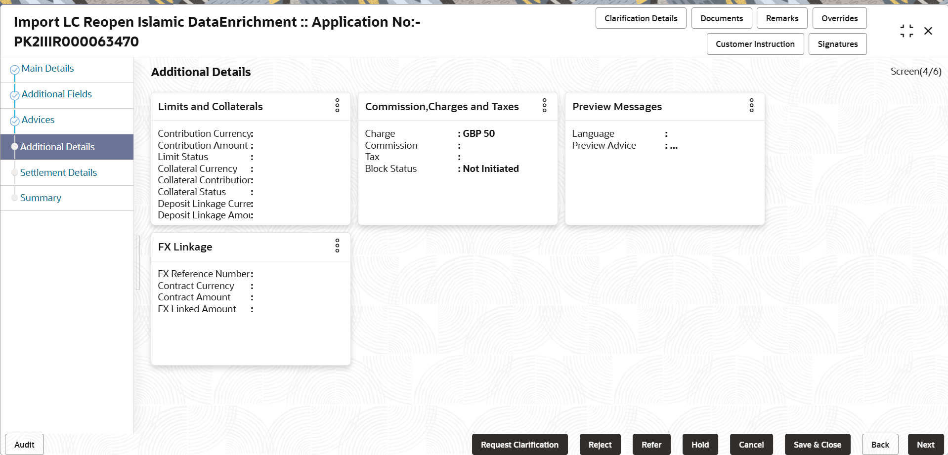

2.3.4 Additional Details
This topic provides the systematic instructions to capture the additional details.
- On Additional Details screen, click
on any Additional Details tile to view the details.Figure 2-11 Additional Details
Description of the illustration deadditionaldetails.png - Click Save and Close to save the details and close the screen.

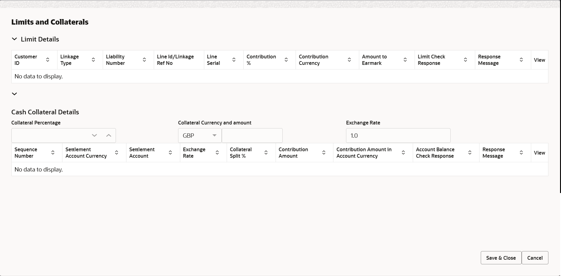

- Click click
on Limits and Collaterals tiles to view the
Limits and Collaterals screen.Limits and Collaterals
On Approval, system should not release the Earmarking against each limit line and system should handoff the “Limit Earmark Reference Number “to the back office. On successful handoff, back office will make use of these “Limit Earmark Reference Number” to release the Limit Earmark done in the mid office (OBTFPMCS) and should Earmark the limit from the Back office.
In case multiple Lines are applicable, Limit Earmark Reference for all lines to be passed to the back office.

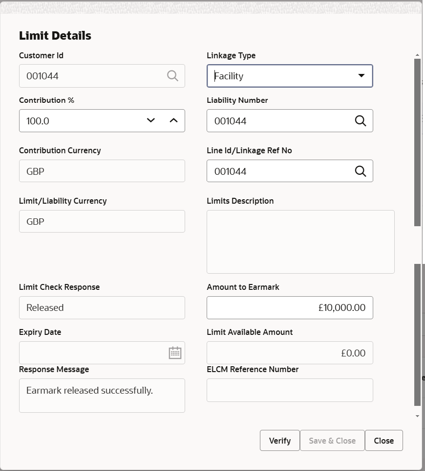

Table 2-11 Field Description - Limit Details
Field Description Limit Details Below fields are displayed on the Limit Details pop-up screen, if the user clicks plus icon. Click plus icon to add new limit details.
Customer ID This field displays the applicant’s/applicant bank customer ID defaulted from the application. The user can change the Customer ID.
Linkage Type Select the linkage type. Linkage type can be:
- Facility
- Liability
By default Linkage Type should be Facility.
Contribution % System defaults this field to 100%. User can modify this value. If contribution is more than 100%, system displays an alert message, if modified.
Once contribution % is provided, system defaults the amount.
System validates that if Limit Contribution% plus Collateral% is equal to 100. If the total percentage is not equal to 100 application will display an alert message.Note:
The collateral % maintained for the customer is defaulted into the Collateral Details screen. If collateral % is not maintained for the customer, then system should default the collateral % maintained for the product. User can modify the defaulted collateral percentage, in which case system should display a override message “Defaulted Collateral Percentage modified.Liability Number Click Search to search and select the Liability Number from the look-up. The list has all the Liabilities mapped to the customer.
Contribution Currency Read only field. This field displays the contribution currency.
Line ID/Linkage Ref No Click Search to search and select from the various lines available and mapped under the customer id list. LINE ID-DESCRIPTION will be available for selection along with Line ID. When you click on 'verify', the system will return value if the limit check was successful or Limit not Available. If limit check fails, the outstanding limit after the transaction value will be shown in the limit outstanding amount.
The user can click the Line Id link to view the limit details.Note:
User can also select expired Line ID from the lookup and on clicking the verify button, system should default “The Earmarking cannot be performed as the Line ID is Expired” in the “Response Message” field.This field is disabled and read only, if Linkage Type is Liability.
Limit/Liability Currency Read only field. This field displays the limit currency, when the user select the Liability Number.
Limits Description Read only field. This field displays the limits description.
Limit Check Response Read only field.This field displays the limit check response. Response can be ‘Success’ or ‘Limit not Available’ based on the limit service call response.
The value in this field appears, if you click the Verify button.
Amount to Earmark This field defaults the amount to earmark. Contribution amount will default based on the contribution %.
User can change the value.
Expiry Date Read only field. This field displays the date up to which the Line is valid.
Limit Available Amount Read only field. This field displays the value of available limit, i.e., limit available without any earmark. The Limit Available Amount must be greater than the Contribution Amount.
Response Message Read only field. This field displays the detailed response message. The value in this field appears, if you click the Verify button.
ELCM Reference Number Read only field. This field displays the ELCM reference number.
Limit Details grid Below fields appear in the Limit Details grid along with the above fields. Line Serial Displays the serial of the various lines available and mapped under the customer id. Edit Click the link to edit the Limit Details. Cash Collateral Details Specify the Collateral details based on the description of following table: Collateral Percentage System populates the Collateral % maintained in the Customer / Product for the counter party of the contract. User can modify the collateral percentage.
Specify the percentage of collateral to be linked to this transaction. If the value is more than 100% system will display an alert message. The collateral % maintained for the customer is defaulted into the Collateral Details screen. If collateral % is not maintained for the customer, then system should default the collateral % maintained for the product. User can modify the defaulted collateral percentage, in which case system should display a override message “Defaulted Collateral Percentage modified.
Collateral Currency and amount System populates the contract currency as collateral currency by default. User can modify the collateral Currency and amount.
Exchange Rate System populates the exchange rate maintained. System validates for the Override Limit and the Stop limit if defaulted exchange rate is modified.

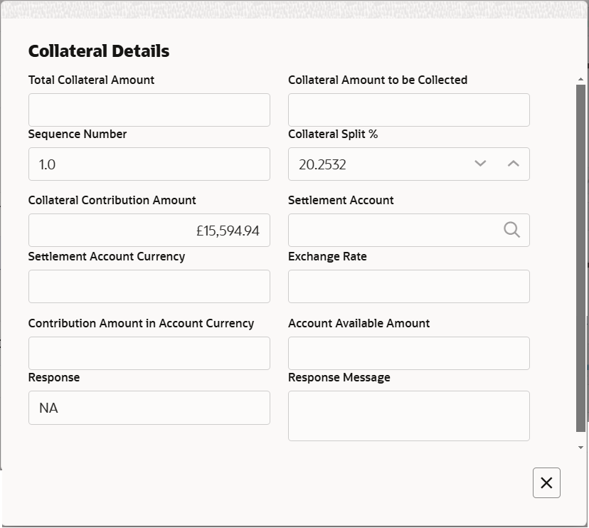

Collateral Details Below fields are displayed on the Collateral Details pop-up screen, if the user clicks plus icon. Total Collateral Amount Read only field. This field displays the total collateral amount provided by the user.
Collateral Amount to be Collected Read only field. This field displays the collateral amount yet to be collected as part of the collateral split.
Sequence Number Read only field. The sequence number is auto populated with the value, generated by the system.
Collateral Split % Specify the collateral split% to be collected against the selected settlement account. Collateral Contribution Amount Specify the collateral amount to be collected against the selected settlement account. User can either provide the collateral % where the collateral amount will be auto populated or modifying the collateral amount will auto correct the collateral %.
Settlement Account Click Search to search and select the settlement account for the collateral. Settlement Account Currency Read only field. This field displays the settlement account currency defaulted by the system.
Exchange Rate Read only field. This field displays the exchange rate, if the settlement account currency is different from the collateral currency.
Contribution Amount in Account Currency Read only field. This field displays the contribution amount in the settlement account currency as defaulted by the system.
Account Available Amount Read only field. System populates the account available amount on clicking the Verify button.
Response Read only field. System populates the response on clicking the Verify button.
Response Message Read only field. System populates the response message on clicking the Verify button.
Verify Click to verify the account balance of the Settlement Account. Save Click to to save and close the record. Close Click to cancel the entry. Cash Collateral Details grid Below fields appear in the along with the above fields. Contribution Amount This field displays the collateral contribution amount. The collateral % maintained for the customer is defaulted into the Collateral Details screen. If collateral % is not maintained for the customer, then system should default the collateral % maintained for the product. User can modify the defaulted collateral percentage, in which case system should display a override message “Defaulted Collateral Percentage modified.
Account Balance Check Response This field displays the account balance check response. Edit Click edit link to edit the collateral details. Account Available Amount This field displays the account available amount which will be auto-populated based on the settlement account selection. Deposit Linkage Details Specify the deposit linkage details based on the description of following table: System should allow the user to Link one or more existing Deposits as a contribution to secure underlying transactions. On Submit of DE stage, system will create Linkage of the Deposit/modification of existing Linkage by calling Back-office system (DDA) system directly.

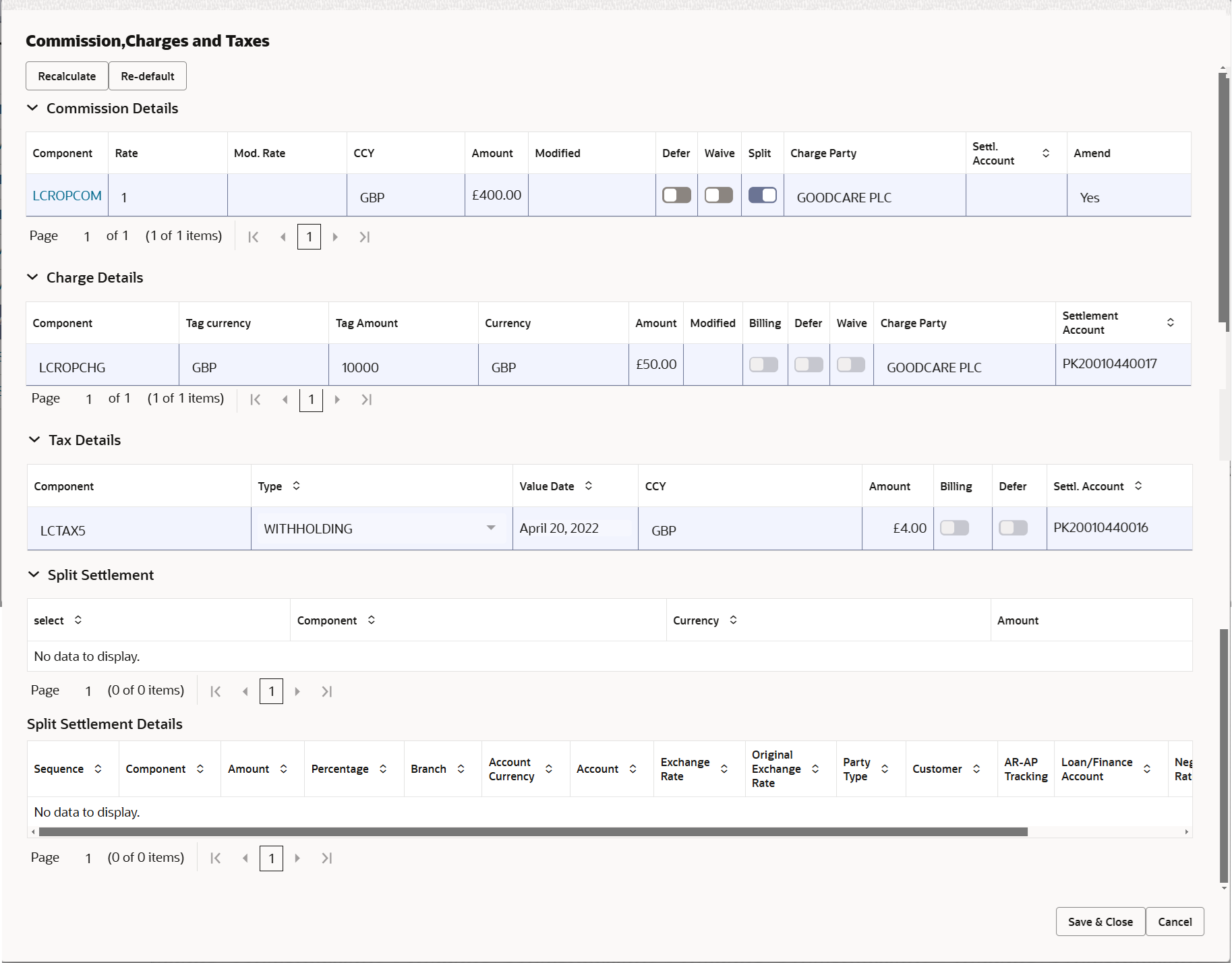

Commission,Charges and Taxes
In Additional Details section, default commission, charges and tax if any, will get populated.
If default charges are available under the product, they should be defaulted here with values. If customer or customer group specific charges are maintained, then the same will be defaulted from back end system.For more information on fields, refer to the field description table below.
Table 2-12 Commission,Charges and Taxes - Field Description
Field Description Commission Details This section displays the commission details. Component Read only field. This field displays the commission component.
Click the link to view the component details.
Rate Read only field. This field displays the rate that is defaulted from product.
The commission rate, if available in Back Office defaults in OBTFPMCS. The user is able to change the rate.
If flat commission is applicable, then commission amount defaulted from back office is modifiable by the user. Rate field will be blank and the user cannot modify the Rate field.
Modified Rate From the default value, if the rate is changed the value gets updated in this field. The user can change the value.
Currency Read only field. This field displays the currency in which the commission have to be collected.
Amount Read only field. This field displays the amount that is maintained under the product code.
The commission rate, if available in Back Office defaults in OBTFPMCS. The user is able to change the rate, but not the commission amount directly. The amount gets modified based on the rate changed and the new amount is calculated in back office based on the new rate and is populated in OBTFPMCS.
Modified From the default value, if the amount is changed, the value gets updated in the modified amount field. The user can change the value.
Defer Switch to
, if charges/commissions has to be deferred and
collected at any future step.
Waive Switch to
to waive the charges/commissions.
Based on the customer maintenance, the charges/commission can be marked for Billing or Defer.
If the defaulted Commission is changed to defer or billing or waive, system must capture the user details and the modification details in the ‘Remarks’ place holder.
Split Switch to
for splitting the Commission.
Switch to
if splitting of commission is not
required.
Charge Party Read only field. Charge party is 'Applicant' by default.
Settlement Account Read only field. This field displays the settlement account.
Amend Read only field. Displays if the field is amendable or not.
Charge Details This section displays the charge details. Component Read only field. This field displays the charge component type.
Tag Currency Read only field. This field displays the tag currency in which the charges have to be collected.
Tag Amount Read only field. This field displays the tag amount that is maintained under the product code.
Currency Read only field. This field displays the currency in which the charges have to be collected.
Modified From the default value, if the rate is changed or the amount is changed, the value gets updated in the modified amount field. The user can change the value.
Billing If charges are handled by separate billing engine, switch to
, the details to be available for billing engine
for further processing.
On simulation of charges/commission from Back Office, if any of the Charges/Commission component for the customer is ‘Billing’ enabled, ‘Billing’ toggle for that component should be automatically enabled in OBTFPMCS.
The user can not enable/disable the option, if it is de-selected by default.
This field is disabled, if ‘Defer’ toggle is enabled.
Defer Switch to
, if charges have to be deferred and collected at
any future step.
On simulation of charges/commission from Back Office, if any of the Charges/Commission component for the customer is AR-AP tracking enabled, ‘Defer’ toggle for that component should be automatically checked in OBTFPMCS.
The user can enable/disable the option the check box. On de-selection the user has to click on ‘Recalculate’ charges button for re-simulation.
Waive Switch to
, if charges has to be waived.
Based on the customer maintenance, the charges should be marked for Billing or for Defer.
This field is disabled, if Defer toggle is enabled.
Settlement Account System defaults the settlement account is in this field. The user can change the settlement account.
Tax Details This section displays the tax details. The tax component is calculated based on the commission and defaults if maintained at product level. User cannot update tax details and any change in tax amount on account of modification of charges/ commission will be available on click of Re-Calculate button or on hand off to back-end system.
Component Read only field. This field displays the tax component.
Type Read only field. This field displays the type of tax component.
Value Date Read only field. This field displays the value date of tax component.
Currency Read only field. This field displays the currency in which the tax have to be collected.
The tax currency is the same as the commission.
Amount Read only field. This field displays the tax amount based on the percentage of commission maintained.
Billing If taxes are handled by separate billing engine, switch to
, billing the details to be available for billing
engine for further processing.
Defer Switch to
any future step.
Settlement Account System defaults the settlement account. The user can modify the settlement account.
Split Settlement This section displays the Split Settlement. This section is displayed if the user clicks on the Recalculate button to fetch the Split Settlement details from Backoffice.
The default parties in Split row should be fetched from OBTF.
Select The option to select the split settlement record. Component Displays the split component type eligible for Split . Currency Displays the currency of split settlement. Amount Displays the amount of split settlement. Split Settlement Details This section displays the Split Settlement details. Split Settlement details section appears from Back office, when the user clicks on the Recalculate button. Seqence Displays the sequence number is auto populated with the value, generated by the system. Component Displays the split component type eligible for Split. Amount The system splits the respective Charge/Commission amount automatically between counter party and third party with 50% value by default. The bank user can modify the amount.
More than two splits are not allowed.
Customer Indicates the ID of the Customer in Split Settlement Details section. GL Account The system defaults the GL account. Account The system defaults the Settlement account. User can modify the settlement account. System initiates a call to common core tables within OBTFPMCS to select the account.
Account Currency This field defaults the currency of the account. Branch Indicates the branch of the customer where transaction is getting processed. Percentage The system splits the respective Charge/Commission percentage automatically between counter party and third party with 50% value by default. More than two splits are not allowed.
The system should validate that the total percentage of each component doesn't exceed 100 and the total amount of each component doesn't exceed total component amount.
Exchange Rate System populates the exchange rate maintained. Original Exchange Rate Displays the Original Exchange Rate as simulated in split settlement details section. Party Type Displays the party type in split settlement details section. Negotiation Reference Specify the negotiation reference number. AR-AP Tracking Indicates to defer the charge/ commission in Split Settlement Details section. The user can modify the AR-AP Tracking flag as per the requirements.
Loan/Finance Account Displays the loan account. Negotiation Rate Displays the negotiation rate. Negotiation Reference Displays the negotiation reference. - Click Save and Close to save the details and close the

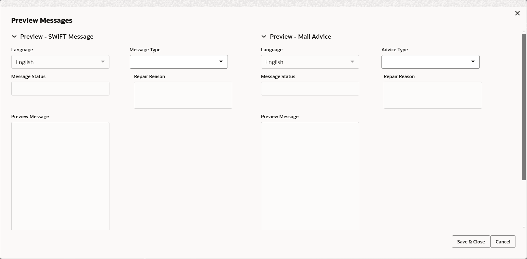

screen.Preview Messages
The bank user can view a preview of the message and advice simulated from back office which is based on the details captured in the previous screen.
Description of the illustration deadditionaldetailspreview.pngFor more information on fields, refer to the field description table below.
Field Description Preview SWIFT Message This section displays the preview of SWIFT Messages fields. Language Read only field. English is a default selected language.
Message Type Select the message type. Message Status Read only field. Display the message status of draft message of liquidation details.
Repair Reason Read only field. Display the message repair reason of draft message of liquidation details.
Preview Message This field displays a preview of the draft message. Preview Mail Advice This section displays the preview of Mail Advice fields. Language Read only field. English is set as default language for the preview.
Advice Type Select the advice type. Message Status Read only field. Display the message status of draft message of liquidation details.
Preview Message This field displays a preview of the advice. - Click Save and Close to save the details and close the screen.
- Next.
- Click Next.The task will move to next data segment.
