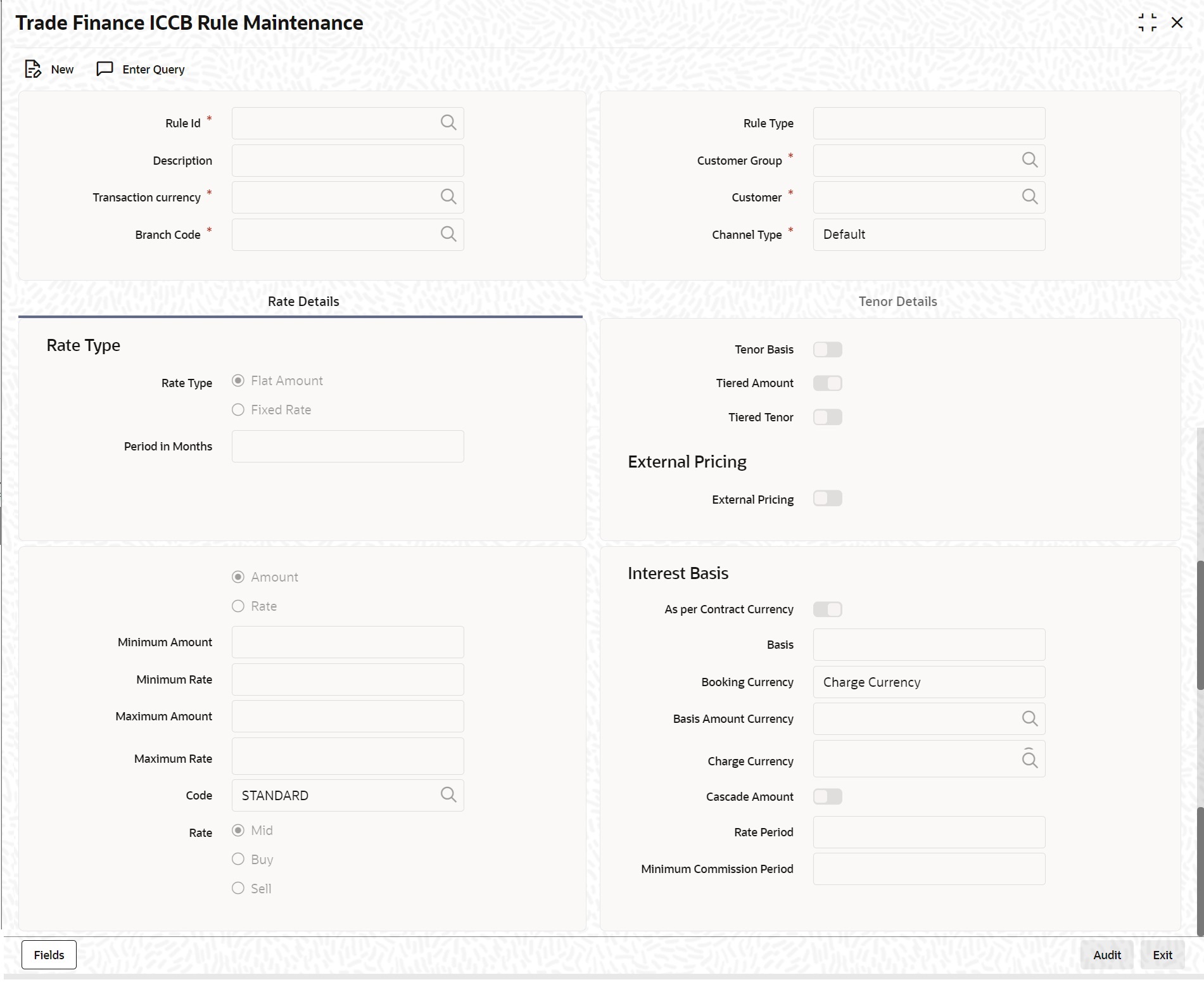

  1. On Homepage, type 'CFDTFRLM' in the text box, and click next arrow.
    A charge rule is built with the logic to calculate a specific type of charge component. You can maintain this logic in the ‘Trade Finance ICCB Rule Maintenance’ screen.
    The ‘Trade Finance ICCB Rule Maintenance’ screen is displayed:
  2. On ‘Trade Finance ICCB Rule Maintenance’ screen, specify the fields.

    Table 1-4 Trade Finance ICCB Rule Maintenance - Field Description
    Field Description
    Rule Type
    The Rule Type identifies the type of component you are defining. The attributes applicable for a component depend on the Rule Type. In this chapter, we shall discuss the procedure for setting up rules for charge components.
    For every rule that you define, you can enter a description. Specifying a description helps identify a rule.
    Rule Identification
    Every charge rule is identified by a unique ten-character code, called a Rule ID. You can link a valid Charge Rule ID to the charge classes that you maintain in your bank. Charges or fees for all products with which you associate a charge class, will be calculated on the basis of the Rule ID that is associated with the class.

    Transaction Currency
    If you wish to define the attributes for all currencies, you can select the ALL option in the Currency Code field to indicate this. If you are maintaining the attributes for the selected ICCB rule in specific currency other than the ALL, select the Transaction Currency on which the rule mapping maintenance is to be made applicable.
    Customer Group
    Select the customer group on which the rule mapping maintenance is to be made applicable.
    You can create a generalized charge rule mapping record by selecting the ALL option in the Customer Group field. This specification is defaulted to the Customer and Customer Account fields. You will not be allowed to change the specification.
    Customer
    Specify the customer identification number (CIF) of the customer for whom you are maintaining the rule mapping.
    Branch Code
    If you are maintaining the attributes for the selected ICCB rule from the head office branch,you can select the branch for which the attributes are being defined. If you wish to define the attributes for all branches, you can select the ALL option in the Branch Code field to indicate
    this.
    If you are maintaining the attributes for the selected ICCB rule from a branch other than the head office, you can only select those branches that are found in the allowed list of branches for:
    • The ICCB rule definition Restriction Type (ICCBRULE), in the Common Branch Restrictions maintenance for the current branch
    • The selected rule being built, according to the ICCB Rule Availability maintenance.
    In other words, the option list in the Branch Code field would display only those branches that are allowed both for the rule and the current branch.
    The following example illustrates how the option lists in the Rule ID and Branch Code fields are populated:
    Channel Type Select the channel type from the drop down. By default, the selected channel type will be 'Default'.
    Rate Type
    The rate type indicates whether the charge or fee to be applied for the Rule ID is a flat amount or a percentage of the basis amount. Basis amount here refers to:
    • Principal amount or commitment
    • Transaction amount in the case of a teller entry
    • Transfer amount in case of a Remittance
    • LC amount in the case of a Letter of Credit
    • Bill amount in the case of a Bill
    If the Charge Rule that you are defining calculates charges on a rate basis, choose the Fixed Rate option. To levy a flat amount as charge, say a postal charge on the products that are associated with the Charge Class, choose the ‘Flat Amount’ option.
    You can choose to indicate the Rate Code and whether the rate is Mid, Buy or Sell only when the basis amount currency and the rate currency is different from the contract currency. The rate code is used to arrive at the exchange rate if the rate currency is different from the contract currency. The system arrives at the exchange rate from the parameters specified for the currency pair in the Currency Pair Definition table.
    If the charge is based on the Flat Amount, 'Min Amount' and 'Max Amount' are not applicable.
    Refer to the chapter on ‘Currency Maintenance’ in the Core Services User Manual for more information on parameters of currency pairs.
    Tenor Basis
    You can create a charge rule that would calculate charges on the basis of Tenor slabs. Check the ‘Tenor Basis’ check box if the Charge is calculated based on the Tenor.
    Tiered Tenor
    Charges calculated on the basis of Charge Rates for different layers of the Tenor.
    Booking Currency
    Select the booking currency from the drop-down list. You can choose one of the following options:
    • Contract Currency - If you select this, the system will calculate the charge in the currency specified in the field 'Contract Currency'.
    • Charge Currency - If you select this, the system will calculate the charge in the currency specified in ‘Charge Currency’.
    Based on the booking currency specified, the system will decide the currency in which the charge needs to be calculated.
    Basis Amount and the Charge Currencies
    The charge currency is the currency, which will be associated with the charge that is calculated or the flat charge amount.
    When building a charge rule, if the Rate Type is a Flat Amount, you have to indicate the currency of the charge or fee. The charge or fee when applied on a transaction will be collected in this currency. The input to this field can be any currency that is maintained as part of Currency Definition in Oracle Banking Trade Finance Cloud
            Service
    The amount itself is specified subsequently through this screen. This amount can be changed during contract processing.
