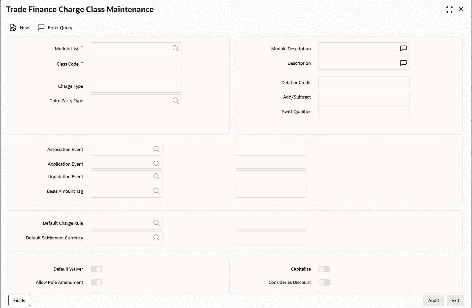

Specify User ID and Password, and login to Homepage.
  1. On Homepage, type ‘CFDTFCCM' in the text box, and click next arrow.
    You can define the attributes of a charge class in the ‘Trade Finance Charge Class Maintenance’ screen, loaded from the Application Browser.
    The ‘Trade Finance Charge Class Maintenance’ screen is displayed.
  2. On ‘Trade Finance Charge Class Maintenance’screen, specify the fields.
    For more information about the fields, refer Table 1-5:

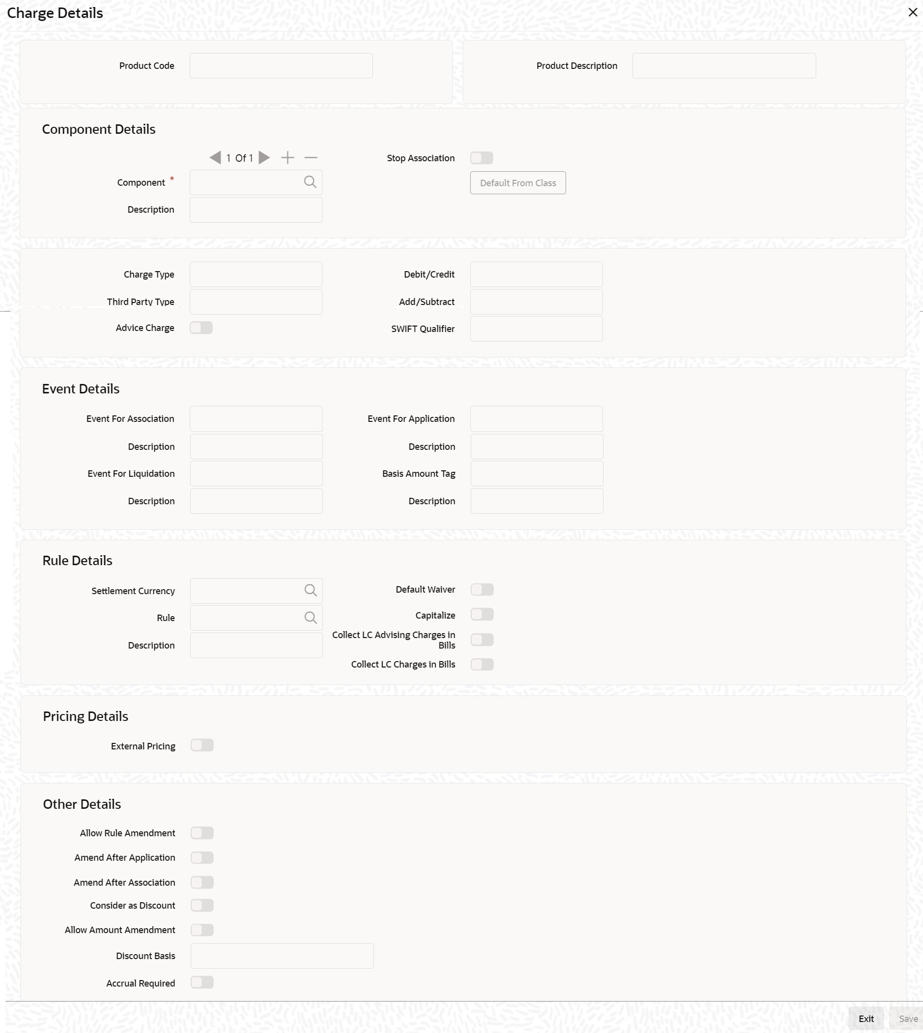

  3. On ‘Product Definition’ screen, click ‘Charges’ button.
    You can specify the charge components applicable to a product.
    The ‘Charge Details’ screen is displayed:
    You should necessarily use a charge class to indicate the charge components applicable to a product. (A charge class is a specific type of component that you can build with certain attributes.)
