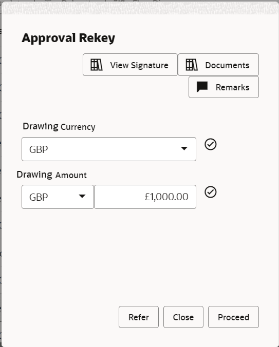

    Authorization Re-Key (Non-Online Channel)
    For non online channel, application will request approver for few critical field values as an authorization step. If the values captured match with the values available in the screen, system will allow user to open the transaction screens for further verification. If the re-key values are different from the values captured, then application will display an error message.
    Rekey is not applicable in case of processing Drawing of Incoming SWIFT MT 750. System will display the approval screens directly as the details have been auto populated from incoming SWIFT message.
  2. Open the task and specify (re-key) some of the critical field values from the request in the Re-key screen. Some of the fields below will dynamically be available for re-key.
    • Drawing Currency
    • Drawing Amount
    Re-key is applicable to the first approver in case of multiple approvers. All approvers will however be able see the summary tiles and the details in the screen by drill down from tiles.
    Figure 2-33 Authorization Re-Key
    Description of approvalrekey.png follows

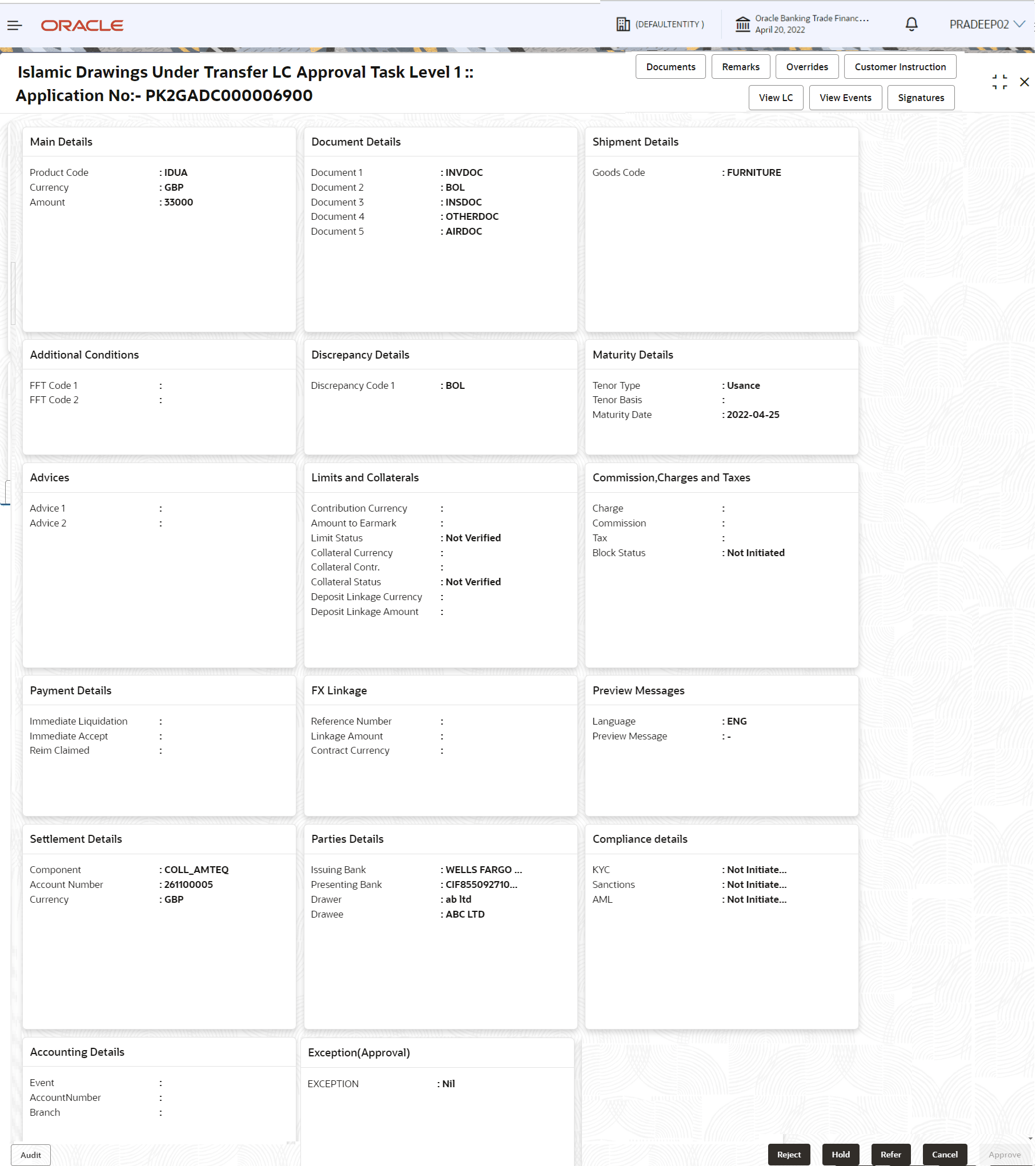

    Approval Summary
    Tiles Displayed in Summary:
    • Main Details - User can view details about application details and LC details.
    • Document Details - User can view document details.
    • Shipment Details - User can view shipment details.
    • Additional Conditions - User can view the details of additional conditions.
    • Discrepancy Details - System displays if Discrepancies exist or not and the number of discrepancies on the face of the tile. On drill down, user can see all the discrepancies listed under the LC drawing.
    • Maturity Details - User can view the maturity details in case of Usance and Multi tenor drawings.
    • Advices - User can view the advice details.
    • Limits and Collaterals - User can view limits and collateral details.
    • Commission Charges and Taxes - User can view charge details.
    • Payment Details - User can view payment details.
    • FX Linkage - User can view the FX linkage details.
    • Preview Messages - User can preview the draft message generated if any.
    • Settlement Details - User can view settlement details.
    • Parties Details - User can view party details like applicant, advising bank etc.
    • Compliance Details - User can view compliance details. The status must be verified for KYC and to be initiated for AML and Sanction Checks.
    • Accounting Details - User can view the accounting entries generated in back office.
      When the Value Date is different from the Transaction Date for one or more accounting entries, system displays an Alert Message “Value Date is different from Transaction Date for one or more Accounting entries.
    • Exception(Approval) - User can view the Exception(Approval) details.
