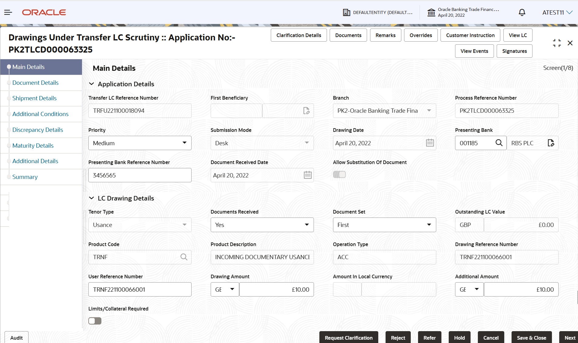

- On Scrutiny - Main Details screen, specify the fields
that were not entered at Registration stage.
The fields which are marked in asterisk are mandatory.Figure 2-6 Scrutiny - Main Details
Description of the illustration scrutinymainapplication.pngTable 2-4 Scrutiny - Main Details - Field Description
Field Description Transfer LC Reference Number Read only field. System displays the LC Reference Number to be transferred as selected in the Registration stage.
First Beneficiary Read only field. System displays the First Beneficiary details.
Branch Read only field. System displays the branch details.
Process Reference Number Read only field. Unique sequence number for the transaction.
This is auto generated by the system based on process name and branch code.
Priority System will populate the priority of the customer based on priority maintenance. If priority is not maintained for the customer, system will populate 'Medium' as the default priority. User can change the priority populated.
Submission Mode Read only field. System displays the selected submission mode.
Drawing Date Read only field. System displays the branch’s current date.
Presenting Bank System displays the Presenting Bank name and address as per presenting bank ID selected. The usser can change the presneting bank.
Presenting Bank Reference Number Specify the presenting bank reference number. Document Received Date Read only field. System displays the branch’s current date.
Allow Substitution Of Document Read only field. If enabled, allows the bank to substitute the Export Documents received from Transferee with the documents from Beneficiary during Drawing.

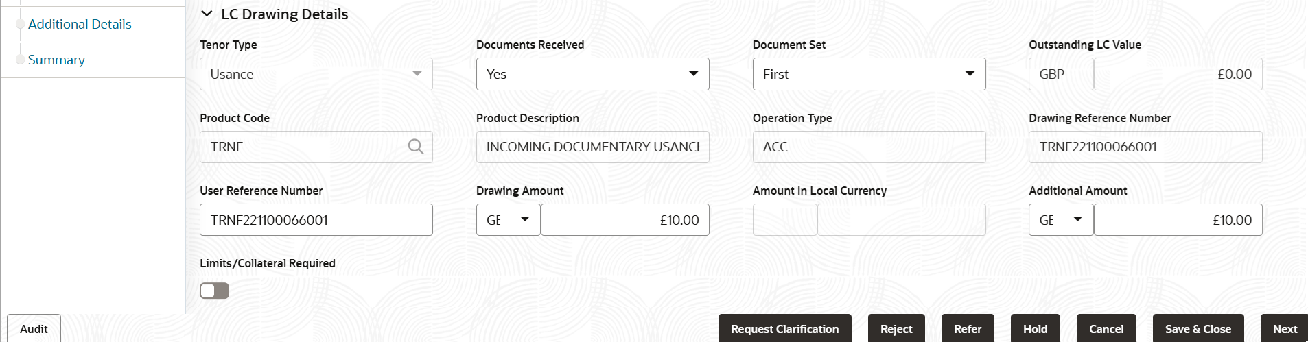

LC Drawing DetailsThe fields listed under this section are same as the fields listed under the LC Drawing Details section in Registration stage. During Registration, if user has not captured input, then user can capture the details in this section.
Figure 2-7 LC Drawing Details
Description of the illustration scrutinymainlcdetails.pngProvide the details for the fields based on the description in the following table:
Table 2-5 LC Drawing Details
Field Description Tenor Type Select the tenor type. - Sight
- Usance
- Multi Tenor
Documents Received Select the document received status from the drop-down. - Yes
- No
Documents Set Select the number of sets of documents received from the drop-down. - First
- Second
- Both
Duplicate If documents received are duplicate and if the drawing is already completed, user can mark this as duplicate and submit. Outstanding LC Value Read only field. This field displays the value as per the latest LC details.
Product Code Select the product code for the drawing. Only the products that are allowed for Bills under Transfer LC should be displayed in the look up list.
Product Description Read only field. This field displays the description of the product as per the product code.
Operation Type Read only field. The operation type can be:
- ACC
- DIS
- undefined
Drawing Reference Number This is auto generated by the back end system. User Reference Number User reference number is defaulted based on the selected LC. User can change the value.
Drawing Amount Outstanding LC Amount as per the latest LC details is displayed. User can change the value.
Amount In Local Currency Read only field. System fetches the local currency equivalent value for the LC amount from back office (with decimal places).
Additional Amount This field can have value only if an MT 750 has been processed for this drawing earlier. Limits/ Collateral Required Enable the option, if limit check is applicable. Disable the option, if limit check is not applicable.

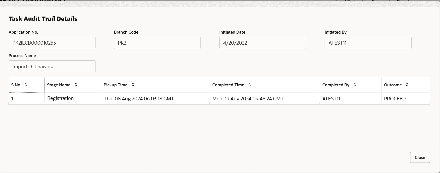

Audit
Description of the illustration audit.pngThis button provides information about user initiated the transaction, initiated date, stage wise detail etc.
For more information on action buttons, refer to the field description table below.Table 2-6 Audit - Field Description
Field Description Application No. This field displays the appliation number of the process. Branch Code This field displays the branch code. Initiated Date This field displays the date on which process is initiated. Initiated By This field displays the user ID of the user who had initiated the process. Process Name This field displays the name of the process which is initiated. S. No This field displays the serial number of the audit record. Stage Name This field displays the current stage of the process. Completed Time This field displays the time on which the audit of the current stage is completed. Completed By This field displays the user ID of the user who had completed the audit. Outcome This field displays the outcome of the audit. - Click Next.The task will move to next data segment.
Table 2-7 Main Details - Action Buttons - Field Description
Field Description Clarification Details Clicking the button opens a detailed screen, user can see the clarification details in the window and the status will be Clarification Requested. Documents Click to View/Upload the required document. Application displays the mandatory and optional documents.
The user can view and input/view application details simultaneously.
When a user clicks on the uploaded document, Document window get opened and on clicking the view icon of the uploaded document, Application screen should get split into two. The one side of the document allows to view and on the other side allows to input/view the details in the applicationRemarks Specify any additional information regarding the drawing under transferred LC. This information can be viewed by other users processing the request. Content from Remarks field should be handed off to Remarks field in Backend application.
