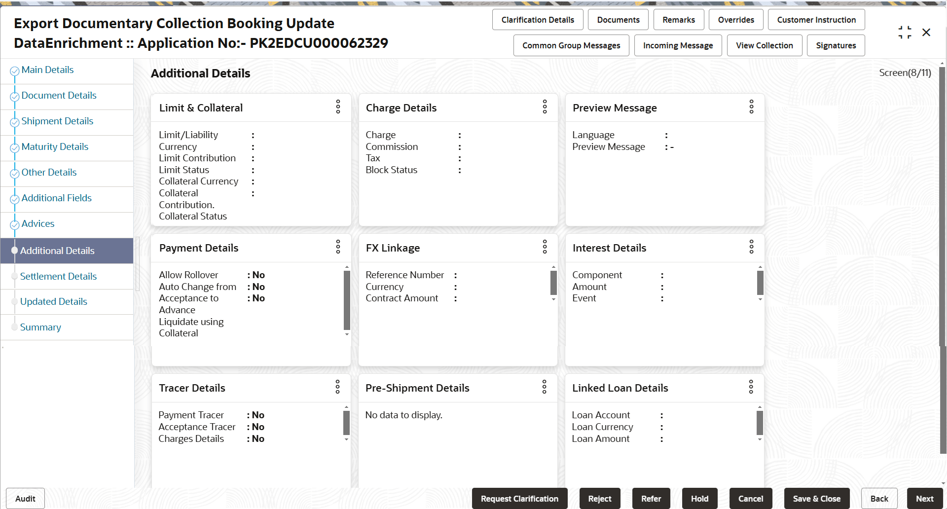

3.3.6 Additional Details
This topic provides the systematic instructions to capture the additional details
  1. On Additional Details screen, click View on any Additional Details tile to view the details.

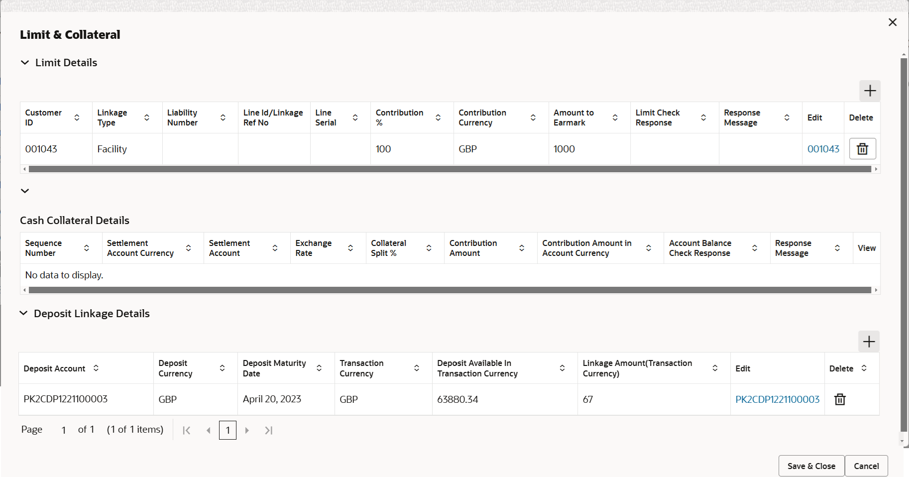

    Limits and Collaterals
    Limit availability needs to be checked if amendment involves increase in amount or tolerance or both.
    On Approval, system should not release the Earmarking against each limit line and system should handoff the “Limit Earmark Reference Number “to the back office. On successful handoff, back office will make use of these “Limit Earmark Reference Number” to release the Limit Earmark done in the mid office (OBTFPM) and should Earmark the limit from the Back office.
    In case multiple Lines are applicable, Limit Earmark Reference for all lines to be passed to the back office.
    Description of delimitdetails.png follows
    Figure 3-15 Collateral Details
    Collateral availability needs to be checked if amendment involves increase in amount or tolerance.
    Description of Figure 3-15 follows
    Description of "Figure 3-15 Collateral Details"
    For more information on fields, refer to the field description table below.
    Table 3-16 Limit Details - Field Description
    Field Description
    Plus Icon
    Click + plus icon to add new limit details.
    Below fields are displayed on the Limit Details pop-up screen, if the user clicks plus icon.
    Customer ID This field displays the applicant’s/applicant bank customer ID defaulted from the application.
    Linkage Type Select the linkage type.
    Linkage type can be:
    • Facility
    • Liability
    By default Linkage Type should be Facility.
    Contribution % System will default this to 100%. User can modify, if contribution is more than 100%. System will display an alert message, if modified.
    Once contribution % is provided, system will default the amount.
    System to validate that if Limit Contribution% plus Collateral% is equal to 100. If the total percentage is not equal to 100 application will display an alert message.
    The collateral % maintained for the customer is defaulted into the Collateral Details screen. If collateral % is not maintained for the customer, then system should default the collateral % maintained for the product. User can modify the defaulted collateral percentage, in which case system should display a override message “Defaulted Collateral Percentage modified.
    Liability Number Click Search to search and select the Liability Number from the look-up.
    The list has all the Liabilities mapped to the customer.
    Contribution Currency This field displays the contribution currency.
    Line ID/Linkage Ref No Click Search to search and select from the various lines available and mapped under the customer id gets listed in the drop-down.
    LINE ID-DESCRIPTION will be available for selection along with Line ID. When you click on 'verify', the system will return value if the limit check was successful or Limit not Available. If limit check fails, the outstanding limit after the transaction value will be shown in the limit outstanding amount.
    The user can click the Line Id link to view the limit details.
    User can also select expired Line ID from the lookup and on clicking the verify button, system should default “The Earmarking cannot be performed as the Line ID is Expired” in the “Response Message” field.
    This field is disabled and read only, if Linkage Type is Liability.
    Limit/Liability Currency This field displays the limit currency, when the user select the Liability Number.
    Limits Description This field displays the limits description.
    Limit Check Response This field displays the limit check response.
    Response can be ‘Success’ or ‘Limit not Available’ based on the limit service call response.
    The value in this field appears, if you click the Verify button.
    Contribution Amount This field defaults the contribution amount.
    Contribution amount will default based on the contribution %.
    User can change the value.
    Expiry Date This field displays the date up to which the Line is valid.
    Limit Available Amount This field displays the value of available limit, i.e., limit available without any earmark. The Limit Available Amount must be greater than the Contribution Amount.
    Response Message This field displays the detailed response message.
    ELCM Reference Number This field displays the ELCM reference number.
    Below fields appear in the Limit Details grid along with the above fields.
    Line Serial Displays the serial of the various lines available and mapped under the customer id.
    This field appears on the Limits grid.
    Edit Click the link to edit the Limit Details.
    Delete Icon Click delete icon to delete the existing limit details.
    Cash Collateral Details
    Collateral availability needs to be checked if amendment involves increase in amount or tolerance. Provide the collateral details based on the description provided in the following table:
    Below fields are displayed on the Collateral Details pop-up screen, if the user clicks plus icon.
    Click plus icon to add new collateral details.
    Total Collateral Amount Read only field.
    This field displays the total collateral amount provided by the user.
    Collateral Amount to be Collected Read only field.
    This field displays the collateral amount yet to be collected as part of the collateral split.
    Sequence Number Read only field.
    The sequence number is auto populated with the value, generated by the system.
    Collateral Split %
    Specify the collateral split% to be collected against the selected settlement account.
    Collateral Contribution Amount Specify the collateral amount to be collected against the selected settlement account.
    User can either provide the collateral % where the collateral amount will be auto populated or modifying the collateral amount will auto correct the collateral %.
    Settlement Account Click Search to search and select the settlement account for the collateral.
    Settlement Account Currency Read only field.
    This field displays the settlement account currency defaulted by the system.
    Exchange Rate Read only field.
    This field displays the exchange rate, if the settlement account currency is different from the collateral currency.
    Contribution Amount in Account Currency Read only field.
    This field displays the contribution amount in the settlement account currency as defaulted by the system.
    Account Available Amount Read only field.
    This field displays the account available amount which will be auto-populated on clicking the Verify button.
    Response Read only field.
    System populates the response on clicking the Verify button.
    Response Message Read only field.
    System populates the response message on clicking the Verify button.
    Verify Click to verify the account balance of the Settlement Account.
    Save & Close Click to to save and close the record.
    Cancel Click to cancel the entry.
    Cash Collateral Details grid Below fields appear in the Cash Collateral Details grid along with the above fields.
    Collateral % Specify the percentage of collateral to be linked to this transaction. If the value is more than 100% system will display an alert message.
    Contribution Amount This field displays the collateral contribution amount.
    Account Balance Check Response Read only field.
    System populates the Account Balance Check Response on clicking the Verify button.
    Edit Click edit link to edit the collateral details.
    Delete Icon Click delete icon to delete the existing collateral details.
    Deposit Linkage Details Click plus icon to add new deposit linkage details.
    Below fields are displayed on the Deposit Linkage Details pop-up screen, if the user clicks plus icon.
    Customer ID
    User can change the customer ID.
    Deposit Account Click Search to search and select deposit for linkage from the list of all the customer Deposits.
    Deposit Branch This field displays the deposit branch which is auto-populated based on the deposit account selection.
    Deposit Available Amount This field displays the deposit available amount and currency which will be auto-populated based on the deposit account selection.
    Deposit Maturity Date This field displays the maturity date of deposit.
    Exchange Rate This field displays the latest exchange rate for deposit linkage.
    This will be picked up from the exchange rate maintenance from the common core.
    Deposit Available In Transaction Currency This field displays the deposit amount available, after exchange rate conversion, if applicable.
    Linkage Percentage % Specify the value for linkage percentage.
    Linkage Amount (Transaction Currency) This field displays the transaction amount, user can change the value.
    Deposit Linkage Details grid Below fields appear in the Deposit Linkage Details grid along with the above fields.
    Deposit Currency Deposit currency will get defaulted in this field.
    Transaction Currency Transaction currency will get defaulted in this field from the underlying task.
    Delete icon Click delete icon to delete the existing deposit linkage details.

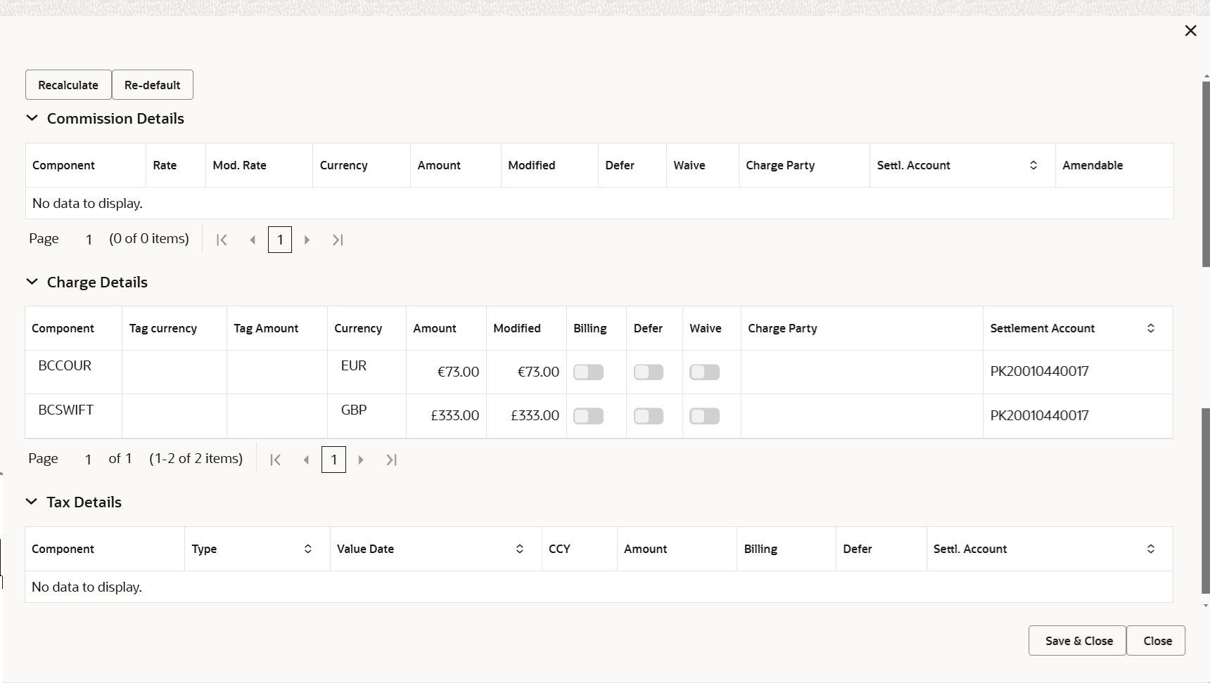

    Charge Details
    This section displays charge details.
    Description of dechargedetails.png follows
    Table 3-17 Charge Details - Field Description
    Field Description
    Commission Details
    Event Read only field.
    This field displays the event name.
    Event Description Read only field.
    This field displays the description of the event.
    Component This field displays the commission component.
    Rate This field displays the rate that is defaulted from product.
    The commission rate, if available in Back Office defaults in OBTFPMCS. The user is able to change the rate.
    If flat commission is applicable, then commission amount defaulted from back office is modifiable by the user. Rate field will be blank and the user cannot modify the Rate field.
    Modified Rate From the default value, if the rate is changed the value gets updated in this field.
    Currency This field displays the currency in which the commission have to be collected.
    Amount This field defaults the amount that is maintained under the product code.
    The commission rate, if available in Back Office defaults in OBTFPMCS. The user is able to change the rate, but not the commission amount directly. The amount gets modified based on the rate changed and the new amount is calculated in back office based on the new rate and is populated in OBTFPMCS.
    Modified Amount From the default value, if the amount is changed, the value gets updated in the modified amount field.
    Defer If enabled, charges/commissions has to be deferred and collected at any future step.
    On simulation of charges/commission from Back Office, if any of the Charges/Commission component for the customer is ‘Billing’ enabled, ‘Billing’ toggle for that component should be automatically checked in OBTFPMCS.
    The user can not select/de-select the check box if it is de-selected by default.
    Waive Based on the customer maintenance, the charges/commission can be marked for Billing or Defer.
    If the defaulted Commission is changed to defer or billing or waive, system must capture the user details and the modification details in the ‘Remarks’ place holder.
    Charge Party Charge party is 'Applicant' by default. User can change the value to Beneficiary.
    Settlement Account Select the settlement account.
    Amendable The value is auto-populated as the commission can be amended or not.
    Charge Details
    Component This field defaults the charge component type.
    Tag Currency This field defaults the tag currency in which the charges have to be collected.
    Tag Amount This field defaults the tag amount that is maintained under the product code.
    Currency This field defaults the currency in which the charges have to be collected.
    Modified From the default value, if the rate is changed or the amount is changed, the value gets updated in the modified amount field.
    Billing If charges are handled by separate billing engine, then by selecting billing the details to be available for billing engine for further processing.
    Defer If charges have to be deferred and collected at any future step, this check box has to be selected.
    On simulation of charges/commission from Back Office, if any of the Charges/Commission component for the customer is AR-AP tracking enabled, ‘Defer’ toggle for that component should be automatically checked in OBTFPMCS.
    The user can enable/disable the option the check box. On de-selection the user has to click on ‘Recalculate’ charges button for re-simulation.
    Waive Enble the toggle, if charges has to be waived.
    Based on the customer maintenance, the charges should be marked for Billing or for Defer.
    This field is disabled, if Defer toggle is enabled.
    Charge Party Charge party is applicant by default. User can change the value to beneficiary.
    Settlement Account Indicates the settlement account.
    Tax Details
    The tax component is calculated based on the commission and defaults if maintained at product level. User cannot update tax details and any change in tax amount on account of modification of charges/ commission will be available on click of Re-Calculate button or on hand off to back-end system.
    Component This field displays the tax component.
    Type This field displays the type of tax component.
    Value Date This field displays the value date of tax component.
    Currency This field displays the currency in which the tax have to be collected.
    The tax currency is the same as the commission.
    Amount This field displays the tax amount based on the percentage of commission maintained.
    Billing If taxes are handled by separate billing engine, then by selecting billing the details to be available for billing engine for further processing.
    Defer If taxes have to be deferred and collected at any future step, this option has to be enabled.
    Settlement Account System defaults the settlement account.
    The user can modify the settlement account.
  2. Click Save and Close to save the details and close the screen.

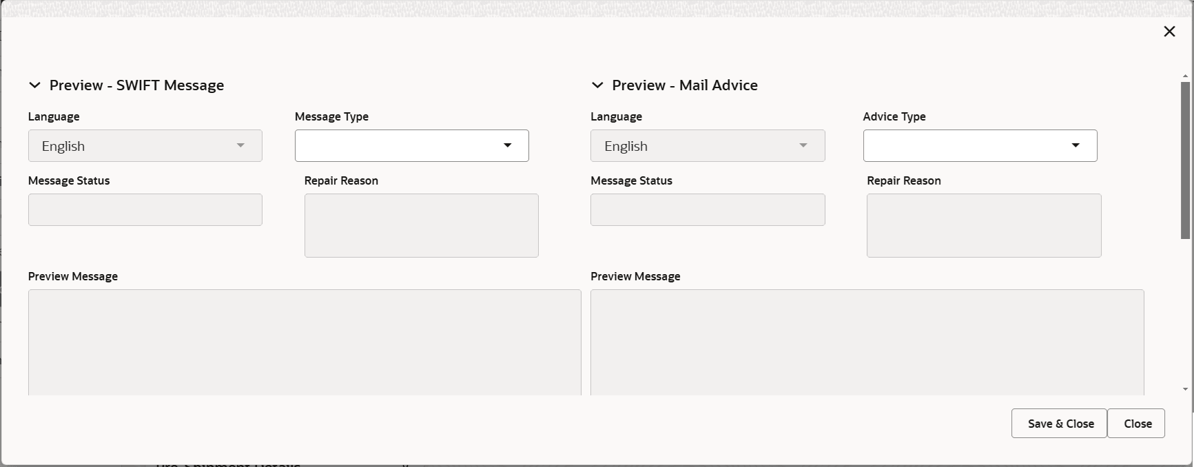

    Preview Message
    The bank user can view a preview of the outgoing SWIFT message and advise simulated from back office.
    Description of deadditionaldetailspreview.png follows
    Table 3-18 Preview - Field Description
    Field Description
    Preview SWIFT Message
    Language Select the language for the SWIFT message.
    Message Type Select the message type.
    Message Status Read only field.
    Display the message status of draft message of liquidation details.
    Repair Reason Read only field.
    Display the message repair reason of draft message of liquidation details.
    Preview Message This field displays a preview of the draft message.
    Preview Mail Device
    Language Select the language for the advice message.
    Advice Type Select the advice type.

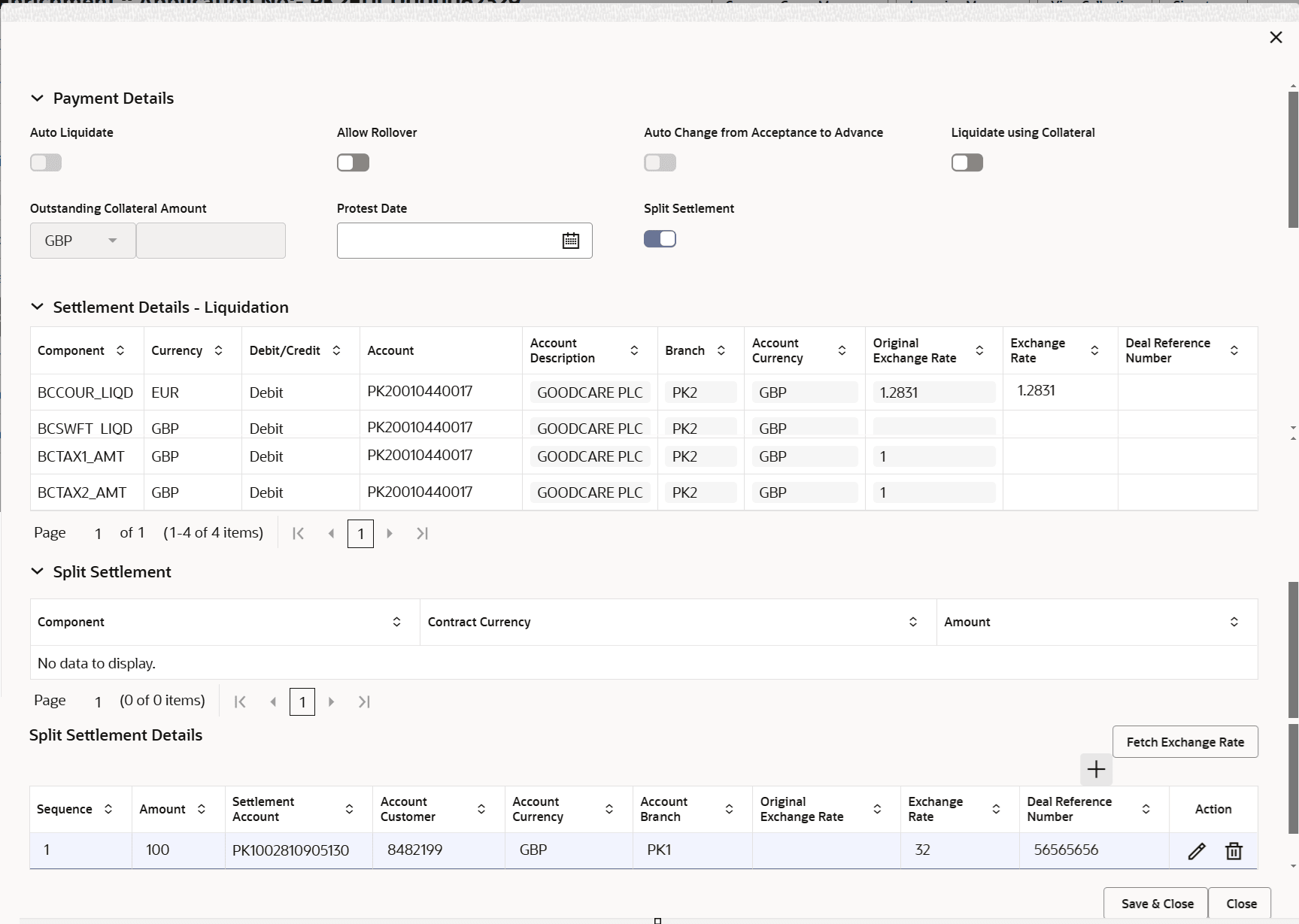

    Payment Details
    Description of depaymentdetails.png follows
    Table 3-19 Payment Details - Field Description
    Field Description
    Payment Details
    Auto Liquidate Enable the option as ‘On’ if the auto liquidation is required.
    Disable the option as ‘Off’ if the auto liquidation is not required.
    Auto Liquidation enables liquidation of the bill on the due date automatically from the back office system.
    Allow Rollover Enable the option to allow rollover.
    Auto Change from Acceptance to Advance Read only field.
    This flag indicates whether an Acceptance type of bill should be automatically converted into an Advance type of bill on its liquidation date.
    This option is applicable only for the bills that are co-accepted by the bank.
    Liquidate using Collateral Read only field.
    Outstanding Collateral Amount Read only field.
    Protest Date Select the protest date.
    Split Settlement Enable the option as ‘On’ to select more than one account for settlement (Split Settlement) for the liquidation of an import or export drawing or collection bill.
    Disable the option as ‘Off’ Disables the user to select more than one account for settlement (Split Settlement) for the liquidation of an import or export drawing or collection bill.
    Avalization Enable the option as ‘On’ for availization.
    Settlement Details - Liquidation
    Component This field displays the component based on the product selected.
    Currency This field displays the default currency for the component.
    Debit/Credit This field displays the debit/credit indicators for the components.
    Account This field displays the account details for the components.
    Account Description This field displays the description of the selected account.
    Branch This field displays the branch of the selected account.
    Account Currency This field displays the currency for all the items based on the account number.
    Original Exchange Rate System displays the Original Exchange Rate as simulated in settlement details section from OBTF.
    Exchange Rate The exchange rate for the settlement.
    Deal Reference Number The exchange deal reference number.
    Split Settlement
    Amount This field displays the amount for each component. This is populated from the transaction details of the drawing.
    Split Settlement Details
    The user can click + to add multiple Split Settlement Details.
    Sequence Indicates the sequence of the settlement details.
    Amount Specify the amount for the split settlement.
    Settlement Account Click Search to search and select the settlement account.
    Account Customer This field displays customer account based on the selected settlement account.
    Account Currency This field displays currency of the account.
    Account Branch This field displays branch of the customer’s account
    Exchange Rate Click the Fetch Exchange Rate button, the field displays the exchange rate for the split settlement.
    Action Click Edit icon to edit the Split Settlement.
    Click Delete icon to delete the Split Settlement.
  4. Click Save and Close to save the details and close the screen.

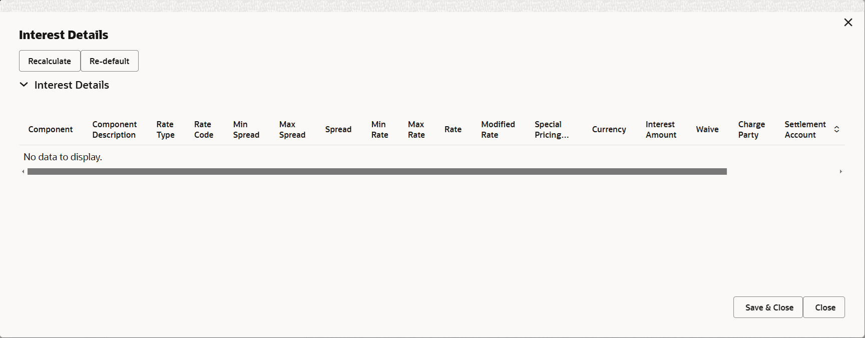

    Interest Details
    The user can view and modify the Interest Details Simulated from Back Office system. On update of the Interest rate user has to click on Recalculate button. System will trigger a simulation call to the back office and the updated Interest details will be reflected in this section.Description of intrestdetails.png follows
    Table 3-21 Interest Details - Field Description
    Field Description
    Component This field displays the component maintained in the back office.
    Component Description This field displays the description of the component.
    Rate Type This field displays the rate type maintained for the component in back office.
    • Fixed Floating
    • Special
    Rate Code This field displays the rate code applicable for the component.
    Min Spread This field displays the minimum spread applicable for the Rate Code.
    This field have value, if the Rate Type is Floating.
    Max Spread This field displays the maximum spread applicable for the Rate Code.
    Spread This field displays the spread applicable for the Component in case of Floating Rate Component. User can change the defaulted value.
    System validates whether the spread input is within the Minimum to Maximum Spread.
    Min Rate This field displays the minimum rate applicable for the Rate Code.
    Max Rate This field displays the maximum rate applicable for the Rate Code.
    Rate This field displays the value applicable for the Rate Code.
    You can modify the value, if the Rate Type is Fixed. System validates whether the Rate input is between the Minimum and Maximum Rate.
    Modified Rate This field displays the modified rate.
    Special Pricing Reference Number Specify the Special Pricing Reference Number, when there is a special Interest rate to be provided for that customer against the interest component (Main Component).
    Special Pricing Reference is not applicable for Penal Interest components.
    For transactions initiated from OBDX, the Special Pricing Reference Number will be populated from OBDX and user cannot edit the same.
    System displays an override as “Special Pricing Applicable”, on clicking “Save” in the Interest Details screen, if Special Pricing Reference number has been provided.
    Currency This field displays the interest currency.
    Amount Specify the interest amount, if the Rate Type is Special.
    In other cases , the amount will be calculated by back office immediately only if the Interest is collected in Advance or if Back Dated Interest is collected. In that scenario, the Amount will be populated on Re-simulation from back office. Otherwise Interest will be calculated only in the batch as maintained.
    Waive User can waive the Interest applicable. System displays an override, if the user has waived the Interest.
    Charge Party This field displays the Charge Party based on the type of transaction.
    In case of Export Transactions, Drawer should be the defaulted Charge Party for Collection Bills and Beneficiary for the LC Bills. In case of Import Transactions, Drawee should be the Charge Party for Collection and Applicant for the LC Bills.
    Settlement Account This field displays the settlement account of the Charge Party for debit of Interest. User can change the value. System displays an error if a different customer is chosen. If different account of the Charge Party is selected, system should display a override.
    In case the user modifies the Interest Rate, the user should click on Recalculate button to get the modified amount from the back office and display the new Amount.(Recalculation is done in back office and not in OBTFPM).
    Settlement Curreny System defaults the currency of the Settlement Account as maintained for the Charge Party.
    Settlement Branch System defaults the branch of the Settlement Account as maintained for the Charge Party.
  6. Click Save and Close to save the details and close the screen.

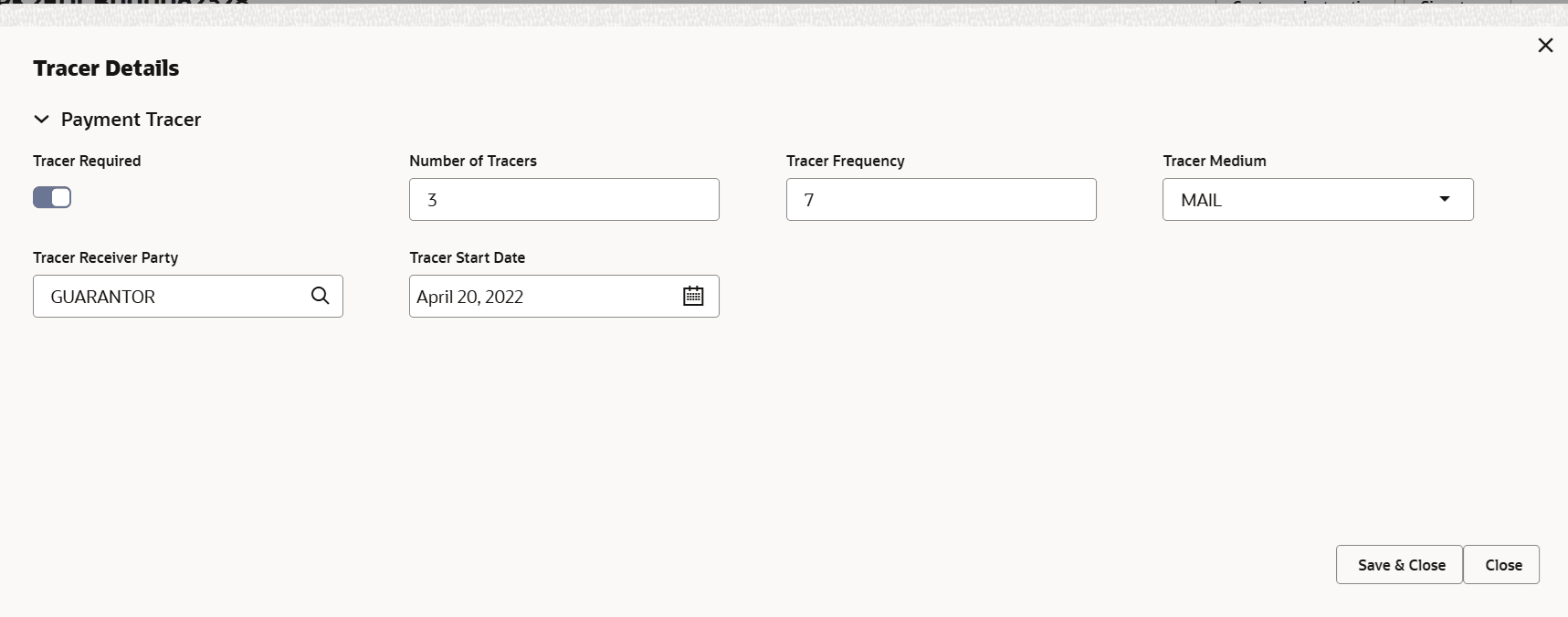

    Tracer Details
    This section enables the user to view the default Tracer details from back end application. It also allows the user to add new Tracer details. Add new Tracer details based on the description in the following table:
    Acknowledgement Tracer, Acceptance Tracer and Payment Tracer are applicable for this process.Description of detracerdetails.png follows
    Table 3-22 Tracer Details - Field Description
    Field Description
    Tracer Required Select if tracer is required or not.
    • Toggle On: Required
    • Toggle Off: Not required.
    Number of Tracers Specify the number of tracers required.
    Tracer Frequency Select the frequency for generation of the Tracer.
    • Daily
    • Weekly
    • Fortnightly
    Tracer Medium Select the tracer medium from the drop-down list.
    • MAIL
    • EMAIL
    • SWIFT
    Tracer Receiver Party Click Search to search and select the tracer receiver party.
    Tracer Start Date Select the tracer start date. Start date cannot be earlier than the branch date.
    Acceptance Tracer
    • Daily
    • Weekly
    • Fortnightly
    • MAIL
    • EMAIL
    • SWIFT
    Template ID Click Search to search and select the template ID.
    This field is enabled if Tracer Medium has value as SWIFT.
  7. Click Save and Close to save the details and close the screen.

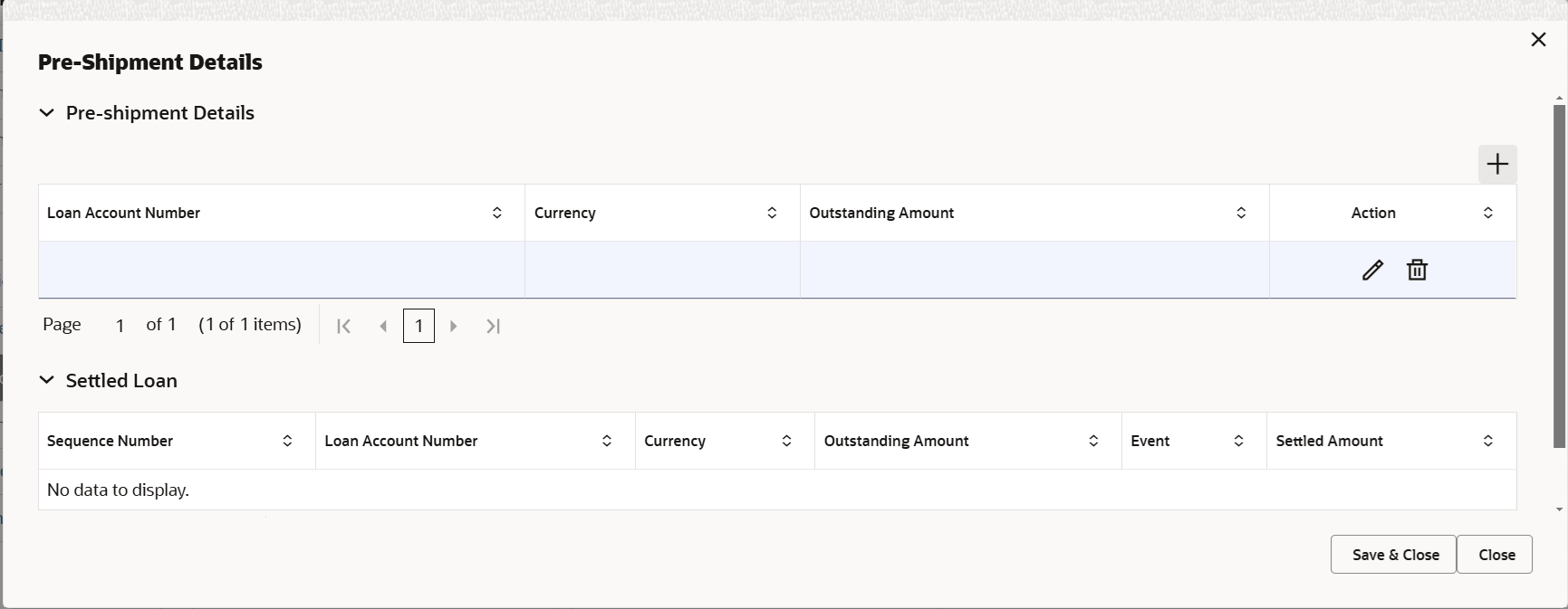

    Pre-Shipment Details
    This section links an existing Preshipment Credit. Liquidation of pre-shipment credit is applicable only is the operation type is PUR or DIS.
    Description of depreshipmentdetails.png follows
    Table 3-23 Pre-Shipment Details - Field Description
    Field Description
    Pre Shipment Details
    The user can click + to add multiple Pre Shipment Details.
    Loan Account Number Specify the loan account number or click Search to search and select the loan account number from the look-up.
    If there are any pre-shipment credits available for the selected pre-shipment credit number, application will display a message, prompting the user that there are earlier pre-shipment credit/s availablecand whether he wants to continue or not.
    Application defaults the currency based on the selected pre-shipment credit number.
    Outstanding Amount Read only field.
    Application defaults the outstanding amount based on the selected pre-shipment credit number.
    Action Click Edit icon to edit the pre-shipment details.
    Click Delete icon to delete the pre-shipment details.
    Setteled Loan
    Sequence Number This field displays the sequence of the settled loan.
    Loan Account Number This field displays the pre-shipment loan account number.
    Currency This field displays the currency of the pre-shipment loan account number.
    Outstanding Amount This field displays the pre-shipment outstanding amount.
    Event This field displays the event.
    Setteled Amount This field displays the settled amount.
  8. Click Save and Close to save the details and close the screen.

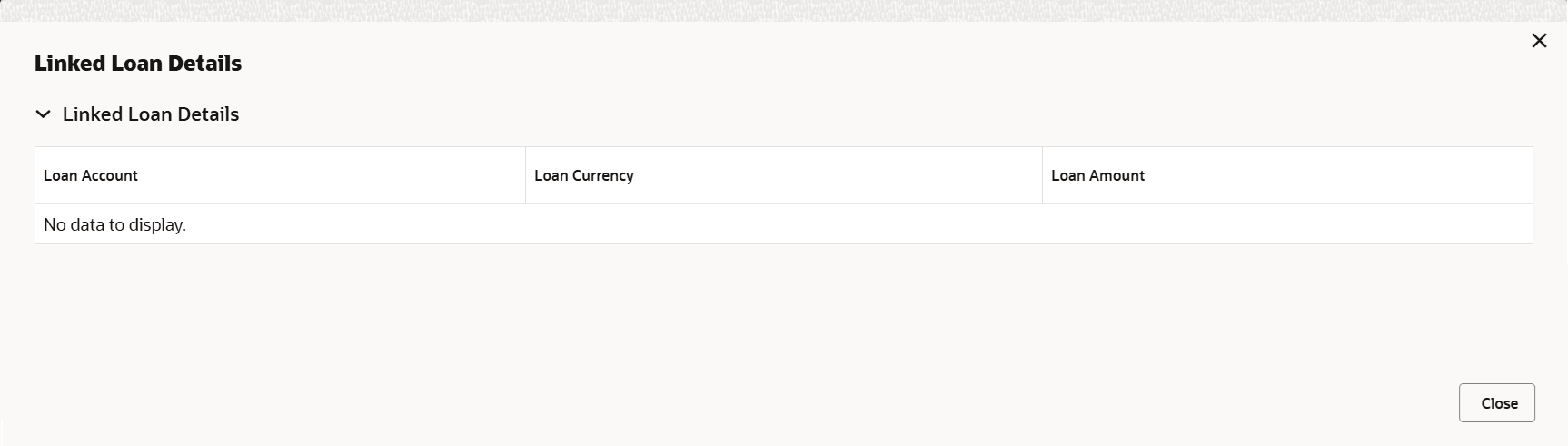

    Linked Loan Details
    This user can view the details of linked loan accounts.
    Table 3-24 Linked Loan Details
    Field Description
    Loan Account Displays the details of the linked loan account.
    Loan Currency Displays the loan Currency of the linked loan account.
    Loan Amount Displays the loan amount of the linked loan account.
  9. Click Save and Close to save the details and close the screen.

    For more information on action buttons, refer to the field description table below.
    Table 3-25 Additional Details - Action Buttons - Field Description
    Field Description
    Clarification Details Clicking the button opens a detailed screen, user can see the clarification details in the window and the status will be 'Clarification Requested'.
    Documents View/Upload the required document.
    Application displays the mandatory and optional documents.
    The user can view and input/view application details simultaneously.
    When a user clicks on the uploaded document, Document window get opened and on clicking the view icon of the uploaded document, Application screen should get split into two. The one side of the document allows to view and on the other side allows to input/view the details in the application
    Remarks Specify any additional information regarding the collection. This information can be viewed by other users processing the request.
    Content from Remarks field should be handed off to 'Remarks' field in backend application.
    Overrides Click to view the overrides accepted by the user.
    Customer Instruction Click to view/ input the following
    • Standard Instructions – In this section, the system will populate the details of Standard Instructions maintained for the customer. User will not be able to edit this.
    • Transaction Level Instructions – In this section, OBTFPMCS user can input any Customer Instructions received as part of transaction processing. This section will be enabled only for customer initiated transactions.
    Common Group Messages Click Common Group Message button, to send MT799 and MT999 messages from within the task.
    Incoming Message Clicking this button allows the user to see the message in case of STP of incoming MT 767.
    View Collection Enables the user to view the latest collection values displayed in the respective fields.
    Signatures Click the Signature button to verify the signature of the customer/ bank if required.
    The user can view the Customer Number and Name of the signatory, Signature image and the applicable operation instructions if any available in the back-office system.
    If more than one signature is required, system should display all the signatures.
    Request Clarification Click the Request Clarification button to submit the request for clarification to the “Trade Finance Portal” User for the transactions initiated offline.
    Reject On click of Reject, user must select a Reject Reason from a list displayed by the system.
    Reject Codes are:
    • R1- Documents missing
    • R2- Signature Missing
    • R3- Input Error
    • R4- Insufficient Balance/Limits
    • R5 - Others
    Select a Reject code and give a Reject description.
    This reject reason will be available in the remarks window throughout the process.
    Refer Select a Refer Reason from the values displayed by the system.
    Refer Codes are:
    • R3- Input Error
    • R5 - Others
    Hold The details provided will be saved and status will be on hold. User must update the remarks on the reason for holding the task.
    This option is used, if there are any pending information yet to be received from applicant.
    Cancel Cancel the Data Enrichment stage inputs. The details updated in this stage are not saved. The task will be available in 'My Task' queue.
    Save & Close Save the details provided and holds the task in ‘My Task’ queue for further update. This option will not submit the request.
    Back Click the Back button, to go back to the previous screen.
    Next On click of Next, system validates if all the mandatory fields have been captured. Necessary error and override messages to be displayed. On successful validation, system moves the task to the next data segment.
