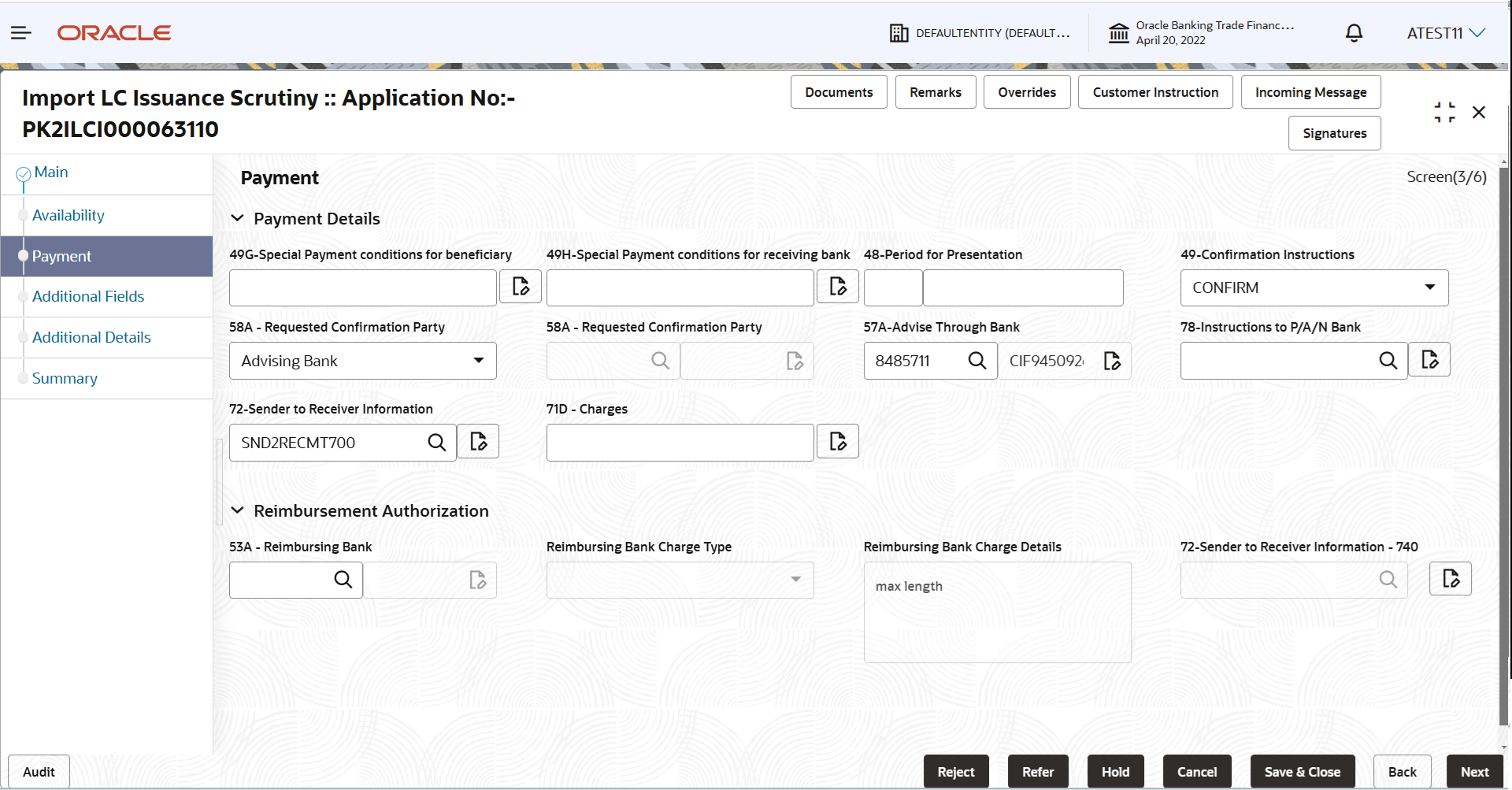

2.4.3 Payment
This topic provides the systematic instructions to initiate the Payment in Scrutiny stage of import LC issuance request.
  1. On Scrutiny - Payment screen, specify the fields.
    Figure 2-11 Scrutiny - Payment
    Description of Figure 2-11 follows
    Description of "Figure 2-11 Scrutiny - Payment "
    For more information on fields, refer to the field description table below.
    Table 2-14 Payment - Field Description
    Field Description
    Payment Details Specify the payment details.
    Special Payment conditions for beneficiary Specify the details of special payment condition to the beneficiary, if any, in case of online and non-online channels.
    Special Payment conditions for receiving bank Specify the details of special payment condition to receiving bank, if any, in case of online and non-online channels.
    This field specifies special payment conditions applicable to the receiving bank without disclosure to the beneficiary, for example, post-financing request/conditions for receiving bank only.
    Period for Presentation Specify the event name in text along with the number of days in number, if the period of presentation is based on any event other than shipment, in case of non-online channel.
    In case of Online channel, this field is read only.
    Confirmation Instructions Select the confirmation instruction for the LC from the list, in case of non-online channels. The options are:
    • CONFIRM
    • MAY ADD
    • WITHOUT
    Requested Confirmation Party Select the requested confirmation party from the drop-down list in case of online and non-online channels.
    This field is enabled and mandatory if the Confirmation Instructions is CONFIRM orMAY ADD.
    Requested Confirmation Party Click Search to search and select the appropriate requested confirmation party, in case of online and non-online channels.
    This field is enabled if the Confirmation Instructions is CONFIRM orMAY ADD and Requested Confirmation Party. is Others.
    Advise Through Bank Click Search to search and select the advise through bank, in case of Non - Online channel. Party type with banks must be displayed in look-up.
    Party type with banks will be displayed in look-up.
    • SWIFT code (if available)
    • Name and address of the bank
    On selection of the record if SWIFT code is available, then SWIFT code will be defaulted. If SWIFT code is not available then the bank's name and address to be defaulted.
    In case of Online channel, update the details received..
    Instructions to P/A/N Bank Click Search to search and select the instructions to P/A/N Bank, in case of Non - Online channel.
    Sender to Receiver Information Click Search to search and select thesender to receiver information, in case of Non - Online channel.
    Charges Specify the charges details(FFT), in case of non-online channel.
    Reimbursement Authorization Specify the reimbursement authorization details based on the following table.
    Reimbursing Bank If reimbursing bank is applicable user must update the field.
    Online Channel - Update the details received.
    Non Online Channel - Click Search icon and select the reimbursing bank, from the look-up. Party type with banks will be displayed in look-up.
    • SWIFT code (if available),
    1. In case the selected Bank is not RMA Compliant, the system prompts the user to use a different advising bank or use non SWIFT Media to transmit the LC and displays error message “RMA arrangement not available, please change the bank or use MAIL Medium”.
    2. If the party is blacklisted the system displays a warning message.
    Reimbursing Bank Charge Type Select the reimbursing bank charge type.
    The options are:
    • Claimants - Select this option, if the charges are to be claimed from Beneficiary
    • Ours - Select this option, if the charges are to be borne by Applicant
    This field should be enabled only if Reimbursing Bank field has value.
    Reimbursing Bank Charge Details Specify the additional details about reimbursing bank charges.
    Sender to Receiver Information-MT740 Click Search icon and select the FFT maintained for MT740 and change the description if required.
  2. Click Next.
    The task will move to next data segment.
