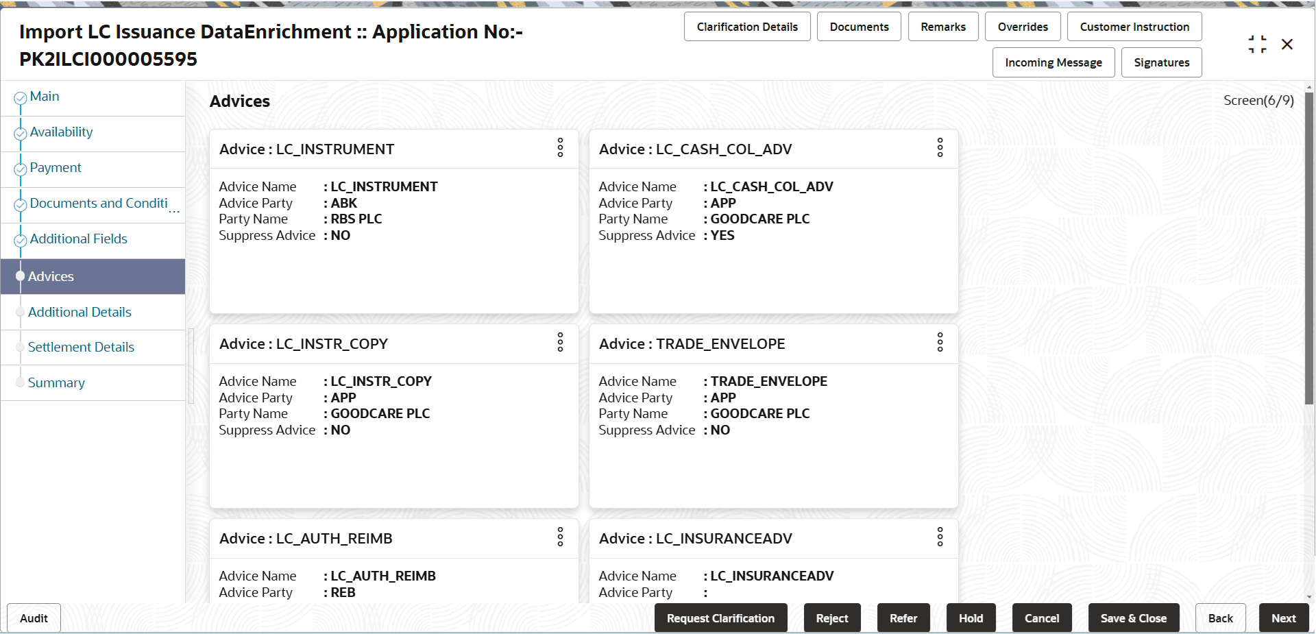

Advices menu displays the advices available under a product code from the back office as tiles. User can edit the fields in the tile, if required. User can suppress the advice, if required.
  1. On Advices screen, click the 3 dots on any advice tile to view the advice details.
    Advice Details
    For more information on fields, refer to the field description table below.
