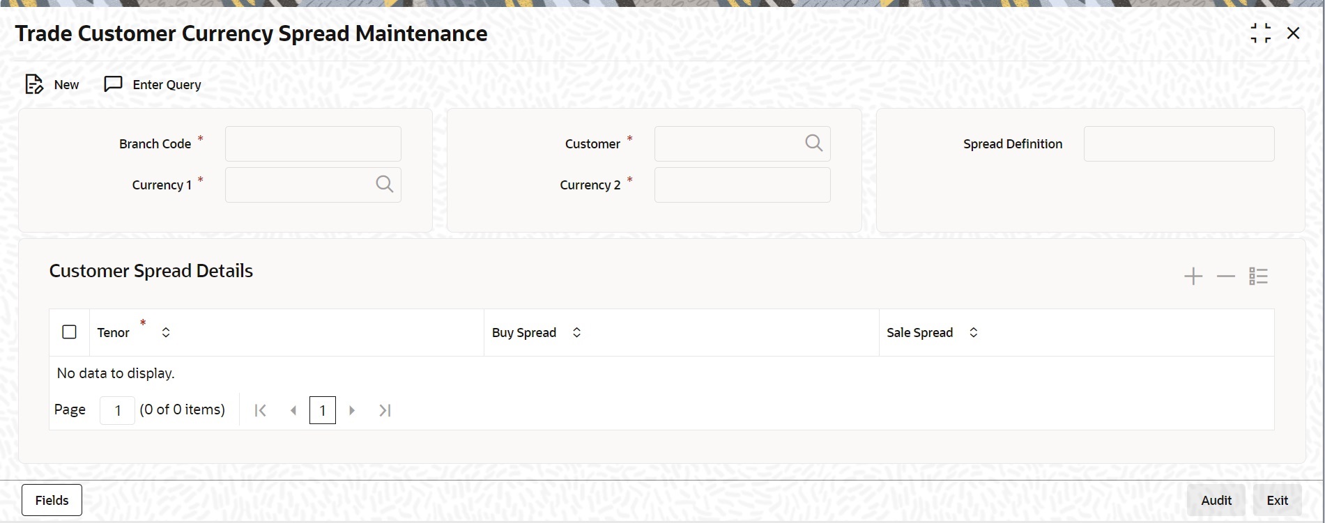

- On Homescreen, specify CYDTFCSP in the text box, and click next
arrow.Trade Customer Currency Spread Maintenance screen is displayed.
Figure 1-11 Trade Customer Currency Spread Maintenance
Description of "Figure 1-11 Trade Customer Currency Spread Maintenance" - On Trade Customer Currency Spread Maintenance screen,
specify the fields. In this screen, for a customer and currency pair, you can
maintain buy and sell spreads for different tenors. You need to maintain
customer spreads in each branch. Transactions initiated in a branch will pick up
the spread(s) maintained for that branch.
Funds Transfer, Loans and Deposit contracts have tenor = 0 (zero). Therefore, you need to maintain Customer Spreads for zero tenor also.The tenor is specified in daysTable 1-11 Trade Customer Currency Spread Maintenance - Field Description
Field Description Branch Code Specify the field Currency Code 1, 2 Specify the field. The field is mandatory Spread Definition Specify the field. Specify Spread Details When processing an FX deal involving a customer (for whom you have maintained spread details), the system picks up the customer spread corresponding to the tenor of the deal and builds it into the exchange rate. If spread details are unavailable for a specific tenor, the system picks up the spread defined for the nearest lower tenor. For example, assume for a customer and currency pair you maintain spread details for the following tenors: ‘3’, ‘5’, and ‘10’ days. When processing a deal with a tenor of ‘4’ days (involving the customer and the currency pair), the system picks up the spread details defined for a tenor of three days. This is because spread details for a ‘4’ day tenor is unavailable for the customer and currency pair. Note:
