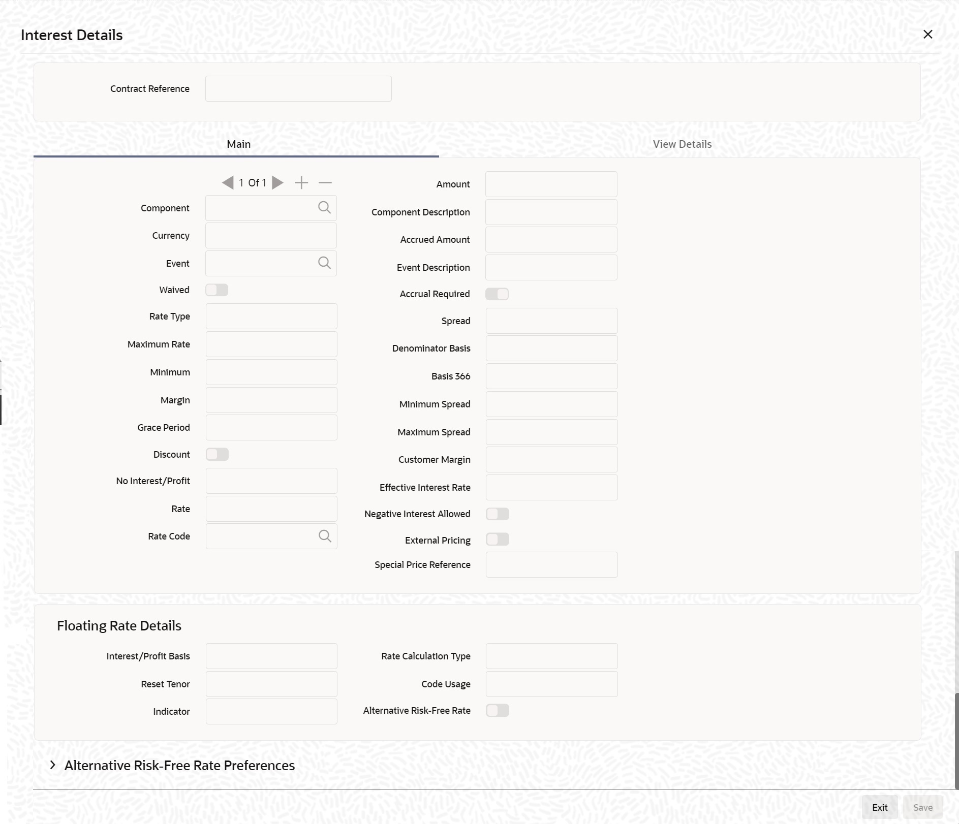

| Specifying Interest Details for a Contract | When the details of a contract are captured, the interest details defined for the
product involved will automatically be applied on the contract.
However, you can change certain attributes.
At the time of processing the contract, you can change the following attributes:
For a BC product, you may have chosen the ‘Consider as Discount’ option (specified through the ‘ICCB Details’ screen) and you may have specified the interest collection method to be advance (specified through the ‘Bills and Collections Product - Preferences’ screen). If you associate a BC contract to a product with the above specifications, you cannot change the ’Rate Code’ here.
It is possible to define more than one interest rule. You can have several interest rules, which you link to a product. The contract involving the product, in turn, will be linked to these interest rules.
For example, there can be one interest rule for the main interest (for example, 14%). You can have a tenor-based commission defined as an interest rule for the same product (for example, 3%). Both these will be applicable to the contract.
In the Contract ICCB Screen use the set of arrow buttons to go to the next or previous or the first or last rule that has been linked.
