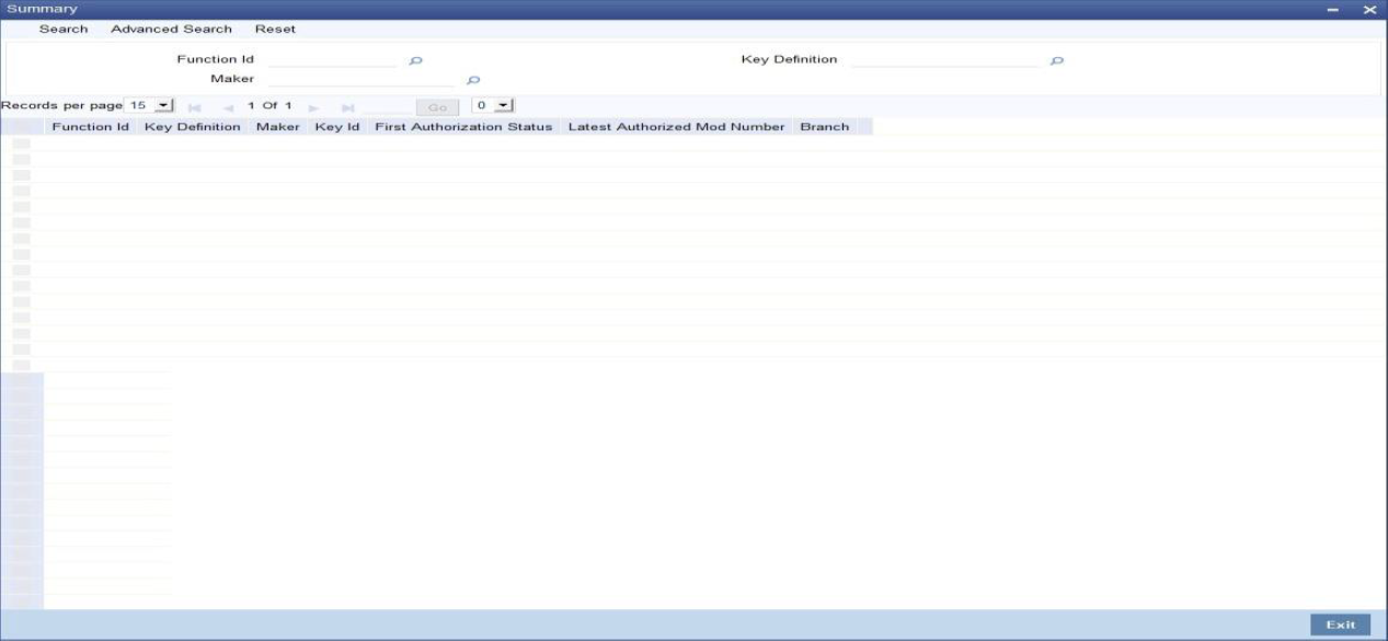

- on the Homepage, type CSSVERFY in the text box, and click the next arrow.The first level authorization is done using the ‘Verify’ screen.
In the ‘Verify’ screen you can query the modifications pending for verification (First Authorization) and do the first level authorization for selected modifications. Based on the search criteria entered system queries and displays all the records that meet the search criteria. - Double click on a particular record you can view the details of all the modifications pending for verification for that record in a separate screen (CSDVERFY).
All the modifications pending will be shown and you can select a modification and verify all the modifications till the selected modification number.
For examples if there are 3 modifications (Modification numbers 2, 3 and 4) pending for verification and if you select Modification number 3, system marks modification numbers 2 and 3 as ‘Verified’. Similarly if you select Modification number 4, modification number 2,3 and 4 will be marked as ‘Verified’.
