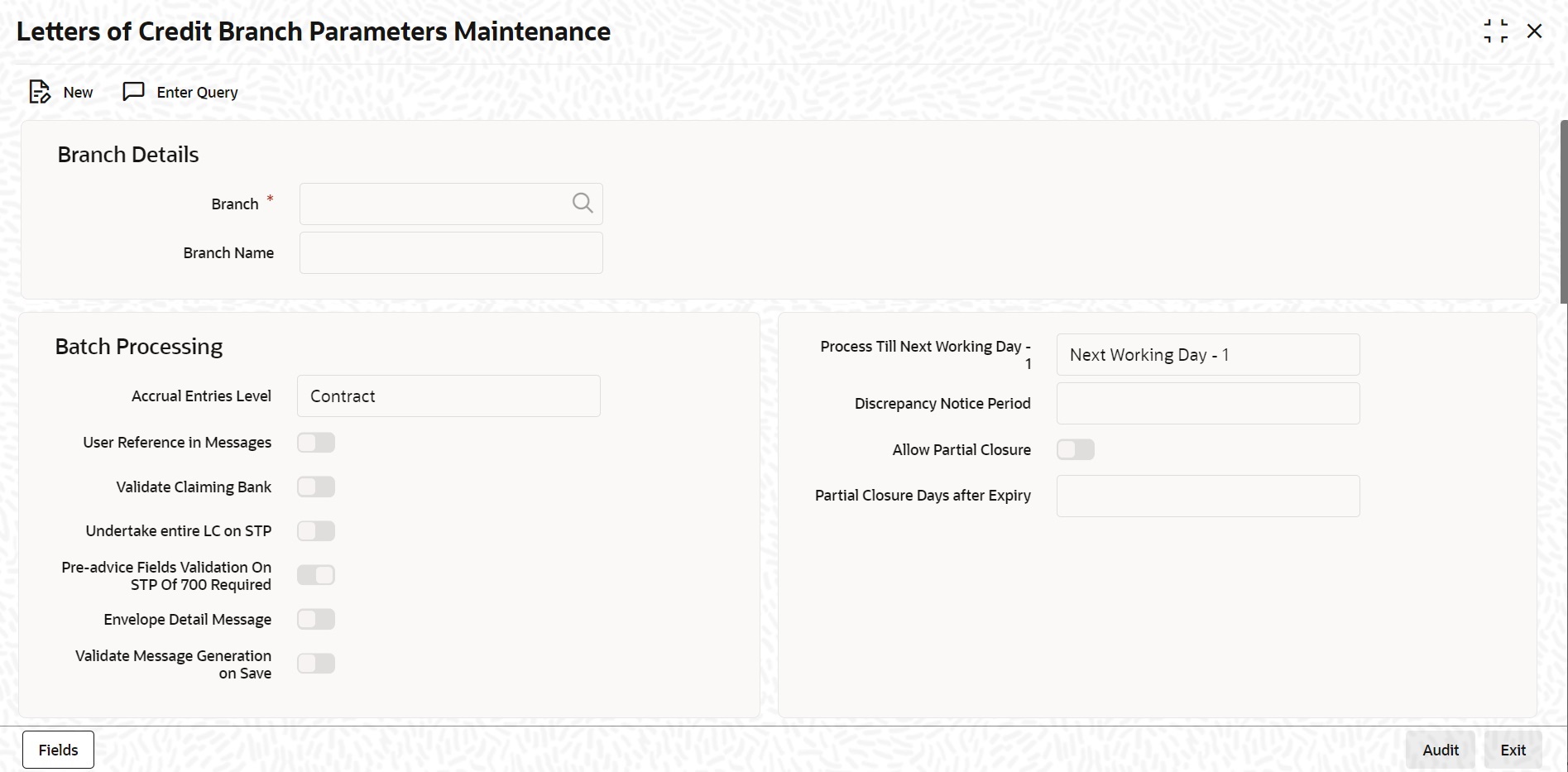

- On the homepage, type LCDBRPRM in the text box, and click next arrow.The Letters of Credit Branch Parameters Maintenance screen is displayed.
Figure 12-1 Letters of Credit Branch Parameters Maintenance
- On the Letters of Credit Branch Parameters Maintenance screen, specify the field details. The events, for which you had indicated automatic processing, are triggered off during the Batch Process.For more information on the fields, refer the Field Description table given below:
You can specify preferences for the automatic events that fall on a holiday, in the Branch Parameters screen. In addition, you can also specify the level at which accrual entries should be passed, for LCs in your branch.Table 12-1 LC Branch Parameters Maintenance - Field Description
